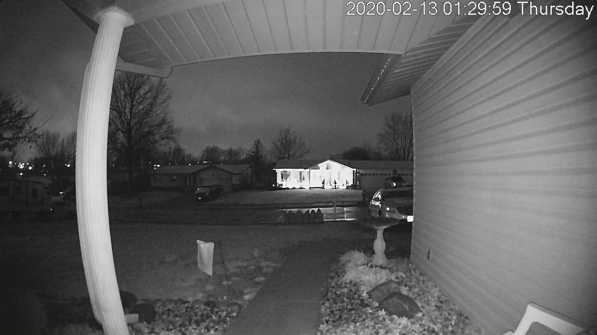

I probably should have provided more info about the actual issue. The big problem is that my neighbor across the street has his house lit up like a christmas tree.
Unfortunately I don't think there is going to be much I can do about his lights. It seems to do OK when I have my porch lights on (because it never activates night mode), but I was hoping to avoid having them on all night. Guess I may have to consider it though.

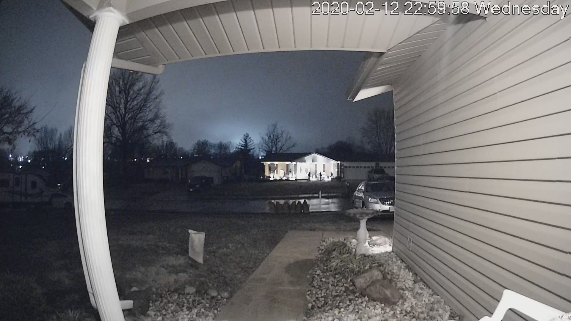

Here it is with porch lights on.
