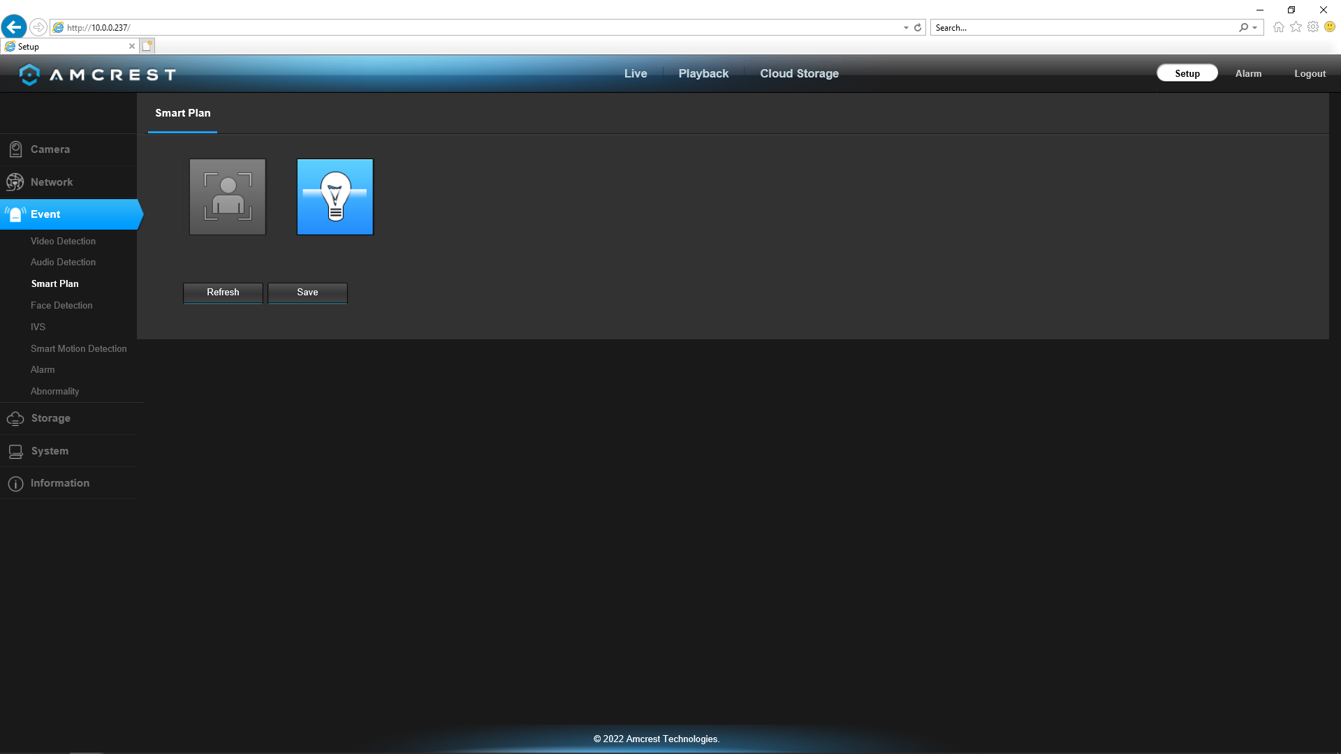

Awesome, So here is a couple of pictures of what a Camera needs to do to make sure that you are recording your IVS..
In the first picture you will need to under Event, go to Smart Plan and choose the light bulb for IVS

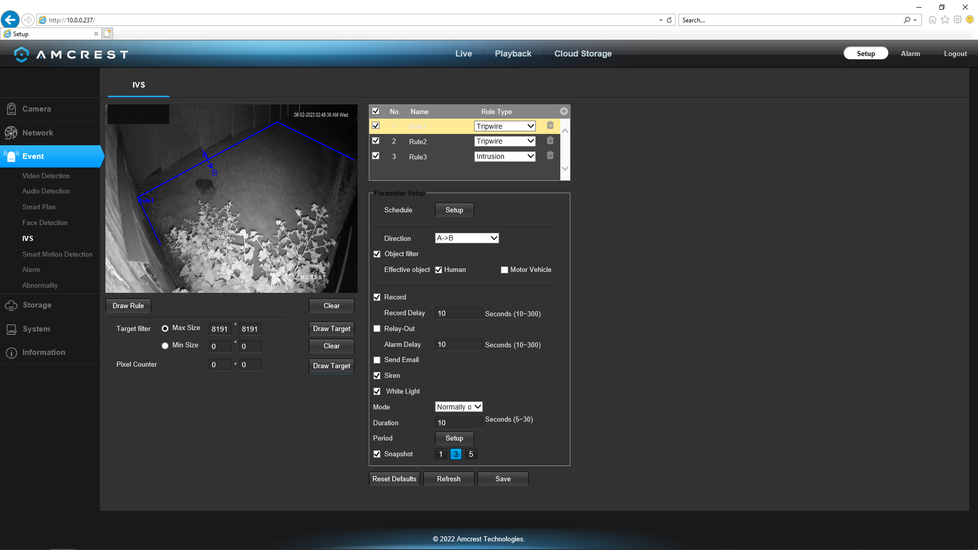

Then in the second picture this just shows 1 of the 3 rules and need to make sure they are setup to record for the event. If you only want snapshots then that works as well. Just keep in mind that my systems that I have setup for Snapshots and not recording is when I have them full time recording on my NVR or DVR already using the Lower 704x480 Sub Channel format. Also have them setup to record this way for full time Audio so I don't miss something that isn't in the event rules. For my AI Cameras I turn off Motion for the most part..
