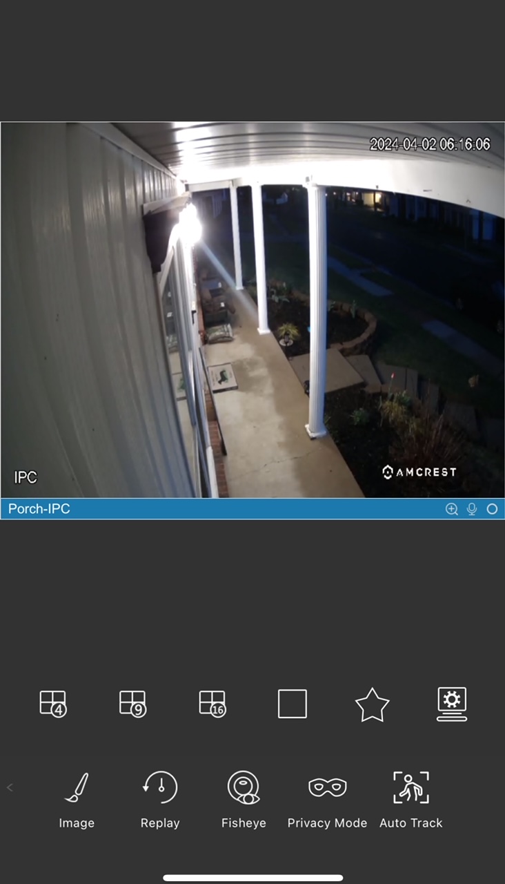

I have several Amcrest cameras. Yesterday, I installed a POE for my front porch. I added it successfully in the Amcrest ProView app. I am having issues connecting it to Blue Iris. (I have 5 other non POE cameras connected to Blue Iris so I am fairly familiar with it.) The POE is ethernet connected via an ATT WiFi extender. (I suspect this is the issue?) I added the correct IP but it just won't connect.
