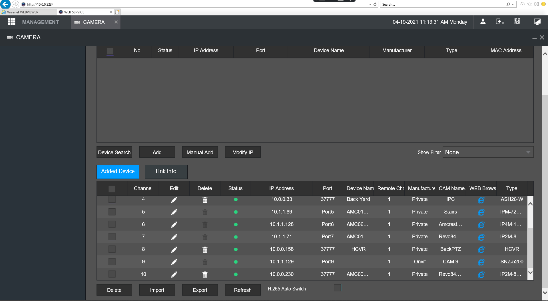

Re: AI camera porch led
So I am not sure if your working with your Camera on your Local Lan or if it is behind your NVR.. IF behind your NVR it is the same just getting to the camera is different..
So for me working with a 4216E-AI NVR, I log into NVR over IE, I then bring up the Cameras and on the lower list I click on the e Next to my 1046EW camera, This loads the NVR IP address with a PORT# and then my Camera can be logged into.. Once you log into your camera, Click on the setup on the top right side of the screen, then in the Camera Config there will be Day/Night click on that and you can change it from Auto to Color.. By the way even with it in B/W the white LEDS come on this camera has no IR LEDS..

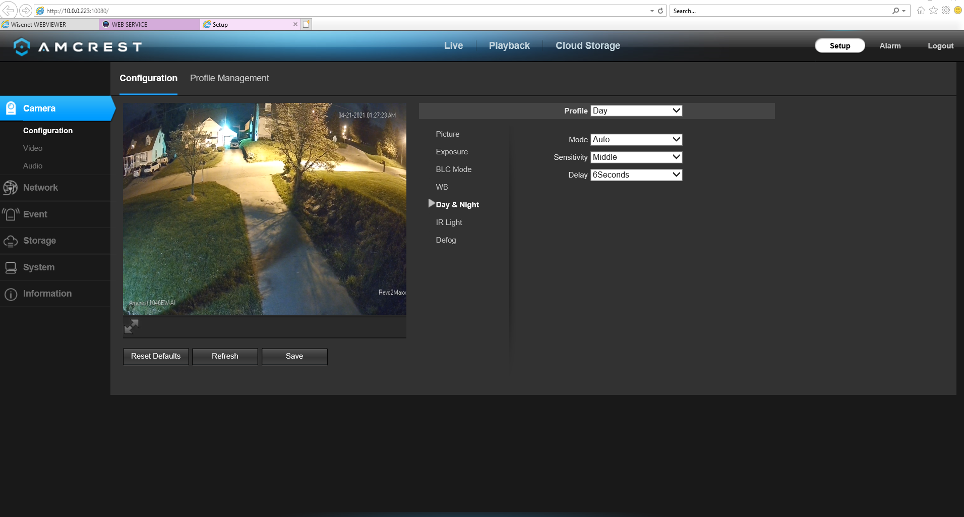

Thanks again for the reply. Oddly enough the camera menu does not have the option you posted. Under "Day & Night" I have mode, sensitivity, and delay, but they are grayed out under each profile and unalterable. I do not have a AI NVR.
A few nights later night color seems to have returned, so I am assuming it has to do with the auto function, but I wonder if some other setting is preventing me from changing that setting.
I much prefer working with these cameras via the API. Do you happen to know if there is updated API documentation since these cameras have been out which includes functions specific to the AI cameras?
And yes, I understand about the IR. I was just saying my other IR cameras really pick up dust and other debris in the air which sometimes trigger the detection, but with these cameras I have not had that issue. I mostly run them without the lights on though. With a bit of adjustment it is amazing the quality you can pickup without lights or IR, even in full darkness.

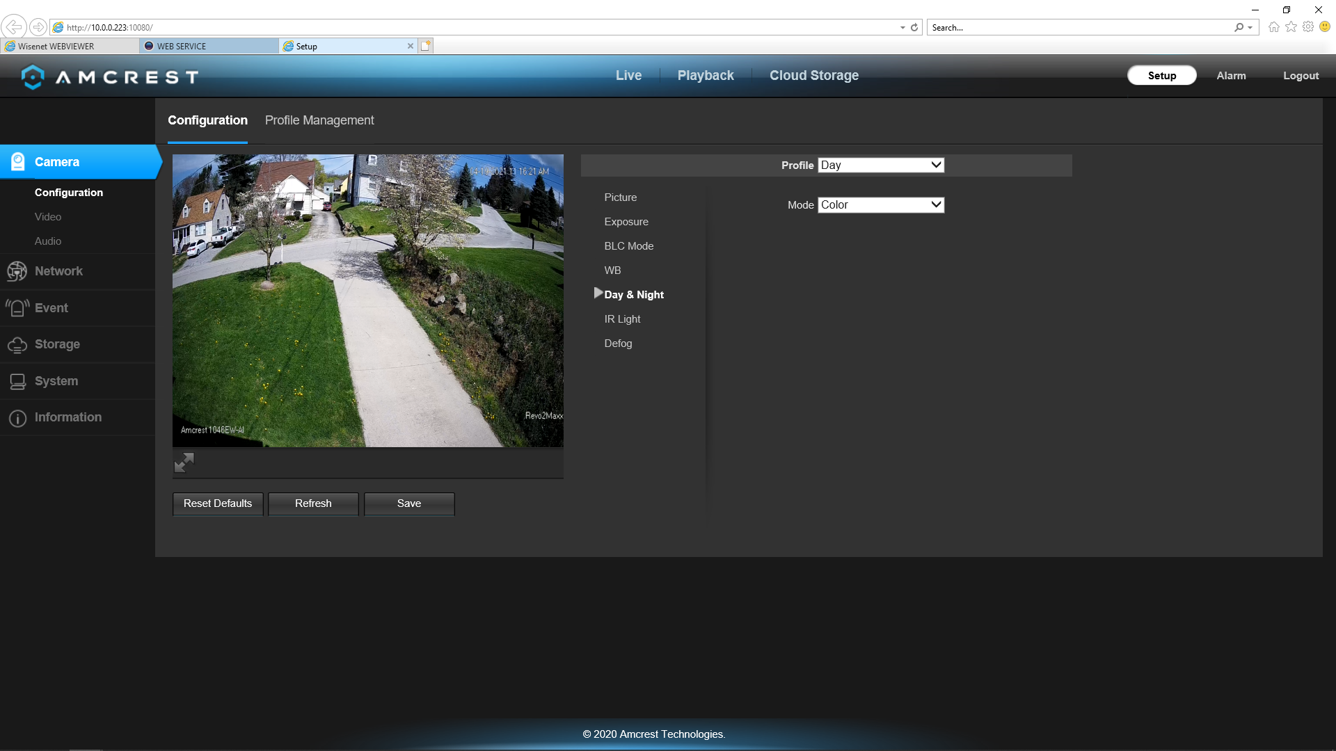

Yes your right when it is set to Auto that is what it will show. However as you can see in my Picture I have changed mine to Color.. If you leave it Auto it will change when needed by settings in the camera..
However if they are Greyed out that means there is another setting that you have changed that makes these non functional and then best thing if not sure what settings you changed to do that would be to Reset the Camera back to factory.. There is 2 options to do this Full Reset or reset keeping IP and Login..
