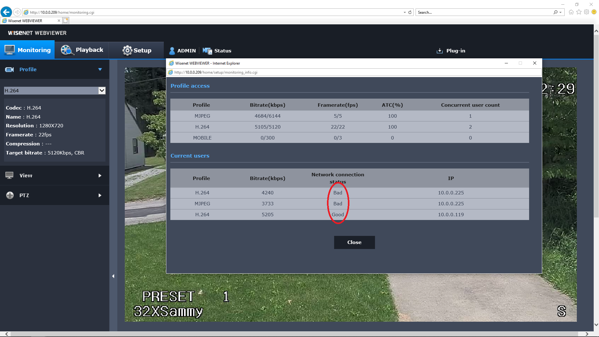

So I don't understand. Right now I am working with my 4116e-HS and I am running into some issues. So first I moved my Front 850eB and replaced it with my 32x older Samsung camera. Main issue is that I am getting a Bad Connection message between the NVR and the Camera however the connection between my Computer and the camera says it is ok..
Main issue is that the NVR don't like the camera on the POE ports. I have used the same Samsung camera on a longer run to my NVR's without issue in the past.
I have changed out cables from NVR to my Switch, I changed out the Cable from the 1 switch to my ports on my POE+ switch, I have even moved the NVR's cable from my Giga Switch to my POE+ Switch.
I have tried to lower the FPS, and Bit rate of the camera..
I have rebooted my NVR, Switches, Routers, cameras, I am starting to make up new Patch cables (even though my other ones are fairly new) What am I missing
