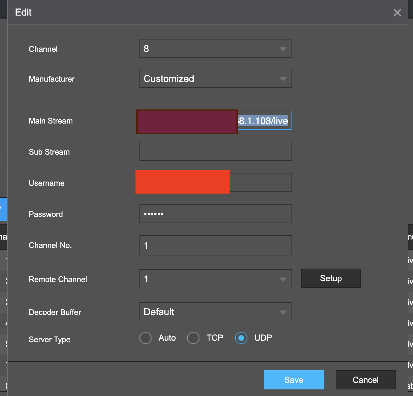

I was just able to figure this out . Here are the settings I used for wyze cam
1. Obviously flash the firmware on your Wyze to support rtsp streams
2. Settings on NVR
Manufacturer - Customized
Main Stream - Wyze stream URL
Server Type - UDP
Works great for me!
2. Settings on NVR
Server Type - UDP
Works great for me!

Re: Adding RTSP streams *to* the NVR for recording?
@xundre
can you please tell me what you used as RTSP Port and HTTP Port? I am following your lead but I cannot make it work. I dont even get a green connection light.
Thanks!
Thanks!
@alchemistsden
sorry for the late response , here are my settings if this helps.
