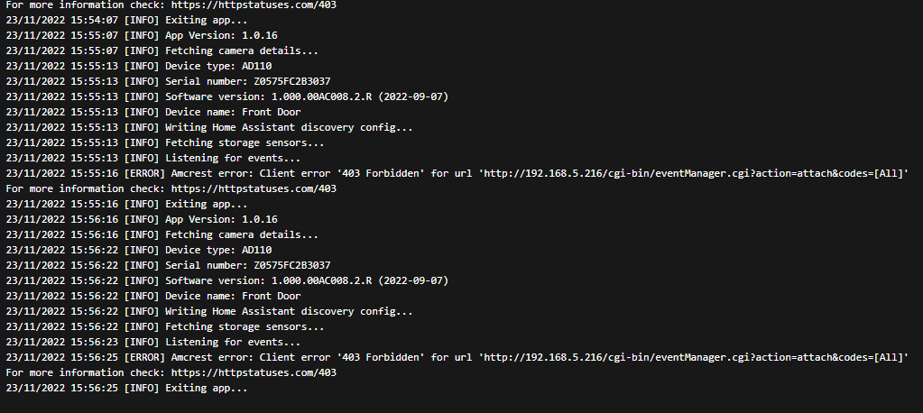

I've updated to the latest firmware and now received the following error.
23/11/2022 13:34:03 [INFO] Software version: 1.000.00AC008.2.R (2022-09-07)
23/11/2022 13:35:14 [INFO] Software version: 1.000.00AC008.2.R (2022-09-07)
23/11/2022 14:41:35 [INFO] Exiting app...
23/11/2022 15:57:34 [ERROR] Amcrest error: Client error '403 Forbidden' for url 'http://192.168.5.216/cgi-bin/eventManag ... codes=[All]'
I can load http://192.168.5.216/cgi-bin/configMana ... me=Network without an issue.
I've requested the previous firmware to downgrade via the amrest support channel.

Well, it's good news that the Amcrest HTTP API still seems to be working for at least obtaining the firmware configurations. The really bad news is that the ability to subscribe to real time events the doorbell issues is broken with this new firmware according to @tlundste and @Capture1766 reports.
This is the API command Home Assistant (and many others) rely on for detecting events for any Amcrest (or Dahua) camera:
This is now throwing a 403-Forbidden error as you can see from Capture1766's Home Assistant debug log. This is a critical error that warrants pulling the AD110 update immediately IMO - as well as ensuring the upcoming AD410 update doesn't have the same issue.
Code: Select all
/cgi-bin/eventManager.cgi?action=attach&codes=[All]
