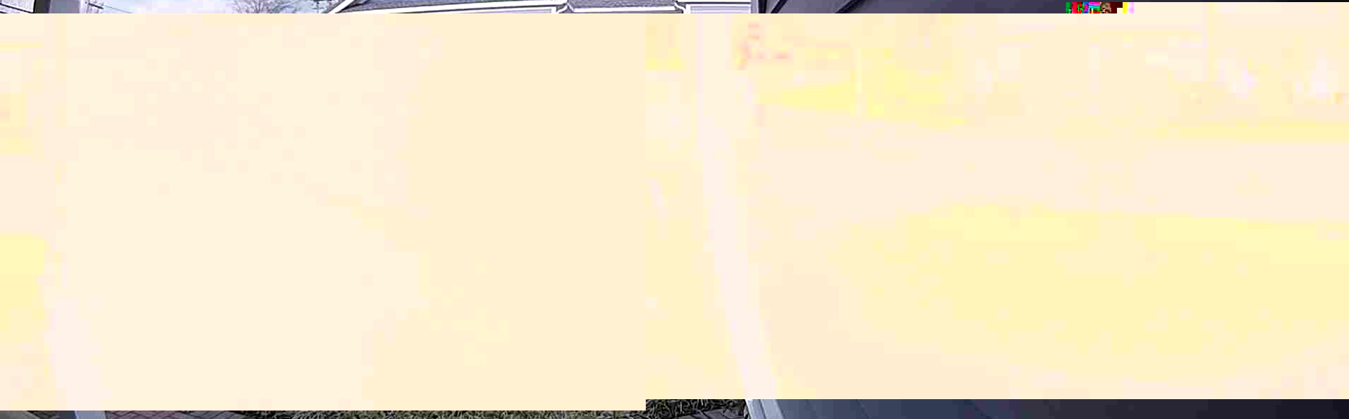

I learned that once I killed my RTSP stream of the HD feed for my AD110, the SD feed runs perfectly smoothly in my Amcrest app. The WiFi module (or the MCU) are heavily underpowered. Unfortunately though, the HD stream just 100% refuses to stream at all in the app. It instantly says that it failed and to refresh/retry.

It doesn't look like I can edit this post, but I'd like to add the following screenshot which shows a cropped, random artifacting in my HD stream (on top of the lag), seen here: https://imgur.com/a/NvoKIn1.

this is the picture i saw. to me it looks like a network issue. hope you have another router or ap to test.
from my own experience, the best connection i've seen for the ad110 is for it to connect directly to the main router. i have tested this using consumer home routers (linksys, netgear) and enterprise class ap (aruba, ubiquiti). having another network device between the ad110 and the main router could introduce lag, mesh systems included. the ad110 is also susceptible to interference due to neighboring wireless network because it's outside hence it really needs a solid connection to the main router and radio signal strength does not necessarily amount to a solid connection because of the distance. one cheap and effective solution i've tested with good results is using a dd-wrt wireless client bridge as long as the main router does not have a marvel cpu.

Yup, I've tested this on an Orbi and a separate, dedicated AP with no other devices on it (the AP was just a few feet away). It happened even when there were zero devices on the network. I tested that just to completely rule out the network piece being the issue. So at this point, it is a hardware/software issue with the device. Personally, from my experience with these sorts of devices, it looks like an underpowered MCU to me. Any other thoughts?amcrest168 wrote: ↑Tue Nov 24, 2020 10:37 am this is the picture i saw. to me it looks like a network issue. hope you have another router or ap to test.
