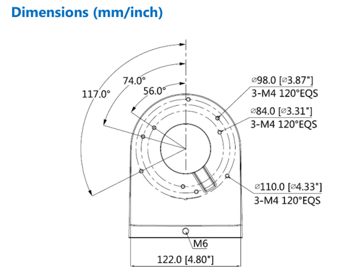

In terms of fitting existing junction boxes it's actually worse than that, the information from Amcrest for those two cameras is completely wrong. The web page for the AMCPFB203W, https://amcrest.com/amcrest-wall-mount- ... b203w.html says:
"Compatible with: [...] IP8M-VT2879EW-AI"
and the one for the IP8M-T2669EW-AI, https://amcrest.com/4k-poe-camera-turre ... ew-ai.html says:
"Compatible with the following Amcrest Junction Boxes: AMCPFB203W, [...]"
Neither of these is correct, here's the tech drawing for the AMCPFB203W:

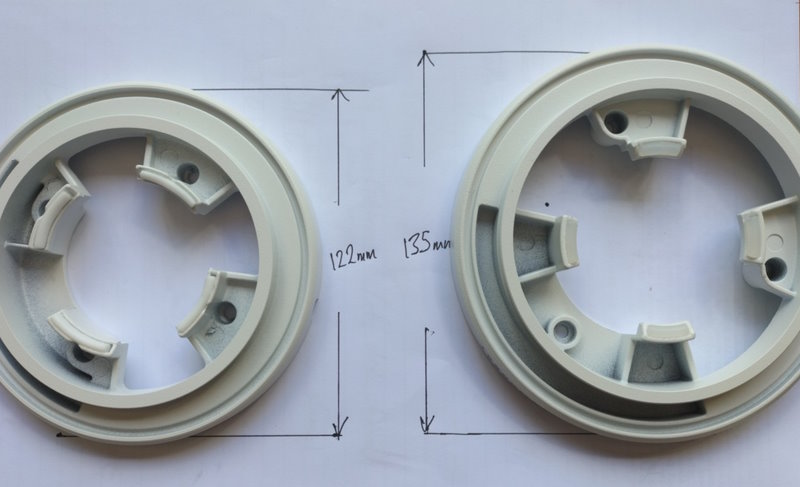

And here's the bases of the 2879 (right) and 2669 (left). The 2879 is the wrong size for the junction box and the 2669 has four screws in a square arrangement, not three screws in a triangle:

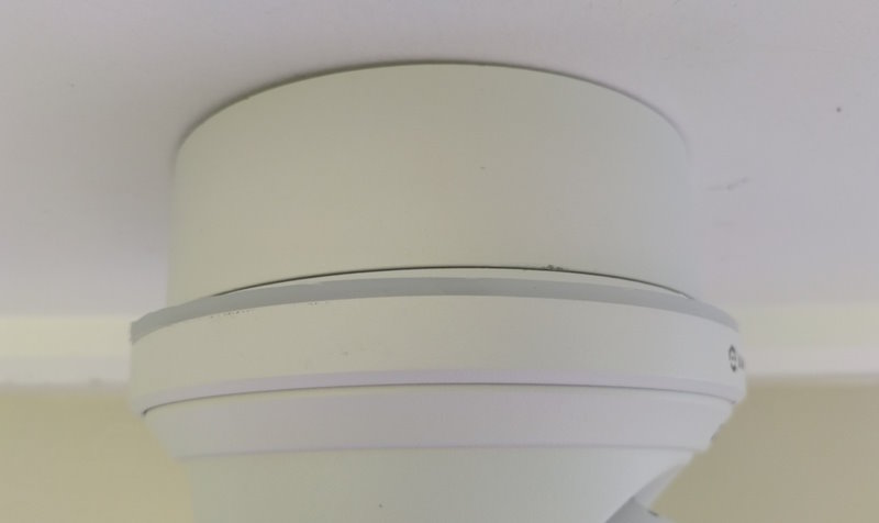

Finally sorted out how to mount these, since Amcrest don't have any junction box that fits the IP8M-2879E I used a standard 122mm one and cut a silicone gasket to take it out to the 135mm size required by the camera:
