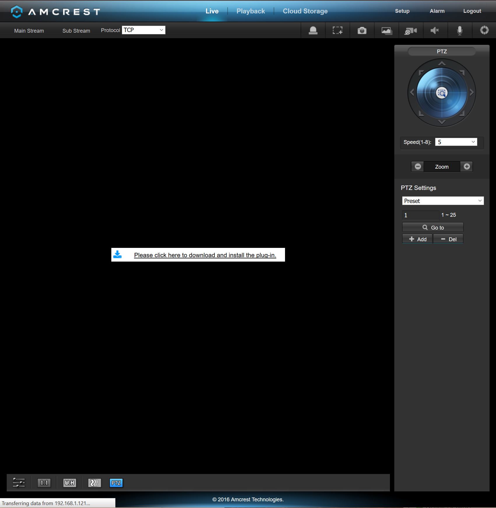

yup, the title says it all. "841B web interface keeps looking for plug-in that's already installed."
I log into the camera and I get, "Please click here to download and install the plug-in." so I download and install the plug-in, re-login to the camera, and again I get, "Please click here to download and install the plug-in."
then I thought maybe the firmware needed updating as the plug-in might be obsolete (just purchased the camera, so it had the original firmware installed). but after the update, I still have the same issue.
perhaps the braintrust here might have a solution?

You have to use internet explorer. i had the same issue.

In Chrome, type in the following in the address bar. You should see the plugin app and you can view camera there. Its kind of weird.
chrome://apps/
