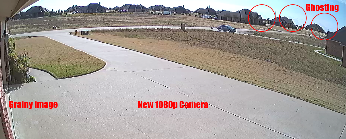

I recently updated my 720p HDCVI 4-channel DVR system with a 8-channel 1080p HDCVI DVR system.
720p cameras still work great, but the new 1080p picture is messy, unrefined & grainy. The houses in the distance look to be ghosted AND it's night vision keeps cycling on and off. I pulled the power plug from it.
Why is this happening? This is all Amcrest stuff. I bought the 1080 DVR so I could upgrade to 1080 cams.. but so far, no luck. This is the SECOND 1080 cam I've tried in the same spot, same results. I thought the first one was faulty.

Here is what I'm referring too. Please see attached shot taken from the new 1080, and the crystal clear shot from my 720 cam.

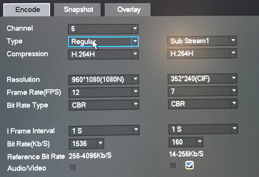

This may not be your solution but... I use IP2M camera series and when I updated the firmware it reset the high resolution setting to 640x480. I just had to change it back to a higher resolution.

Thank you Markcm for your reply. Unfortunately, I tried this and it says it's 960*1080(1080N). I DID notice, when the camera is first plugged in, it's size is much more square then the other cameras who start is a horizontal rectangle.
I'll attach what it says it's default settings are.... thank you for any help!!!!!!!

Wonderful. Their customer service logged into my system and could not resolve the issues. She basically told me the DVR their Amcrest sales rep sold me in September is NOT compatible with the Amcrest 1080p cameras. HUH!?!?!?!
She reduced the camera to 960 and I still have the same horrible results. Let's hope their online support comes through to resolve this.

I figured it out, the DVR they sold me, the AMDVTENL8 1080P, that says it's a 1080 DVR right in it's name, actually does NOT work with 1080p cameras...
