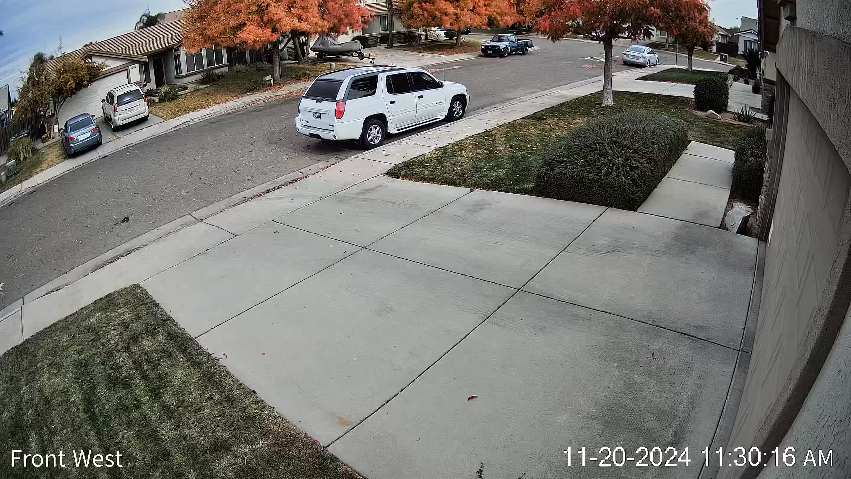

I have one complaint, my 5MP cameras don't give me a clear enough image to make out license plates. Even that of my own vehicle parked in front of the house.
Q: Would a similar 8MP camera provide a clear enough image to make out the license plates of cars driving by?
My DVR is supposed to support recording up to 2160 and it does have 3 open camera ports.

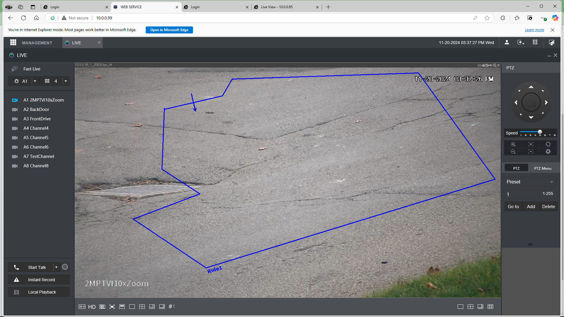

Here's an image from the camera I would replace. (and move to another location)
NVR_Front West_main_20241120113016_@2.jpg (2.65 MiB) Viewed 10126 times

To be honest I don't think a shift from a 2.8mm to a 4mm is going to be enough. To be honest the position of the area of interest isn't placed well.
Few different things. First the 2 camera have almost the same sensor size. Yet the 5mp camera has a better F-Stop so that means the 5mp will have been night ability. Next with the 2 cameras with almost same sensor size the 8mp has little worse F-Stop it will have or may have noise at night and image of video or pictures won't be as clear.

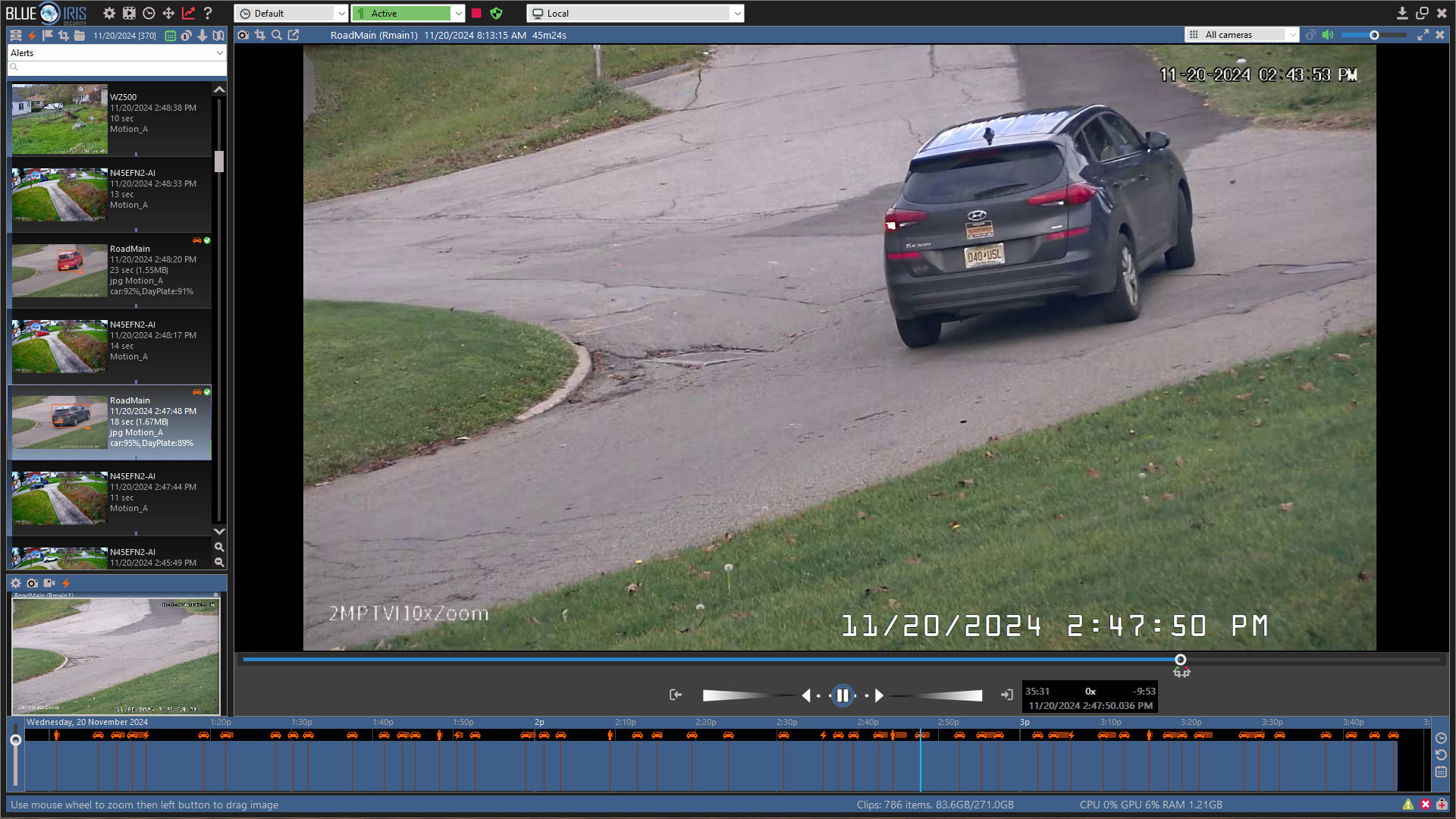

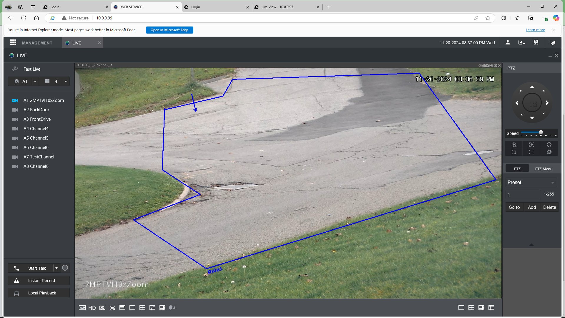

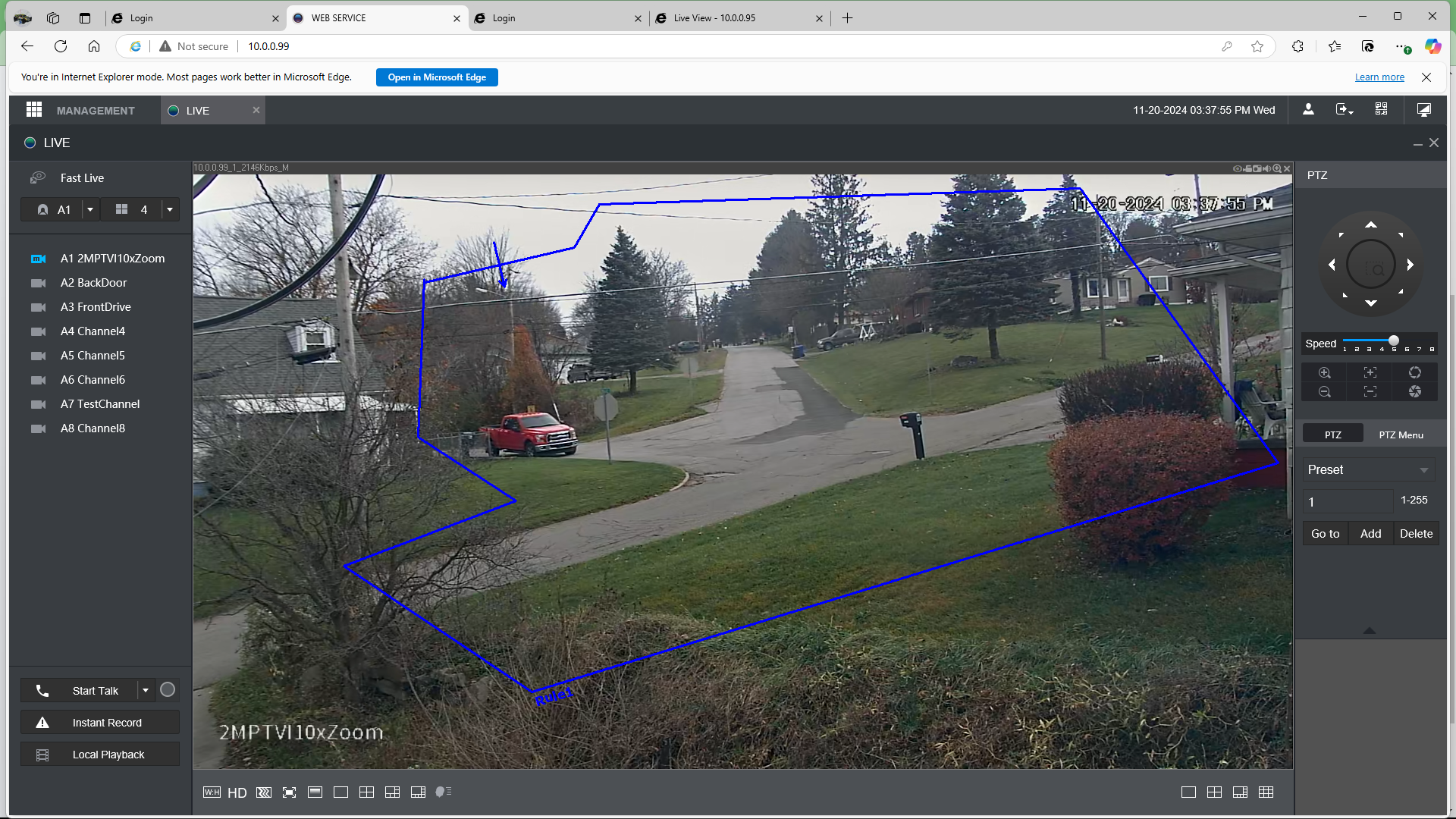

If I had to guess on where to put the Area of Interest for the camera location I would have it placed to the Front of your vehicle and not the rear. So I would get a camera with a Motorized Vari Focal lens aka Zoom lens. Below is a few pictures of my 2mp TVI 5mmx50mm zoom camera. You can see in the first picture the area of Interest *Where I have it positioned full time* then second picture I zoomed it in all the way so you could see what I am talking about where it can go at maxed zoomed in area. The last picture is where and what it can see if it was zoomed all the way out at 5mm.
Last picture I might have to dig one out from today using my Blue Iris. I will try and find a plate that don't matter much to my area lol but will post one to show it as it was captured and not zoomed in.. What I mean by not zoomed in meaning I didn't zoom the digital in to see the plate but you can clearly see this plate. I had a few others but pointed to my location and don't want to give more info then others have already seen or know already..
You will need to spend little more money then 100 for a plate camera. Sure there are some out there that can and will do it with little mods for 100 but really best to just buy a camera that can do it already.. I would look at IP8M-MT2544EB or EW if you want white.. My camera while very old from 2016 cost more then 2 times the cost of the MT2544 and has features that zoom cameras of today still don't offer..
To look at full sized picture right click and open in new tab for full 1080Pp sized picture and you can clearly make out the LP in my Bi picture.

Blue Iris from car going by with where my lens is pointing full time
Screenshot (3700).png (1.64 MiB) Viewed 10112 times

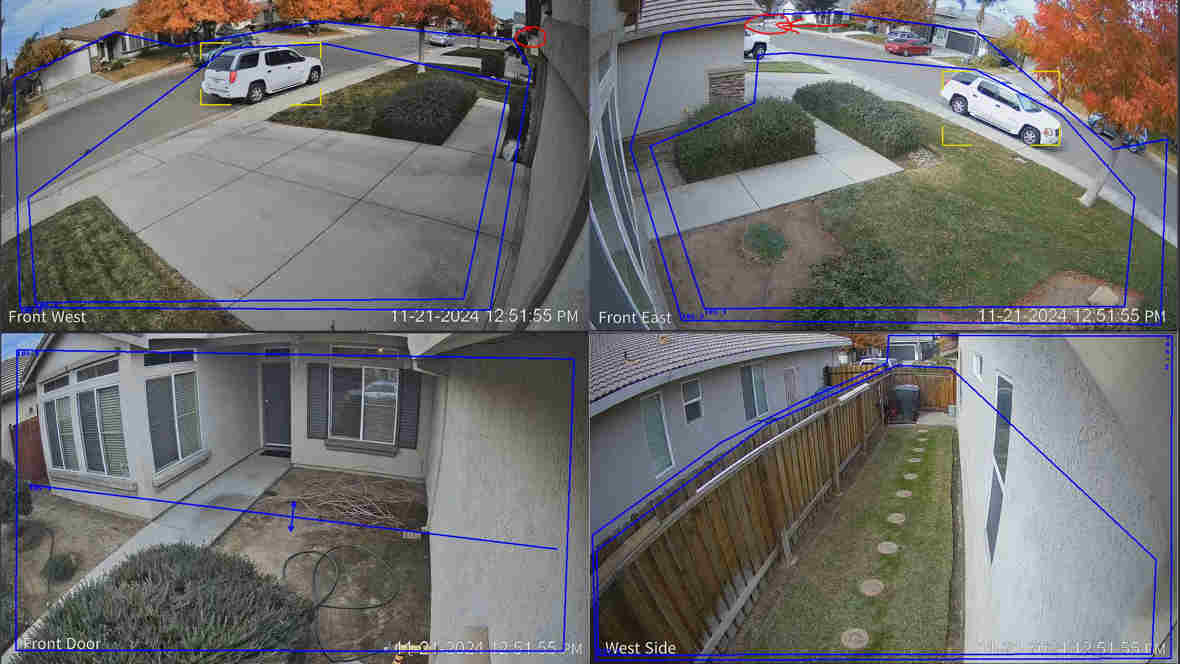

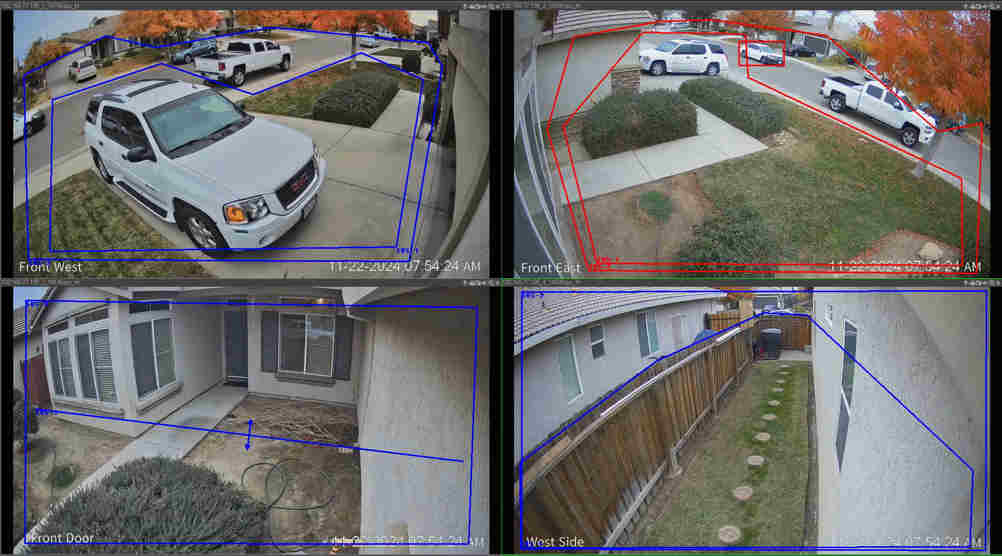

We are considering adding another camera facing out and west in the red circle in the front west view, see arrow in front east view. (west cam looks east, east cam looks west) and we're mostly curious if we'd see an image improvment worth the price difference in the 2 cams.
The second and third cams in that capture can see each other and it doesn't cause any issues in day or night modes.
Note: The cheaper Amcrest POE cams are on sale on Amazon until the 29th for avg 25% off.
FYI The inner detection areas are the ones that switch on the lights when the camera is in NV mode. It's working well. The larger area catches everything but the lights only come on if something 'appears' in the smalller zones.
The tripwire sets off the alarm built into the DVR and acts like an automatic doorbell letting us know if anyone approaches the front door.

Note: The images are set to "original" size. I used the windows snipping tool to capture that image of ASP running on my 2560 x 1440 monitor. It's is not the entire screen.
Here's one captured the same way but of the web interface and reduced in pixel and byte size with another program.
