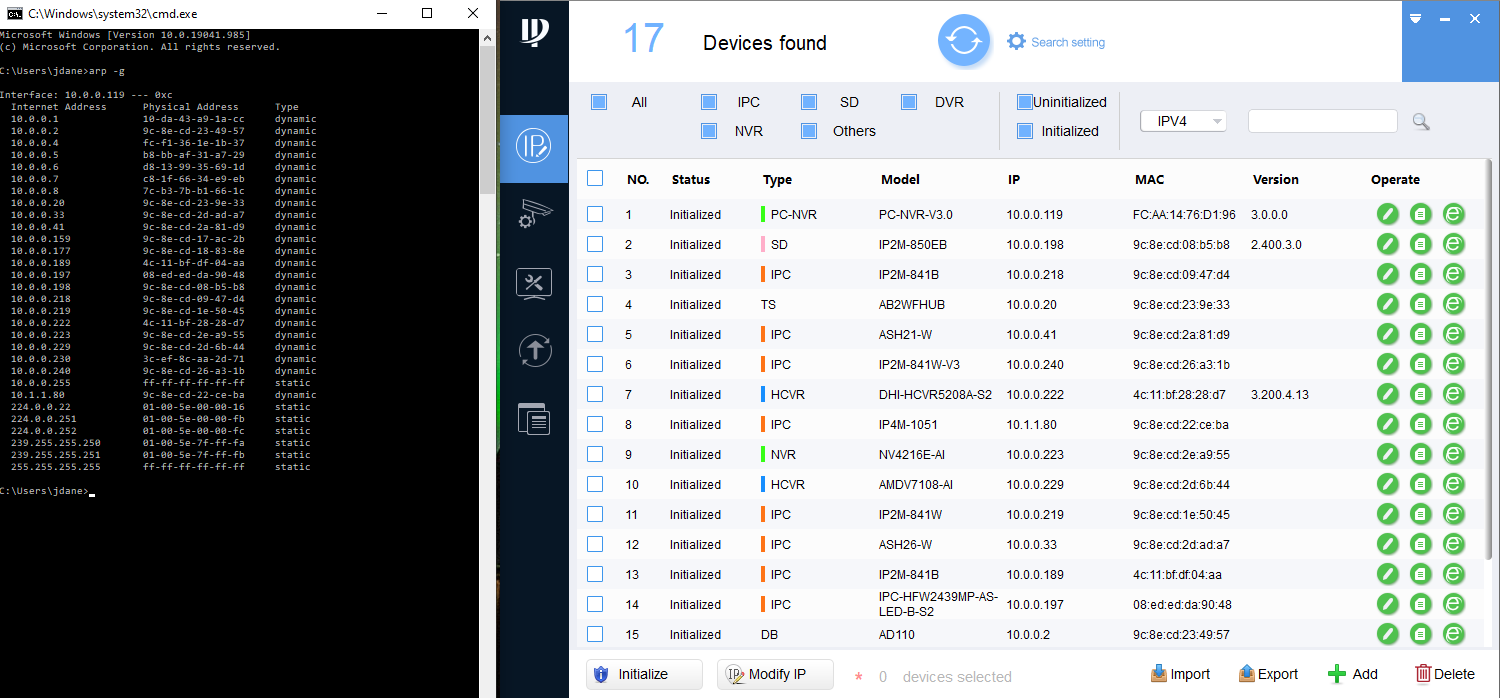

I am not sure.. I know that when I arp after installing a new camera that isn't Related to Hikvision or Dahua/Amcrest I use arp to find the missing camera that is on a Static IP outside of my Range.. So I wanted to show this picture using IP config tool and ARP mind you this isn't all of my cameras I have some that are in a different Router within my Network just isn't in this range to be picked up.. However looking at my IP Config tools you can see I have a camera that I did have connected to one of my POE NVR's I have this camera setup with a Static IP and because I have it connected to my Switch I am able to see it on my search.. In that list PC-NVR is my computer as Longedge has stated if you have added PC-NVR to your ASP it will come up in a search with your computers IP address that address will serve nothing outside of ASP... Depending on the age of the camera, 3c, 4c and 9c can come up as the first 2 letters of a Amcrest Mac Number.. Also looking at the ARP and Ip Config the IP config is better for showing what is what for cameras on your router.. Again I have other routers on my setup that are not showing up even on my ARP however I can access the cameras via P2P with out an issue.. I just don't have access to the IP of the device directly without connecting a cable to my main switch that lets me connect to the 10.1.23.xxx range..
