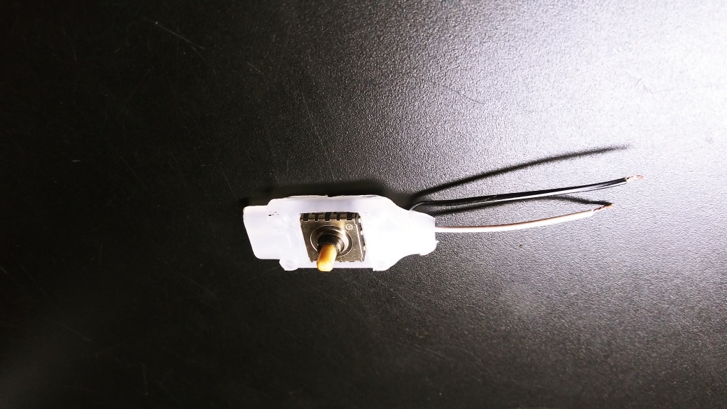

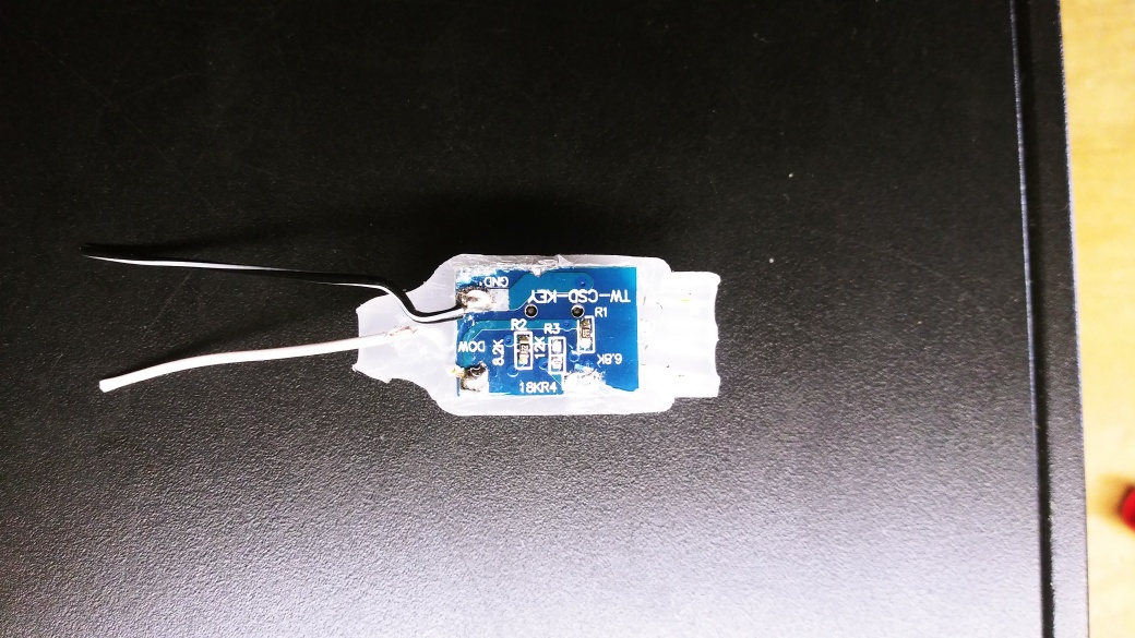

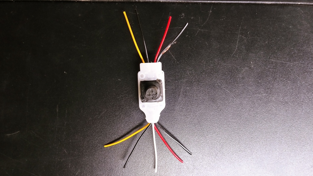

Curiosity got the best of me, so here is the basic anatomy of a common inline 4-in-1 OSD controller. The ones currently being used are all basically the same with the exception of the actual menu items available within different camera firmware. The menu features are still accessed and navigated the same way with any of the common joystick style controllers. White is the single control wire to the camera.
Basically one control wire to ground. But it wasn't always this simple! I ran accross this thread from an astronomy camera site that shed some fundamental light on the basic operation of these devices whether they're old-school multi-wire boxes or modern single wire inline toggles. I personally like the data over coax approach that just works with a mouse via the PTZ controller features on a modern DVR!
