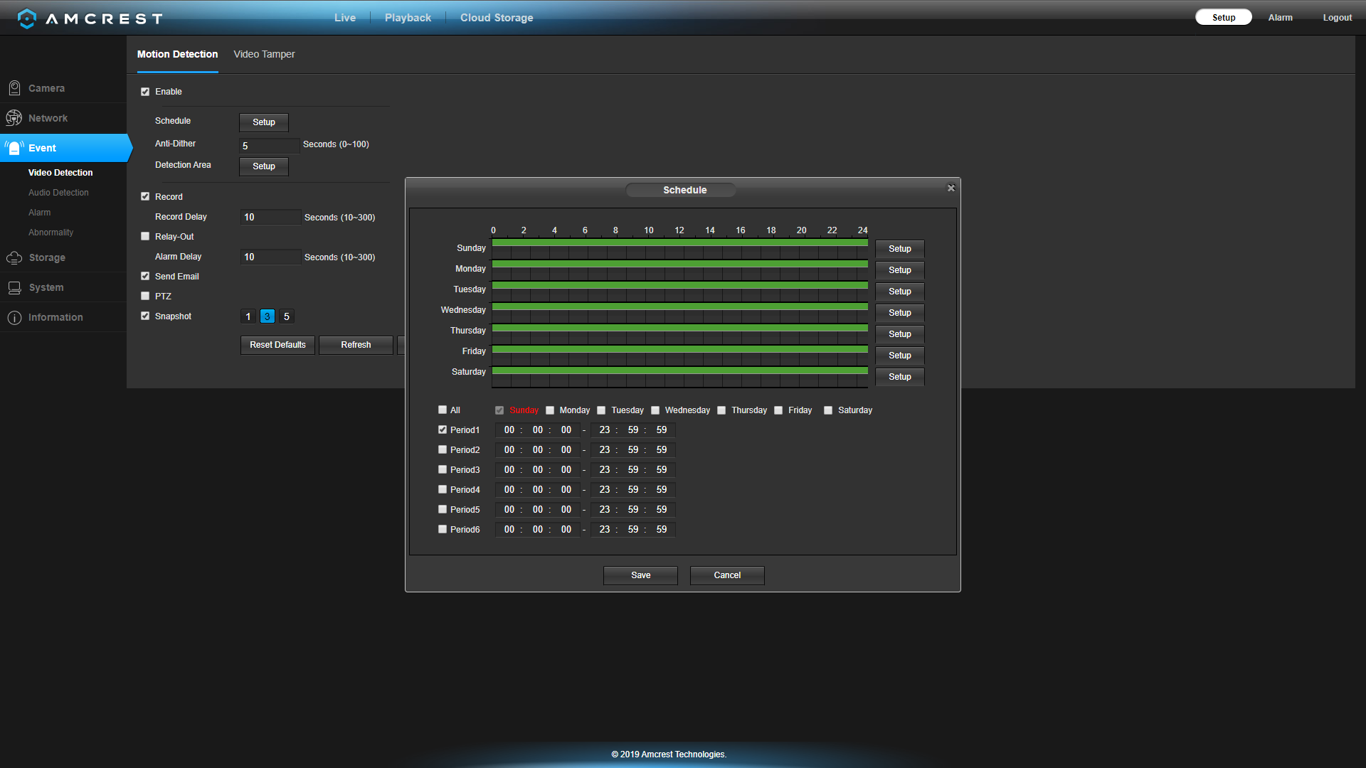

Hello,
Please ensure that that the below settings are done.
1) Go to Settings > Event > Video detection and make sure its enabled. Click on the Schedule and set up the schedule approppriately. Also seto up the detection area in the same page and check the 'Record' check box.
2) Go to Settings > Storage > Record Schedule and make sure that the 'Motion' is enabled and the schedule is set. Once done, you should see yellow lines on the schedule page. Save the settings.
3) Go to Settings > Storage > Detination and ensure that 'NAS' is checked under path.

Re: 1080p ProHD won't record on Motion event, only manually
@Obeycamp222 Welcome to the Forum.
Sorry your having some problems. Can you confirm what 841 you own and the FW that it has installed on it? You don't need to provide SN as that isn't anyones business but yours and Amcrest....
Maybe include a Screen shot of your settings your referring to.
I would put the Motion Detect back to Default. 60 sensitivity and 5 threshold.
Also I would do these settings using the Windows Web UI not over your Phone.
