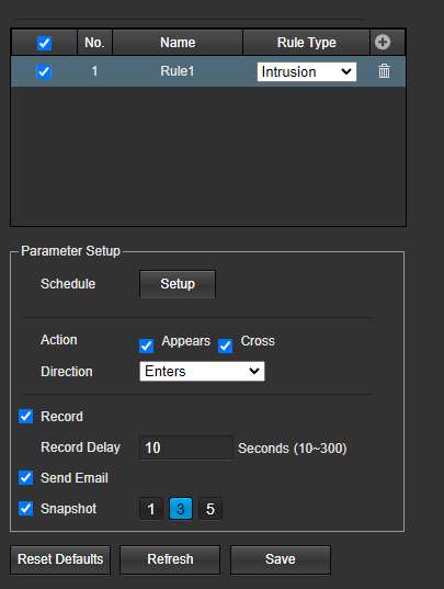

Picture below is from my 2496EW-V2 with IVS enabled, I have Motion disabled so only get IVS events you can see here what I was talking about Record Delay.

However in the works of Events when you setup your camera for Motion or if you turned on the IVS events for your camera then you could have between x and z for time. In your Events it would be under Post Record or Record Delay as some say. This is for how long you want the event to record. If you put in lets say 10 as it normally comes setup stock. then on a fast normal event you would have 15 second recorded and or could be 10 in other cameras. Because some will use Pre- Record and Record Delay together for total time of the Delay only and some will work with Pre Record and add the Record Delay time. This will take some playing around with to get your Event times for each recorded moments testing of each Pre record and Delay Record. So your not Confused as it kind of sounds. Delay Record doesn't mean it will wait that long after a Event is triggered to record it really means that is how long the recording will record after event is triggered.
