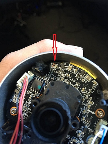

This configuration used to work prior to updating the firmware, so somthing changed:
I set up an ssh tunnel for port 80 from the camera to a localhost port. I would then use InternetExplorer to access the camera via http://localhost:localport.
Everything was great, but now with the latest firmware, I get the above message. Has anything changed in the way the stream is set up?
Thanks
-Ted

Hello tedp,
Please hard reset the camera and set it up again and it should work. For resetting, you need to open the camera and join the two brass ports on the main board with a wire for 10 seconds.

Is the "factory reset" option from the GUI not enough? I tried that, but to no avail. Unfortunately, the camera is 300 miles away and installed high above a garage. If the hardware reset is what is required, I'll do it next time I'm there.
Thanks
-Ted
