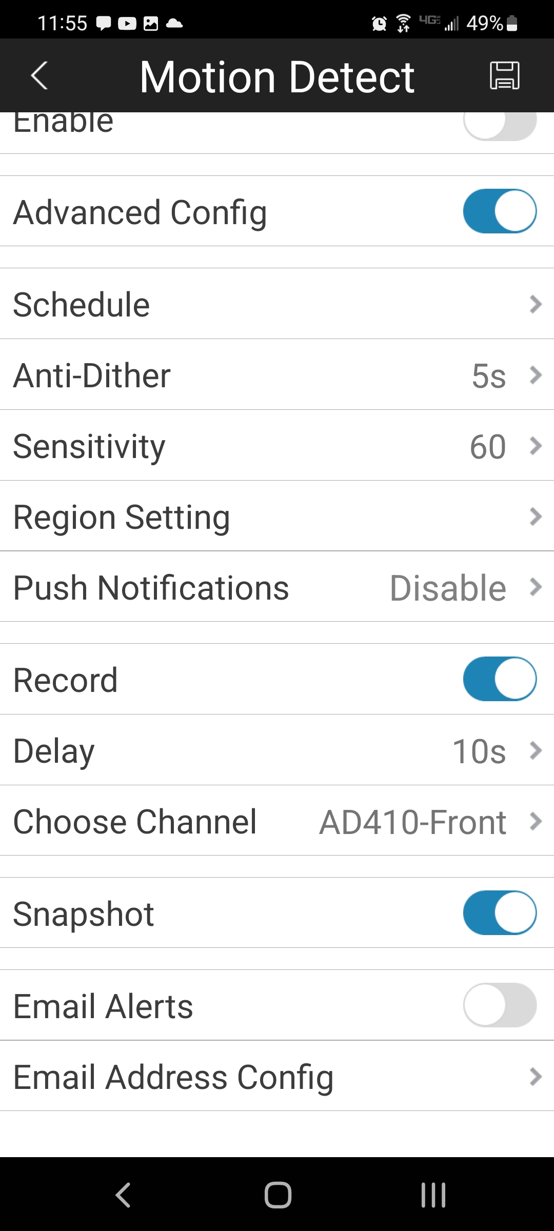

So that is an interesting issue. I would double check the Info for the 1041 in the manual or maybe on the Web even. See there is some special char that will be rejected if your password has one of them. How can you fix it. Well one way and the way they would tell you to fix it is Change your Password, The way I say to fix it is use the Amcrest View Pro app, You can while looking at the device there is a device edit button on the top row mainly used for motion however if you scroll down to the bottom of that area there will be a Email area. In there you can input the email and save at the top right and once that is done it should work. I can't say that is 100% for all devices however I know that I have a couple of Recorders that I can't use my Password because of a special Char I use. However I was able to fix it that way. The issue is the WebUI and for me the Recorders GUI won't let the Char get past so the email fails because the password isn't complete..

My password is just numbers and letters, but I did try your suggestion of using the pro app (android) just in case it was able to get the email test to work, but sadly is didn't.
But I did find a bug with the app - it won't allow you to specify a custom port number for auth type of "None", whereas the webui does allow you to (and I actually do need to use a custom port number for my smtp server).
