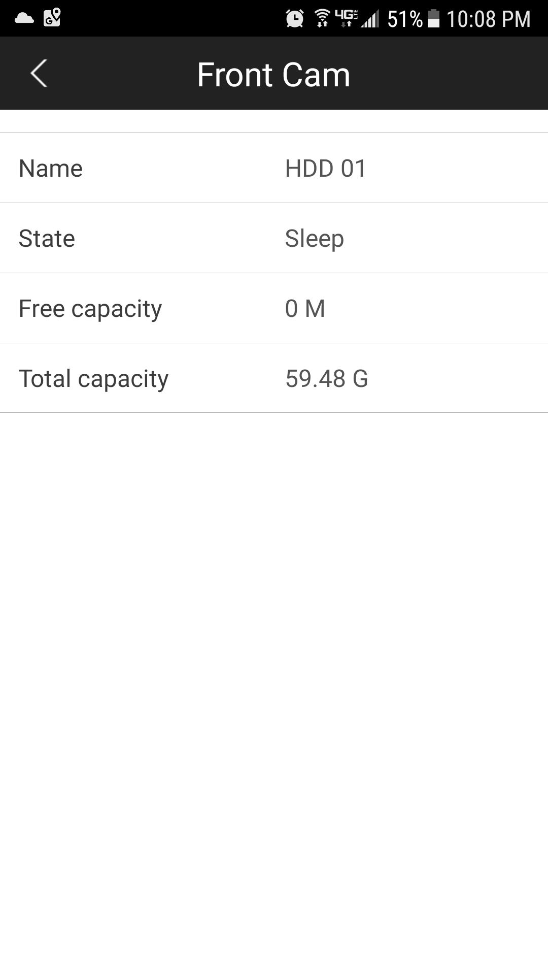

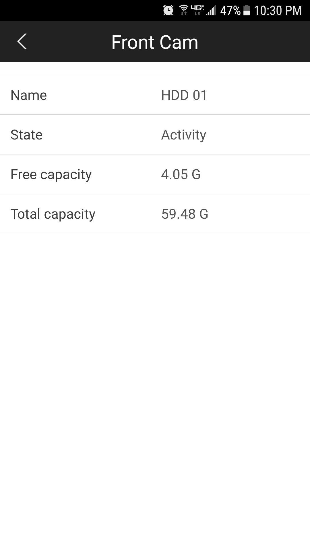

I have had my camera set to 12 hour and the Amcrest Pro app has been working fine. Tonight though I found my camera stopped recording to the Amcrest Cloud. I connected to the camera with both the Amcrest View Pro App and the Amcrest Surveillance Pro app to see if the camera was still recording. There was no video recording during the time when the camera stopped uploading to the Amcreset Cloud. This is the first time I have seen this. Even though the camera setting is set to overwrite the storage the app shows that the storage is full and the camera is in sleep mode. I have never seen this before but I have attached a picture. BTW the camera is a ip4m-1026w. I rebooted the camera using the Amcrest Surveillance Pro App and the camera began recording again. What would cause the camera to go into a "sleep" status? The camera should never go into a sleep status.
- After Reboot - Active Status
- Screenshot_20180411-223048.png (53.25 KiB) Viewed 3503 times
- Prior to reboot - Sleep Status
- Screenshot_20180411-220801.png (52.93 KiB) Viewed 3503 times
