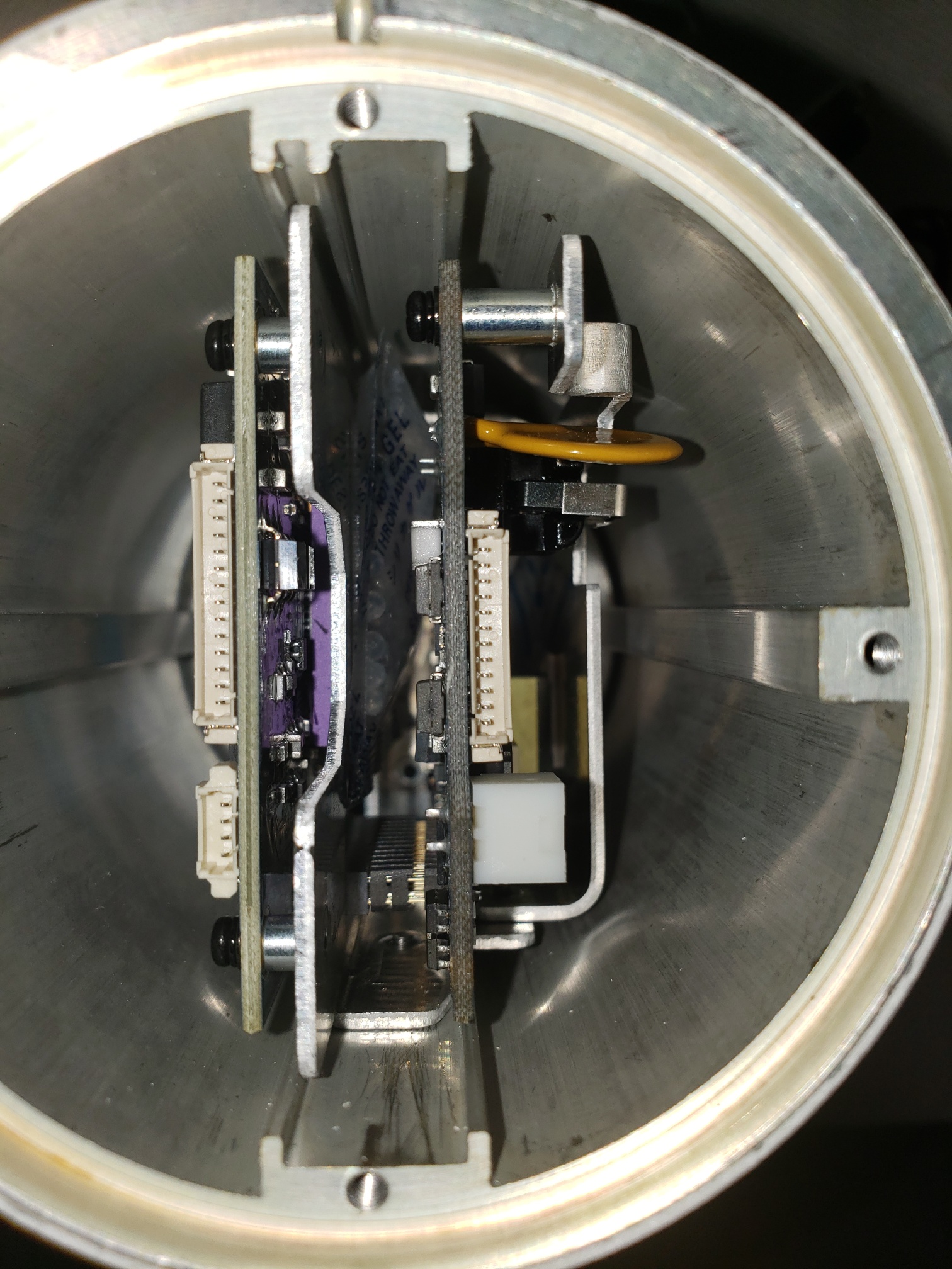

I am in no way promoting anyone to take their cameras apart as far as I do... However this camera in Question has a Gel Pack that is taped in between the power supply board and the Video board.. There is also a Packet that Sits in the Lens area that is wire tied to the post that hold the IR...

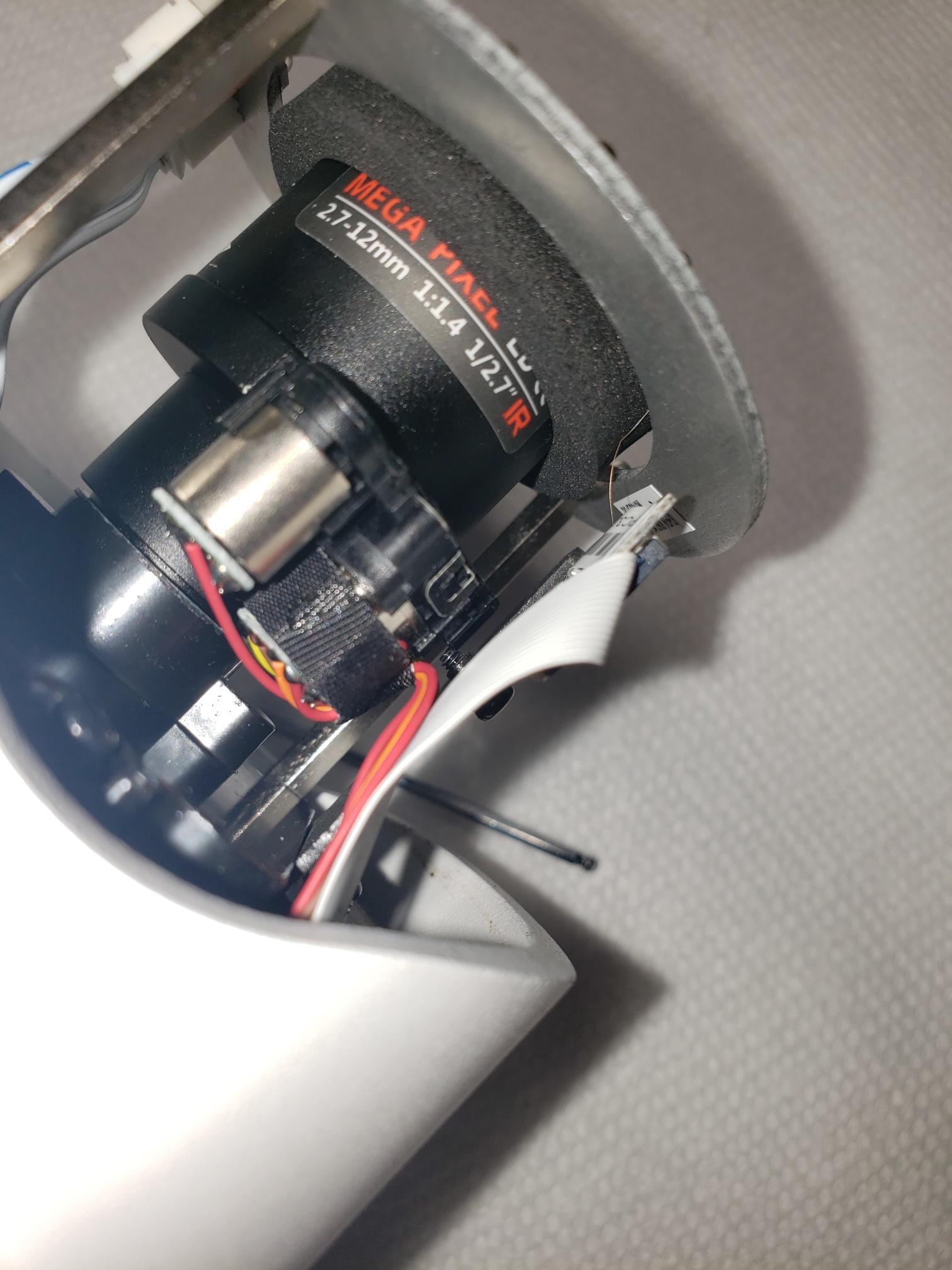

This camera is a IP camera with Alarm in and out, Audio in and out and has a CVBS install view port. This camera has IR Cut Removable Filter and a DC Lens that you can tell by seeing the 2 small motors on the Lens.. Sadly this camera isn't a Motorized VF but I do have a Lens to get in its place if I wanted to add a Motorized 2.8-12mm lens from another Zoom camera that the mini computer in it died. However where I have this placed I need to keep it as it is for now...
This is the area where the Front Gel pack goes.

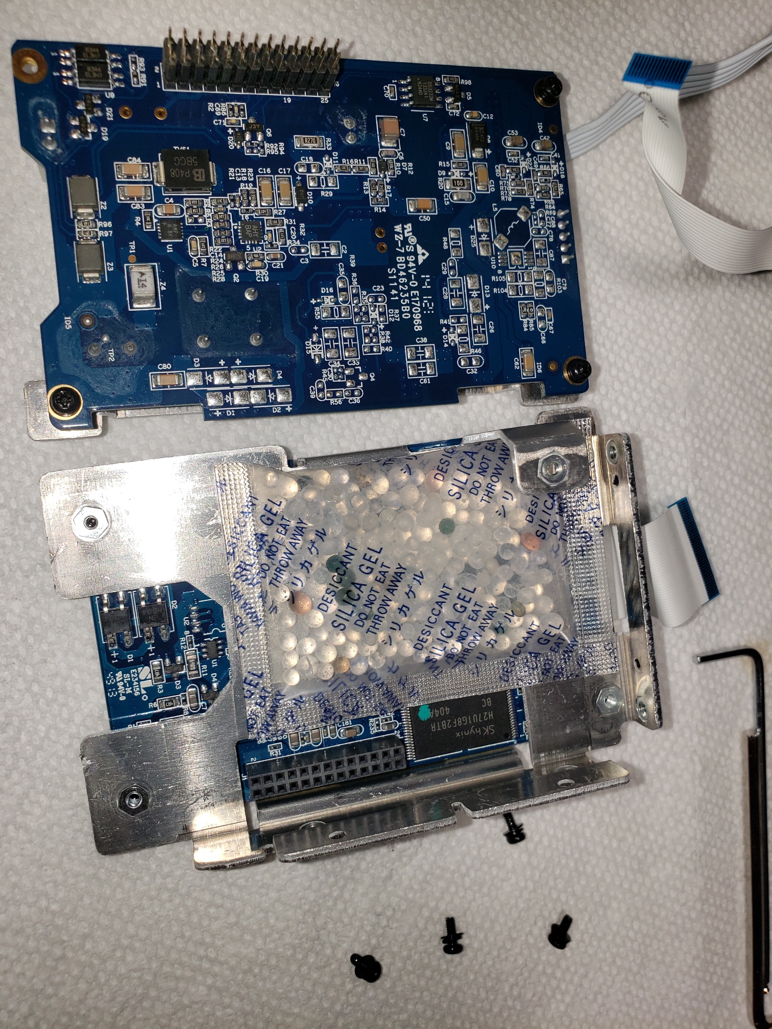

Is is after removing the Back screws and disconnecting the wiring that goes though the seal hole for all functions you can see the GEL pack. I put a new one in its place double sided taped just as it was when I bought the camera 5 or 6 years ago now

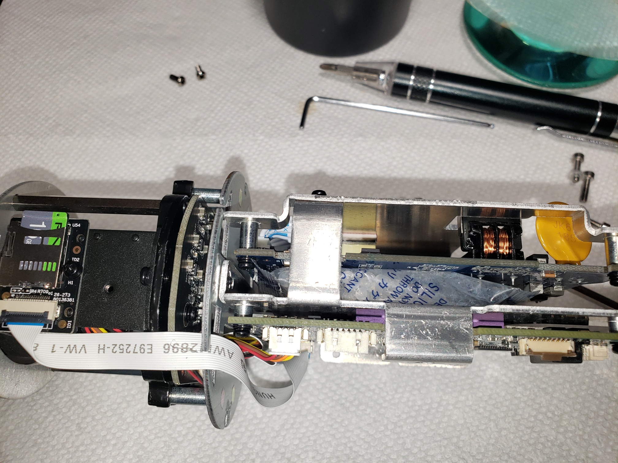

This is with the Whole Camera out of the housing. This is a Large Bullet camera about 1/2 the size of one of my Other older camera. You can see the Gel pack in between the 2 boards
This is a Picture of the Camera all the way apart and to show this year the packet is not as colored as it would be all the other years I replaced it.. This time you can see only a few of the Balls are not clear but I will replace the Gel anyway because I don't want to have any issues with foggy camera if it gets all used up before winter this coming winter I am not going up the Ladder to get it when it is Freezing out lol..

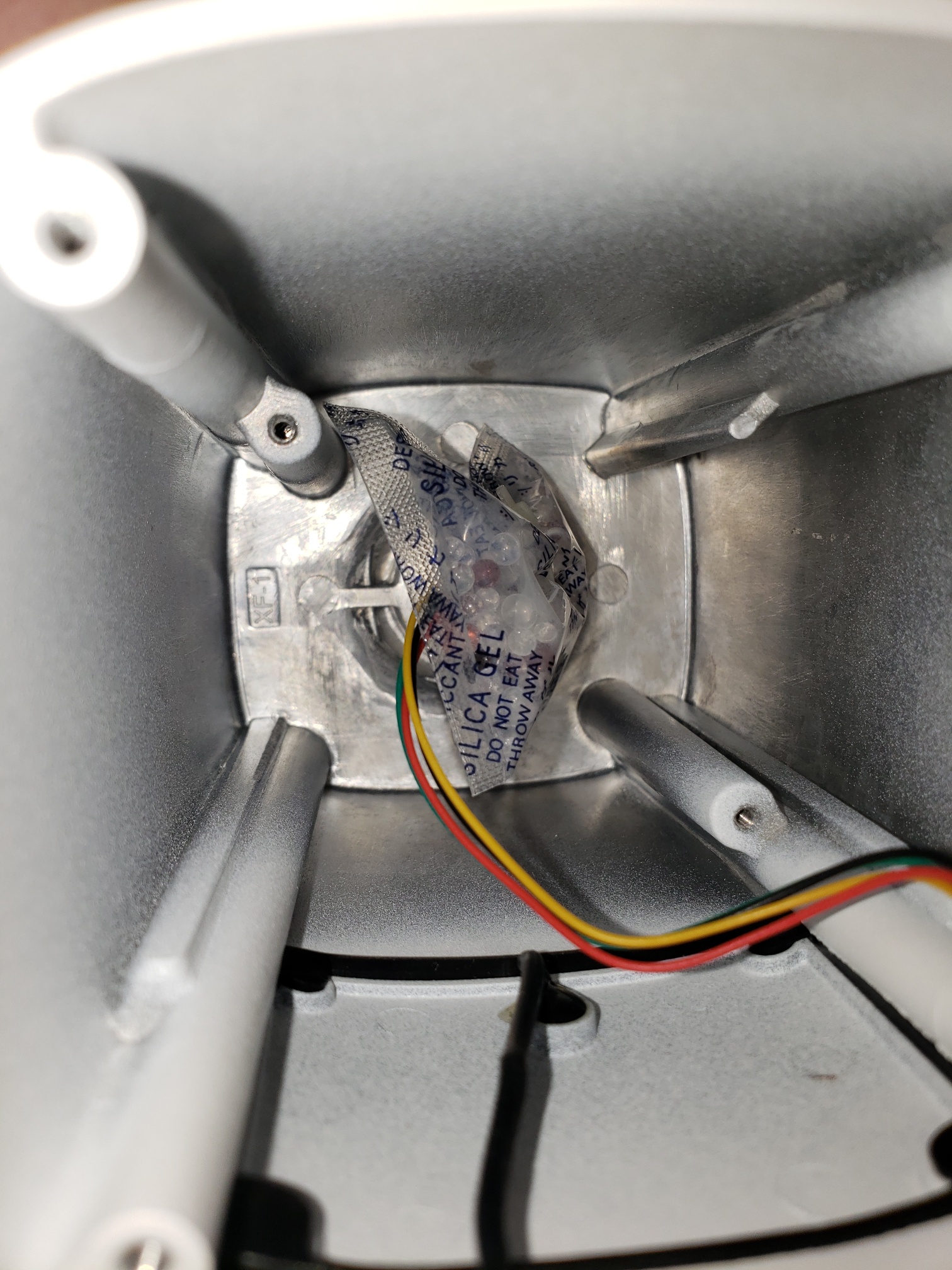

Only picture I took of this was after removing the camera and down the camera body where the pack is cable tied onto the wires...
