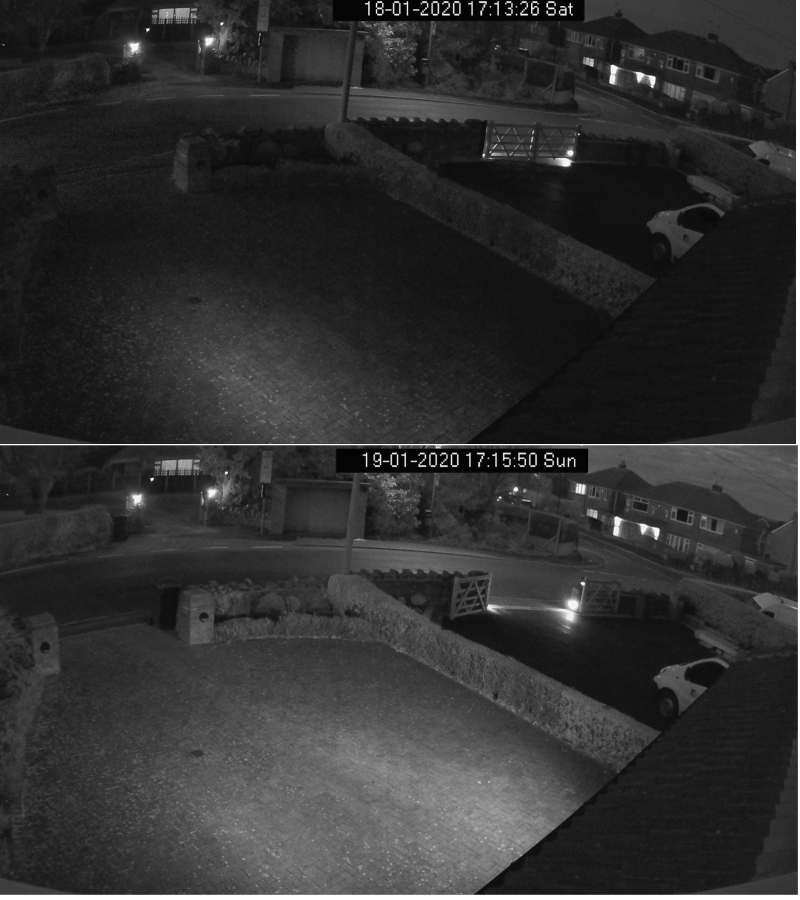

@amcrest168 Yes sure, I bought https://www.amazon.co.uk/gp/product/B07MXBKT7X (in fact I have got 2 one fron and one rear of house).
A comparison at roughly the same time of day. The pool of light on the left which is in both snapshots, is from my external camera and that from the illuminator is on the right.

If I didn't know better, looking at the example snapshots I would say that the camera settings had been altered between the two images but they haven't. The second one was captured about two minutes later which more or less takes account of the lengthening days. The only difference I can think of is different cloud cover.
Although it's not obvious from the images, the additional light actually casts shadows on the hedge and bus shelter on the far side of the road as people walk past. All in all a well worthwhile addition :) .

Re: Thumbs up for separate IR illuminators.
Well I can remember the Video you posted some time ago where your area had an issue with Car prowler and the Amount of light that was in that video to the light you have in both of these pictures are 100 fold. So I am going to guess that the Pictures are taking with a Camera that has no ir on. I wonder what the Spread would have been with that IR on the location of that area. It almost looks like it would need to have more power if it was cast from the Capturing camera area?

@Revo2Maxx :) Yeah that car thief showed up well enough when he was on my neighbour's driveway and he triggered my neighbour's standard floodlight. Obviously the IR on my camera is switched off as it's behind glass but the IR illumination from the outside camera on my NVR has been improved on many times over by the new IR illuminator that I just installed outside in the last couple of days. An unexpected bonus is that the constant snapshots that were being triggered before have stopped completely.

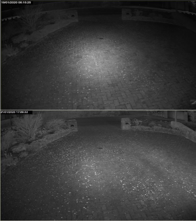

A comparison (time of day different so not entirely fair) of the difference it's made on my NVR.
My AMCREST Cameras:-
Very nice. What camera is the one with the IR? It almost looks like it isn't on Smart IR or using the Smart IR feature?
