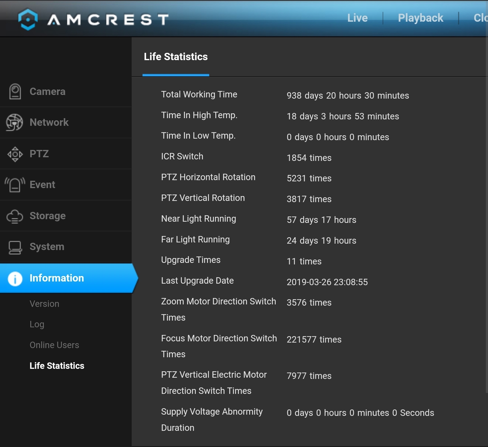

I have a "high end" Amcrest PTZ IP2M-858 and it apparently never gets cold inside even though it sees freezing temps and precipitation (nothing like you have). Maybe it has an auto heater. OSD camera temp showed 69° when outside temp was 39°. Life Statistics below are interesting.
Re: Snow and Ice nothing nice for your PTZ Camera
Very awesome info.. only thing I get that has LIFE info not even on all my PTZ domes only some of the even higher end ones then the one I showed is Fan Life lol... WOW your camera says it wa in HIGH temp for 18 days.. That is one reason I have always set my Heat and fan Manually so I don't have to worry about it over heating.. However I don't know some of the PTZ cameras I have only offer a Cooling fan without Heat but then to be honest it has 36 LEDs and 6 of them are High Output like I am guessing yours is as well. Where yours shows your IR in Near is used more often then in Zoom mode... Updates lol Mine or most of mine have never seen an update.. I do have hummm would have to go look but I do have some other IP domes that do get updates but I think even then the last one was in 2016 lol.. However my others like the one in the video is from 2014 might be 2013 and never seen an update.. I do have a 2011 PTZ analog that I did a Update on in 2014. It was a chore having to setup a RS-232 link from my computer to the camera... Then having the feeling that I killed the camera because it took forever for it to come back to life lol..
I have been toying with the idea of getting a 853 or 858 I do like all the info yours has... Sadly most of my IP domes are from 2011 and 2014 is the newest maybe 2016 I think that I think about it..
