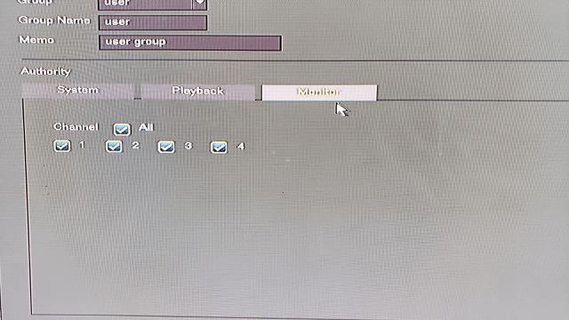

Not sure on the settings of your NVR. I would assume they might be somewhat the same as my older DVR with improvements. Longedge answered most of the questions. But thought I would followup with a Gif of my DVR pages for adding users. on the main page you can add the user, then there is a page of what they can view and a page of what they can playback...
Main thing with this idea is because there might be users that would monitor your system but maybe don't have access to all areas of your home IE bedrooms or your business like The Office where the money is counted. So you could setup a user to have access to all cameras but the ones only the Admin users could access. You also have the ability to setup admin user with limited access as well. Again same idea don't want them to see Camera 15 and 16 or play back them channels it would be removed from the ability when they are logged on.
Then looking at the Camera in both Old and New FW you can make admin account and user accounts but seeing it is only 1 camera the options are just 1 camera. They both have same type of setup and menu types.
I took 3 images and made a GIF, I did lower the speed down to as low as I could go so it wouldn't change so fast. But it gives an idea about what it might look like in your NVR.. Still little fast lol..

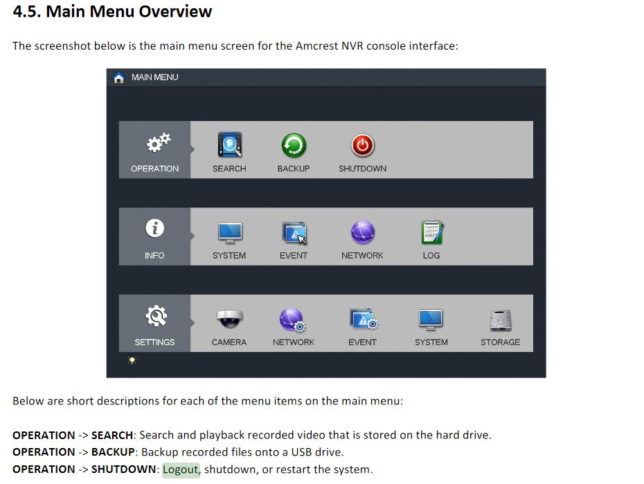

Re: Search without the need for the required admin password
I just had a look at the online manual for your NVR and this looks like the answer to your question about logging out:-
p.s. - Seeing that button called "Shutdown" would make me think twice about clicking it

SOLVED: Search without the need for the required admin password
James wrote:
"Seeing that button called "Shutdown" would make me think twice about clicking it".
Funny, that is exactly what I assumed. Anyway, with your help, I was able to create a new user account that will allow (my) Users' to perform the simple task in viewing camera searches.
