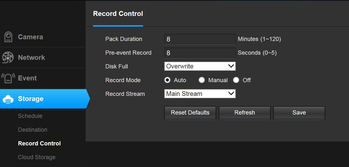

How do I get SD storage active?
The micro SD card is installed and not showing up in the panel
The attachment shows what I see
Melvin
Posts: 2210
Re: SD Storage - how to activate
Post by Melvin »
Hello bigbasin,
Go to set up > Storage > destination > Sd card and ensure that its listed there. Click on the format option if an error is displayed. The card should be properly inserted with the metal pins facing upwards.
You should also enable recording under > Storage > Schedule.
