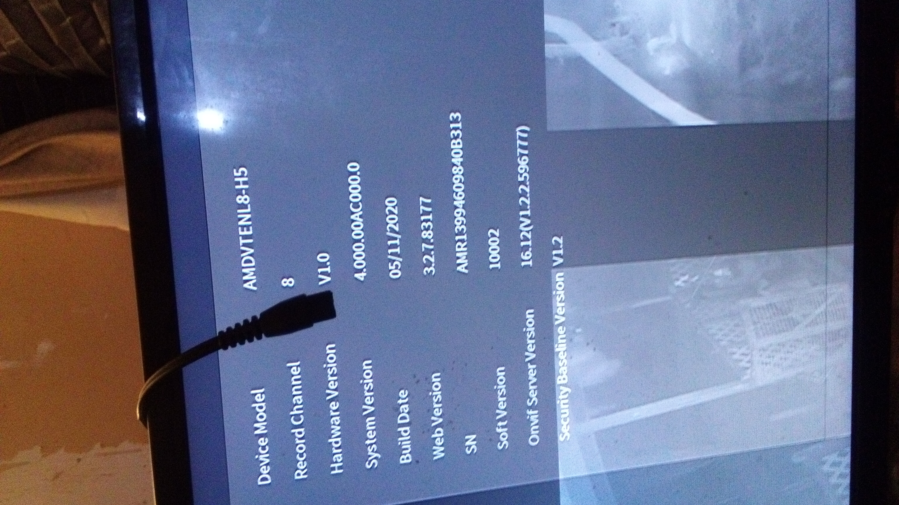

Hey my name is is Johnny I need some help with makein sure no one can access my system remotely and making sure my CCTV system has no internet access via Ethernet cable phone line wireless and how to disable any internet or remote access featuresImage
This is my amcrest security camera system

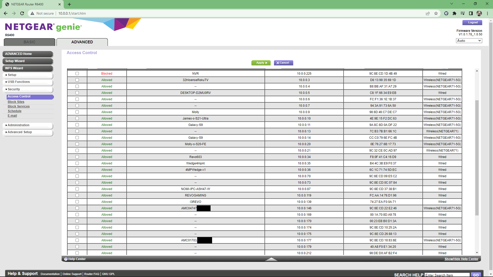

Hello and Welcome to the forum.
I am not sure what you're asking really? I mean if you want to have no access to the internet and still have your DVR connected to the local network the easiest way is to have your router deny the ip that your DVR has access to the internet? Then you can do it from your router as you can see in my picture I denied access to the internet however my local area network was still able to send the IP data from the cameras to the NVR just I wouldn't have access to the NVR from the outside.
If that isn't what you are trying to do then please expand on your post on what you want to do.. Thanks
However if you want to have no access at all local or WAN then only thing you have to do is remove the Ethernet cable from the DVR all your cameras will still record to the recorder you will not have any local access and if your DVR works with IP cameras then it wouldn't have any access to the IP cameras either.
Another thing to do is use a Managed Switch like my HP or my Cisco switches and setup a VPN within your switch. You Choose what ports are on the Private network and lets say you have a 48port and the upper 8 ports are on the VPN, at this time them ports will only have access to one another and if you wanted access you could port in a permission port for local access that wouldn't let anything outside of the IP or Mac you setup.
There are many different things. Just need more info of what you want to do...
