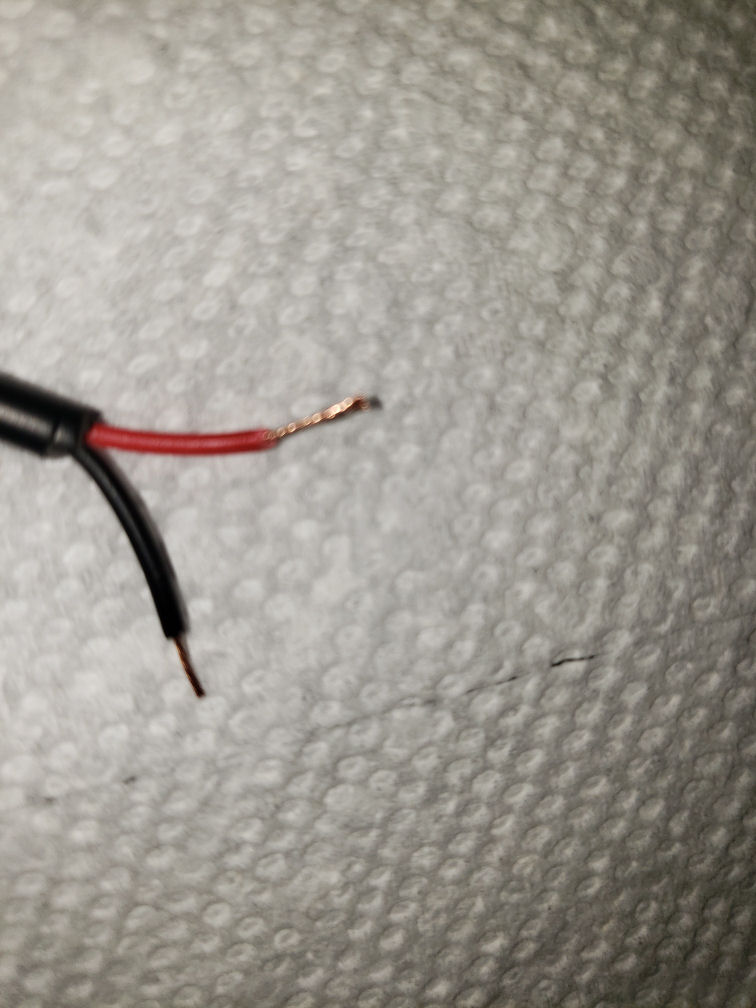

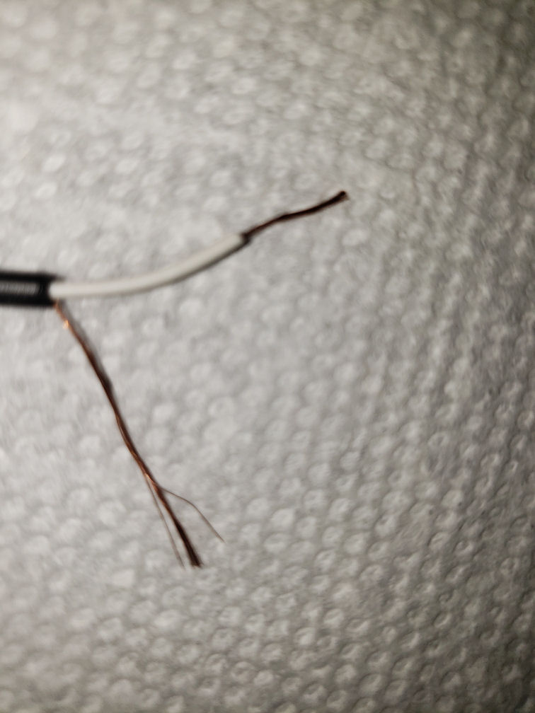

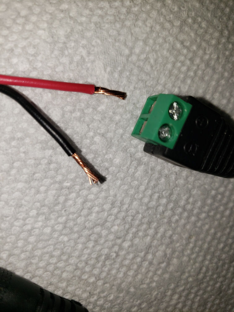

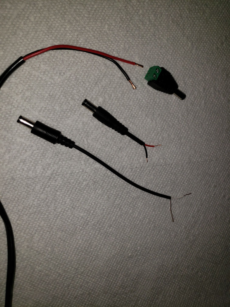

Image of the wires from the Real Siamese cable I use in my system setup to the others that was in his
This is from my system and this is from Siamese cable with 18awg power wires
This is from the kit premade wiring for BNC over coax Not good enough for much over 150 or 200ma
This is from one of the Splitters that was used for powering the cameras these go over a short 6in cable but powers the 60 or 100ft cable that is connected to the cameras and to be honest how small these are I wouldn't use them on a 20ft cable for much over 150ma plus it don't even have 2 inner jackets only 1 Not very safe

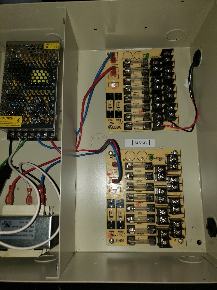

So I thought I would bring in a Picture of a Dual Voltage power supply. This unit was a 16 Ch 24vac unit but I needed both voltage in my garage so I took a 12v unit by the same company and took the Power supply off that box, Took out one of the 24vac Transformers from this unit and added the 12vdc power supply it is the one on the top...
I have a Few of these systems in my CCTV setup. Most of them are 12vDc I removed this system and changed out my Power supply in my Garage for the time being to a 8 ch 12vdc system because the cameras that require 24v have been removed form my Garage line up Thought while I setup the Supply for its new location I would take a Picture of it while it is still clean looking... Once I add the 8 12v and 5 24v camera wires. It would be hard to get a good view...
