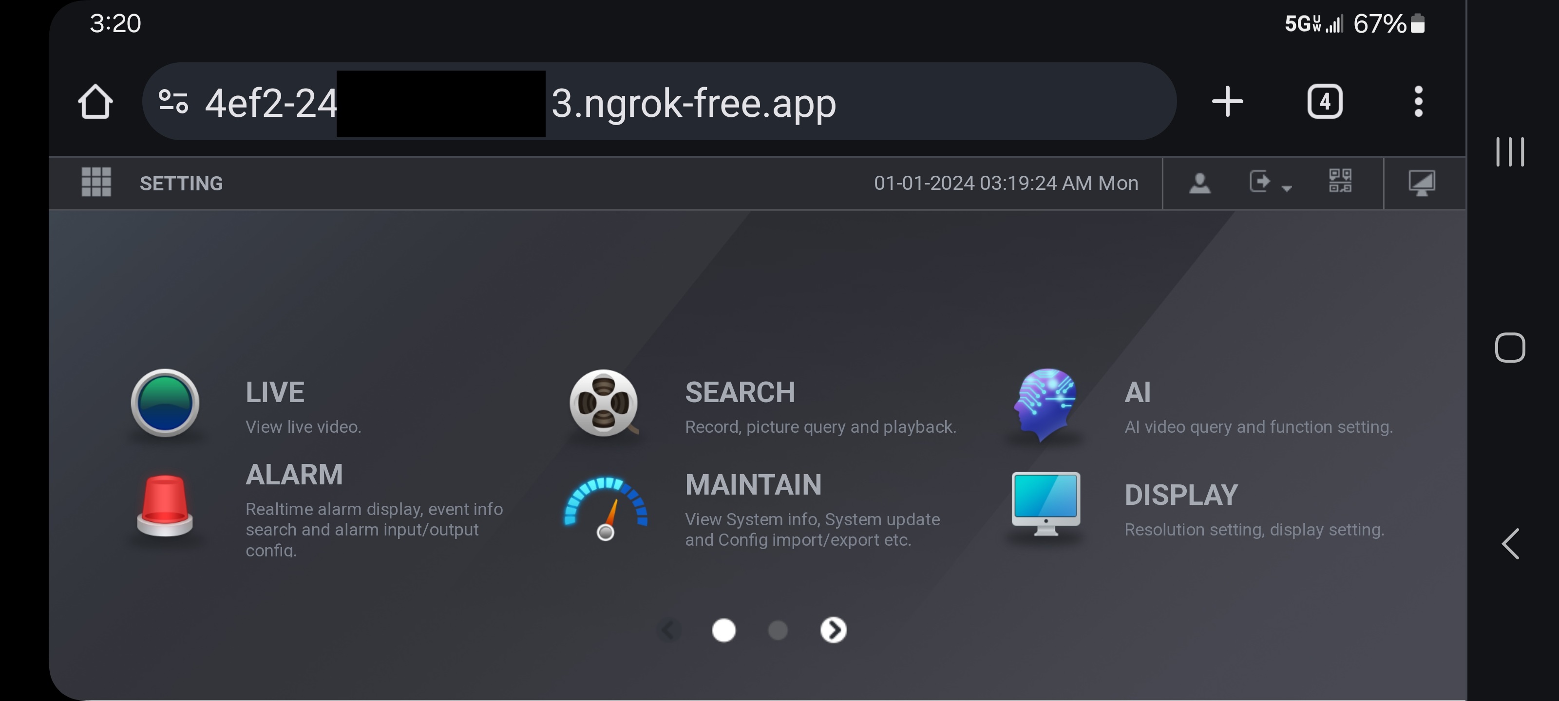

here is a Picture of one of my AI NVRs using NGROK and you can see that the phone is using 5G and not my local Wifi...

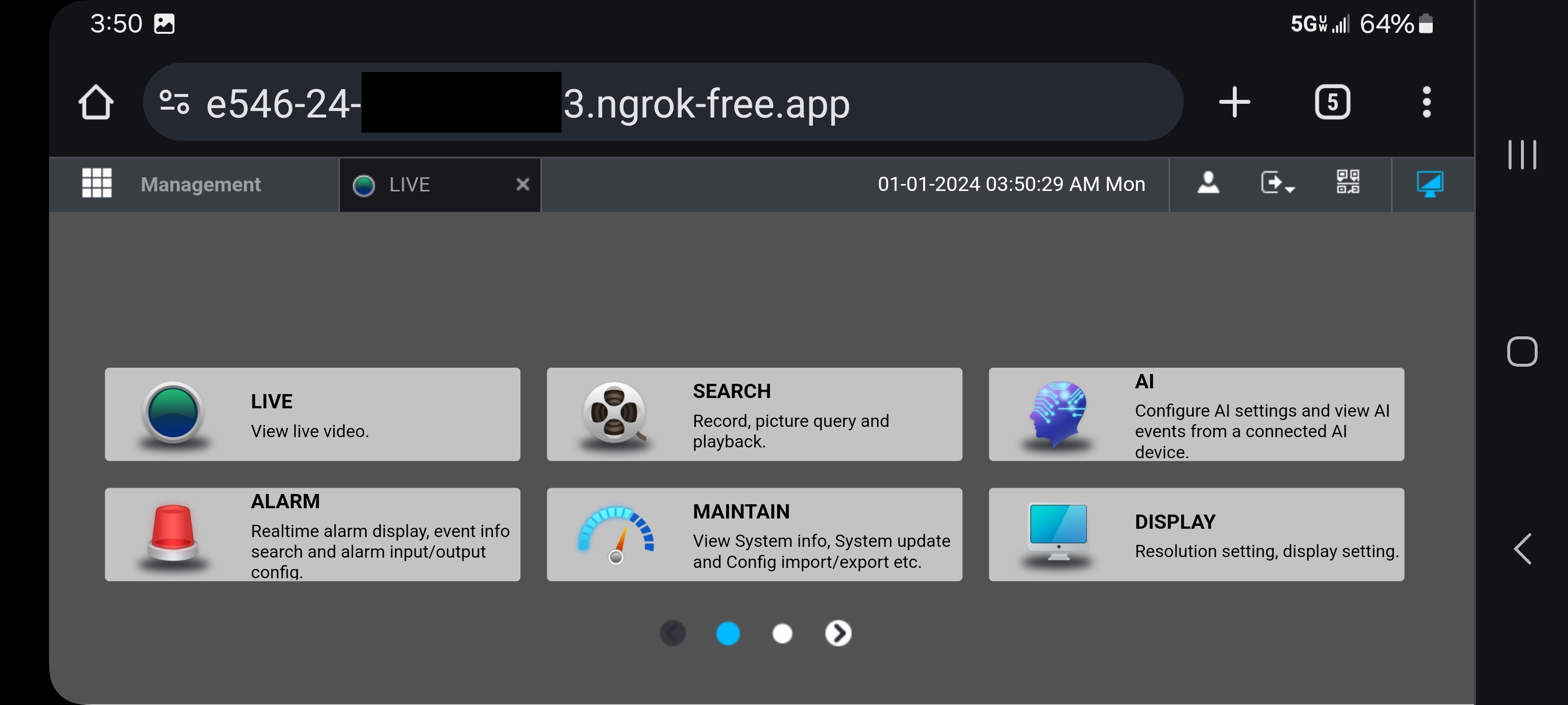

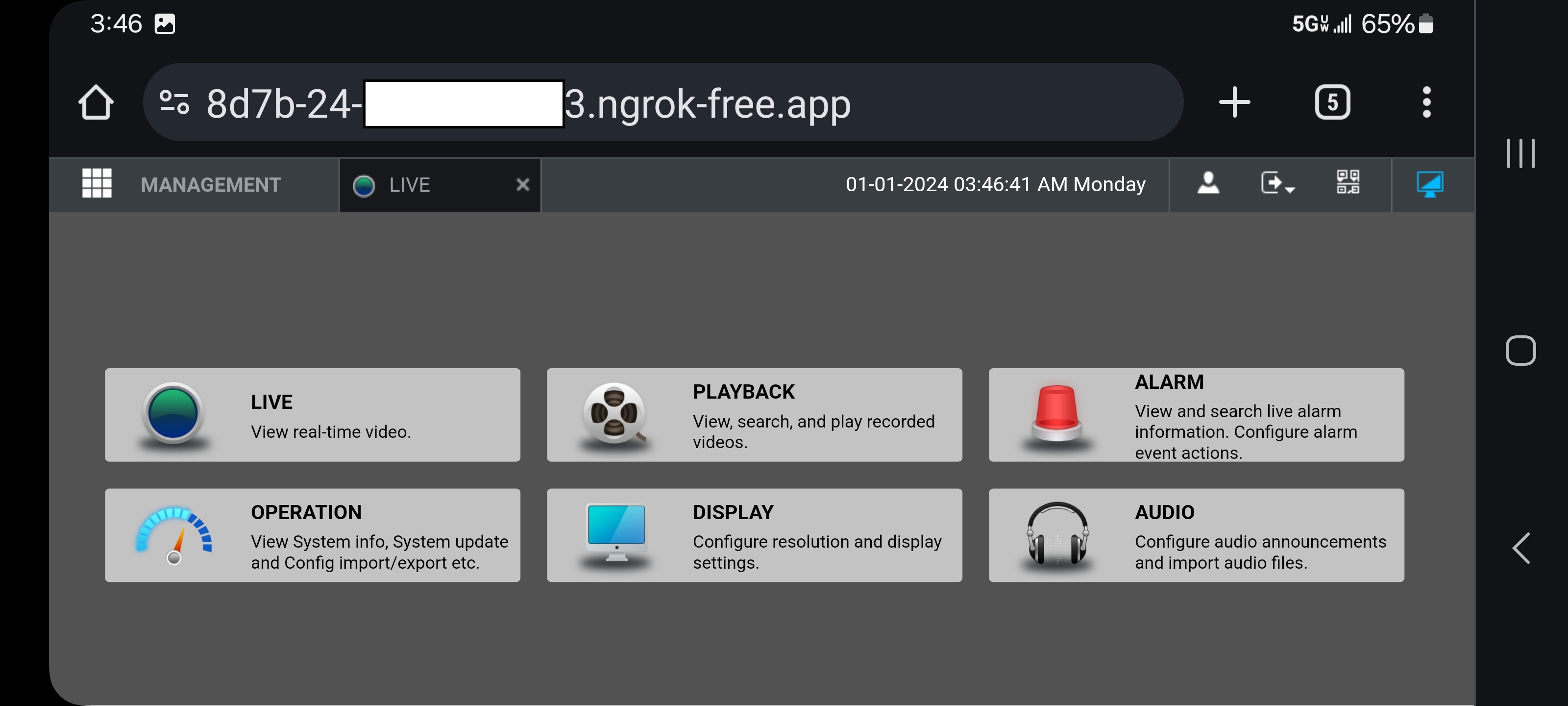

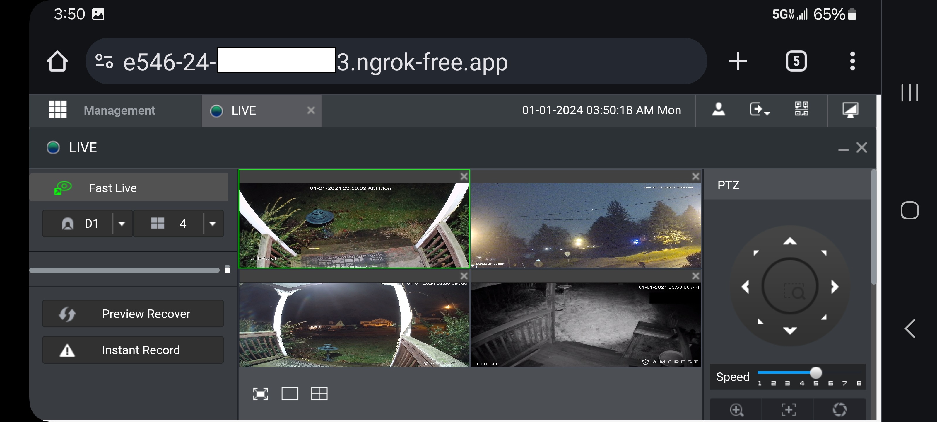

So first picture was of my Dahua NVR here is using the same NGROK on my 8ch A2 AI NVR and my 8ch HS NVR and even show the A2 with 4 window view opened so it is able to do that.
