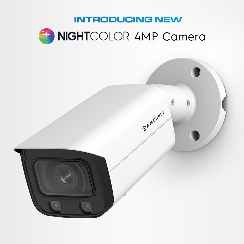

New ip camera with nightcolor IP4M-1046EW-AI
amcrest168
Posts: 474
Post by amcrest168 »
it appears there is a new ip camera with nightcolor and ai.
IP4M-1046EW-AI
link to amazon, https://www.amazon.com/Amcrest-NightCol ... 08CVTM9JL/

This looks very interesting.

Human detection with ID and so on one needs to know that you will need a AI NVR for it to work... So it isn't just 200 for the camera if you don't have a AI NVR already then you may want to keep in mind if that feature you want you will need more hardware

i wonder if the ai ip camera is not paired with an ai nvr, perhaps the only missing feature with the setup is the ai detection portion. basically a regular nvr would simply record just like a regular motion detection. the alerts on the smart home app itself would be less frequent because of the ai smart motion detection.

Yes I am going to guess that most of the AI part will be ok.. looking over things some more it looks like all options besides maybe the Face Detection with ID and Store and of that would need the AI NVR.. Trip wire and all other options would or could work out side that over the camera and could give alerts as such like my older AI camera from Dahua from 2012 only 1 option needs PSS for it to work and don't use for that anyway... Even heatmap works..

There are some NEW AI NVRs out right now as well. first one I remember was from the Thermal system the 5xxx system however now they have 4208E-AI and 4216-AI to name a few that can go with this camera... Would be nice to know peoples thoughts on the camera alone and the Camera with NVR for the Feature Rich recordings...
