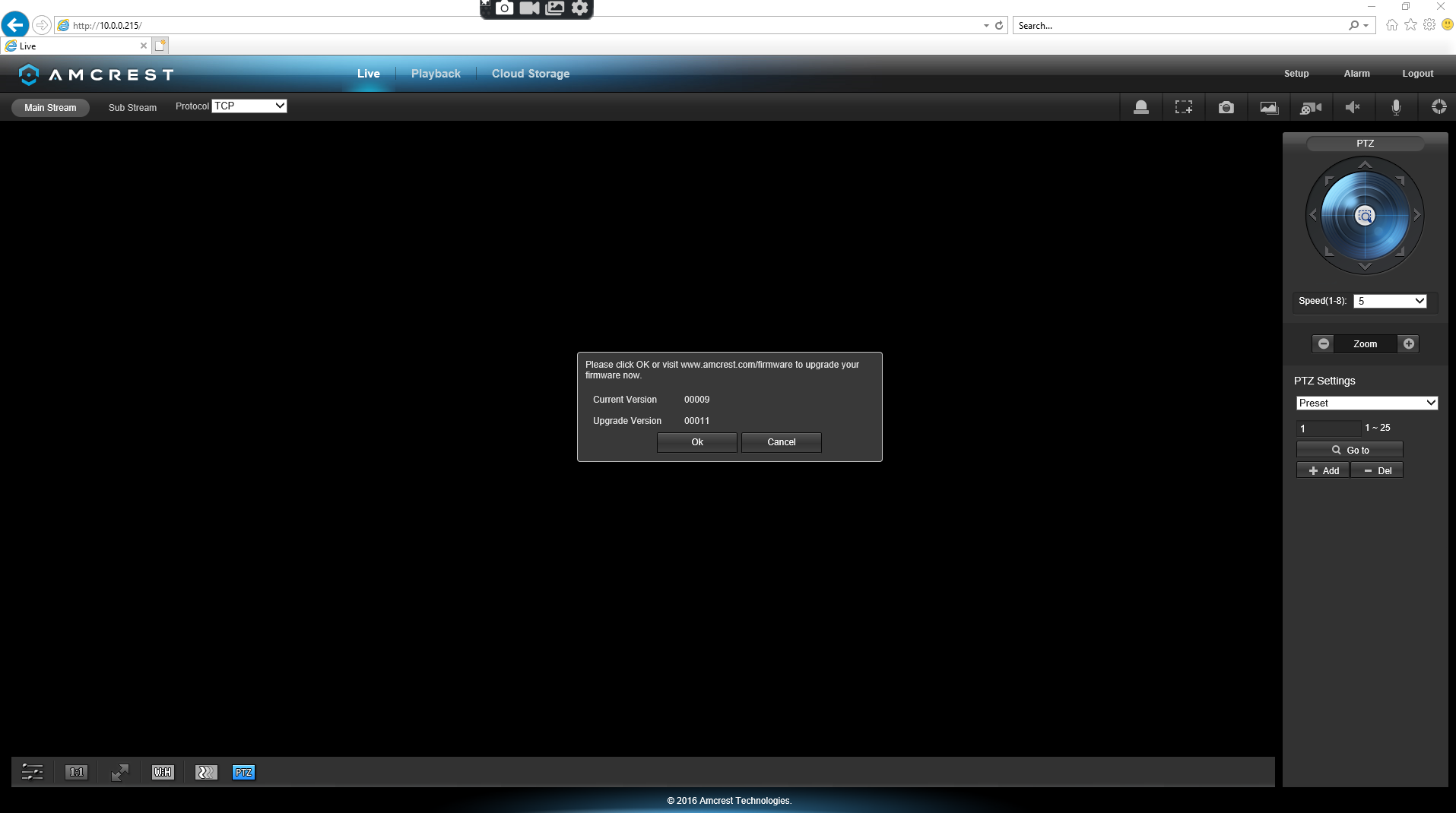

Thought I would show a Picture of what one of my 2015 Cameras with FW from 2016 shows after having added DNS to the Network info..
Things to Note. This camera is from 2015 and did have other FW installed since it was installed in late 2015 the last one was in 2016 and you can see by the date of bottom of the page 2016, That was 009 ver and the last Stable verson was in 2017 that was Non JS and this picture is showing the offering of FW 009 release going to 011 there has since been 3 others released however when pressing the button it only offers Non JS FW so if your on JS fw you would have to get a newer one by going to the FW page to dl if one was released after the one you currently have installed...
