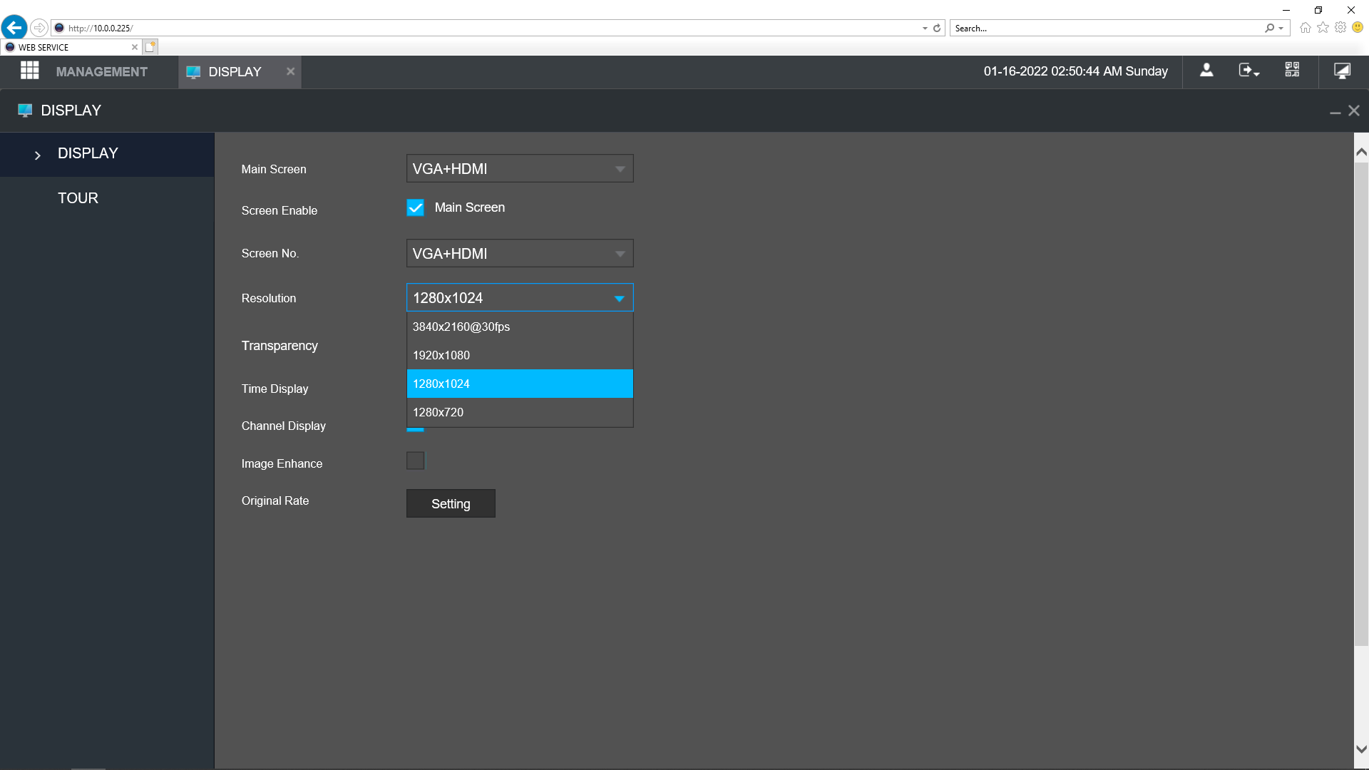

So what you will want to do is figure out what your NVR's IP is if you didn't set it as Static in the Setup before changing the Res.. Once you have that you will want to Log into the NVR using that IP. Then I am going to guess that you didn't change FW, So it will be little different maybe however what your looking for is Settings, Might to at the top right with Gear looking Icon. Then click General, Display. In there you will be able to change it back to where you need to be. Normally that is like 1280x1024 or maybe if your using a TV 1080 is good..

Should work and on some Machines it might, I also have told people in the Forum to use this method however as you can see in the picture above, When you setup the machine the setting for display is HDMI+VGA and that means it would need to be connected to a Display of the size he set for it to work. This leaves 2 ways to fix. Reset the machine or Connect VIA WebUIjack7 wrote: ↑Sun Jan 16, 2022 11:21 pm Another potential way:

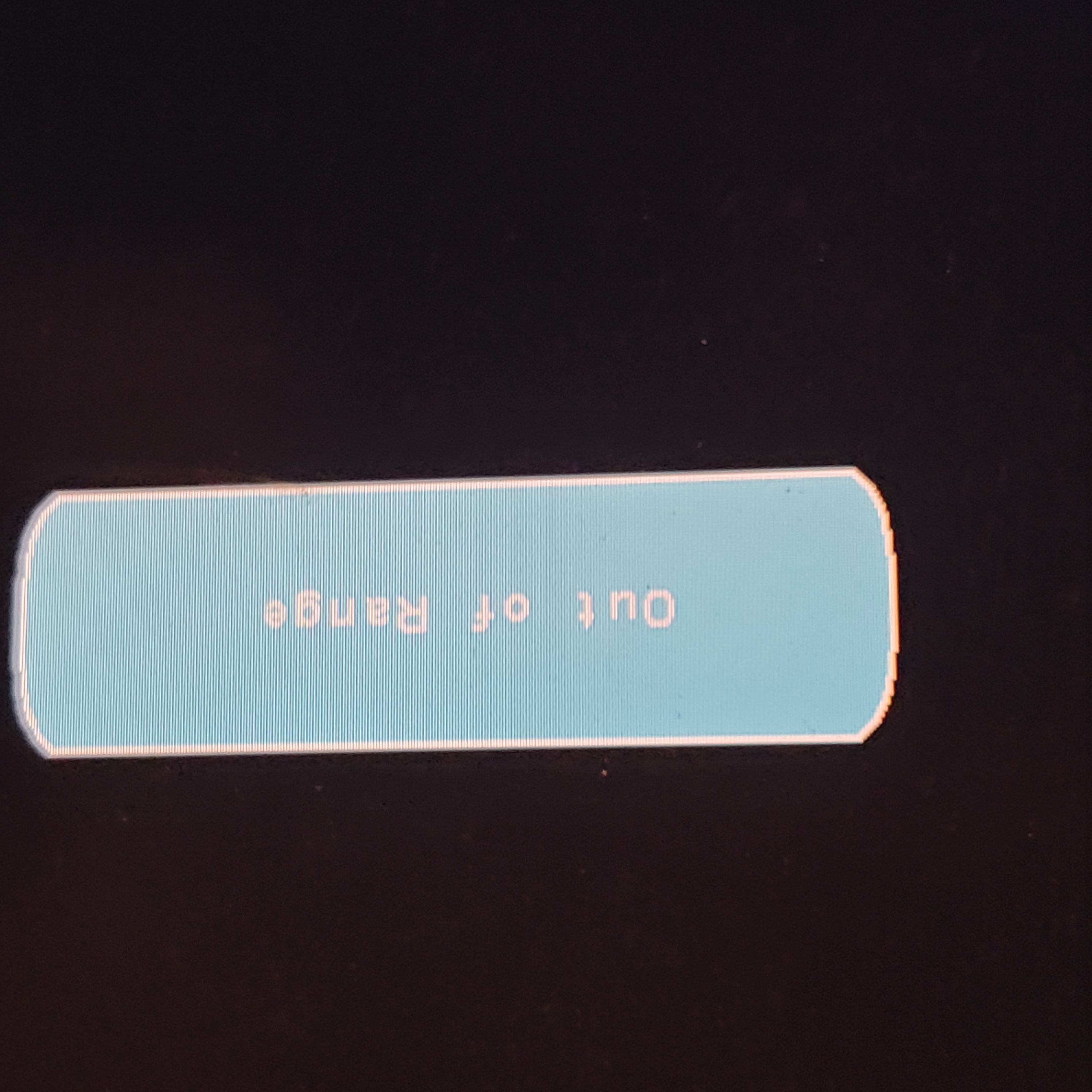

So I wanted to double check to make sure I wasn't out of my mind as I have so many different machines and as I said before some will work and other won't I setup my 4116E-HS that is the same as the OP listed hardware in Theory and setup for 3840x2160 and connected it to a Auto adjust Monitor that goes up to 1080p on DSUB and sure enough it gives me a out of range message.

Hey, when I get home I will connect the NVR to my computer with an ethernet cable and attempt to login to the NVR with it's IP. From there, I'll try to access the menu where I can change the resolution back to the default for HDMI.
That Out of Range indicator looks very familiar, as one of my monitors shows me that and another shows a box that explains I need to change my input.
