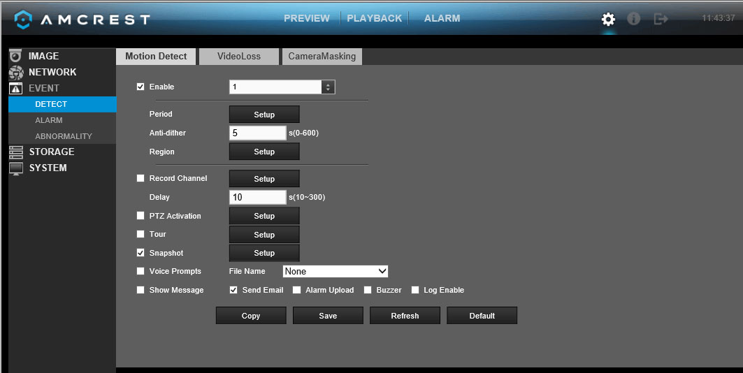

I have found that using the web interface to the NVR (via the NVR IP address in Internet Explorer) is much easier than using the direct interface (mouse and monitor). I am also using IE instead of Firefox since I had some issue with Firefox (I haven't tried Chrome or Safari).
I just confirmed that MD email notifications do work on my system. I have it set up, and you might try, one motion detection region for the entire image, Sensitivity 60 and Threshold 5. All other regions cleared. All detection settings on the "Motion Detect" tab are unchecked, except "Enable", "Snapshot", and "Send Email". That will take out the variables of multiple regions and sensitivity for this test.
Is yours set up similarly?
Mike
