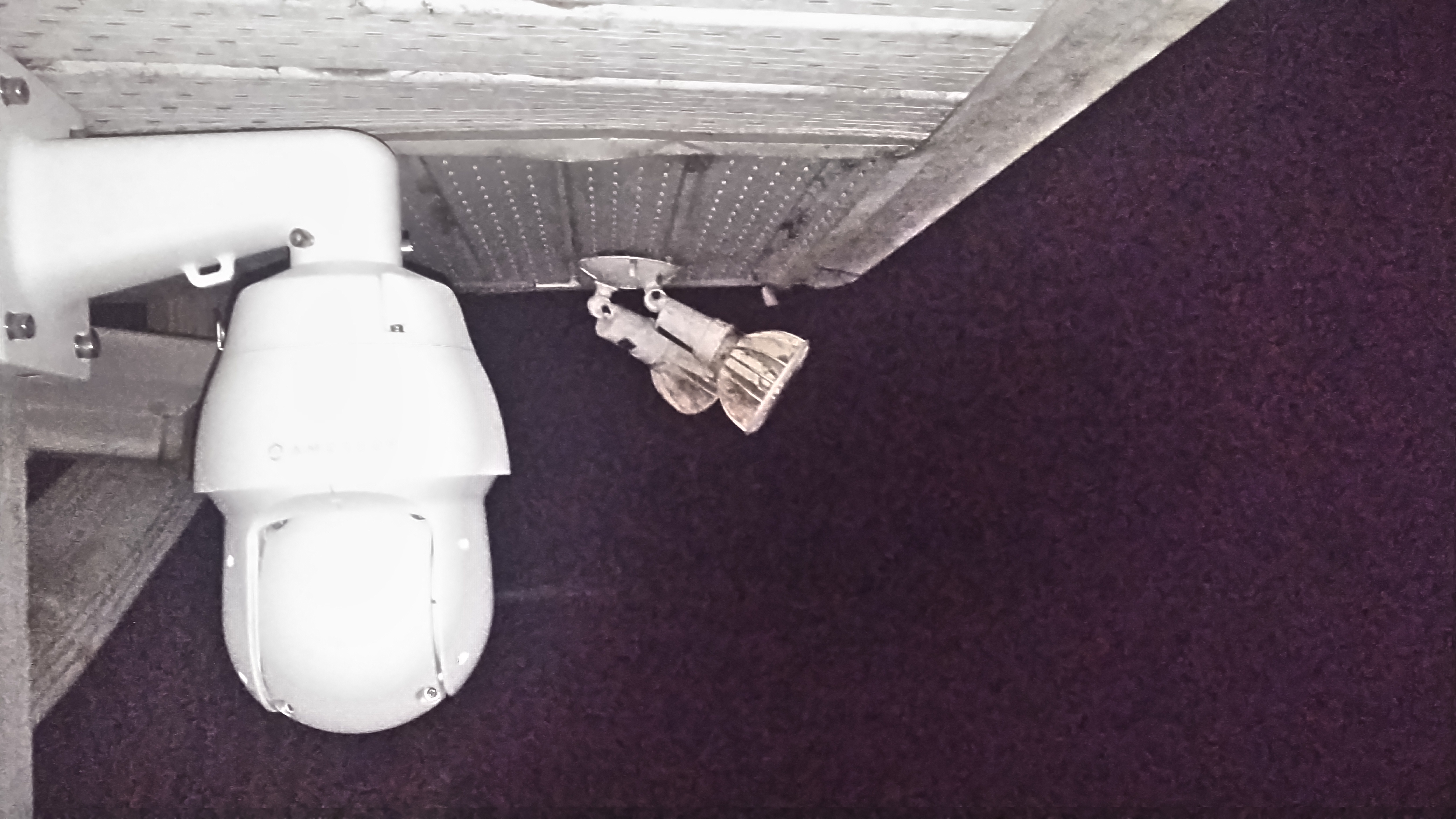

If the packaging of the -863 is necessary for the mechanicals inside, I dont see it fitting in a much smaller turret style. Plus, the lower profile on the turret would be a detriment in my application. I have the IP2M-863 AI V2 mounted on the corner of the house, to enable coverage of two sides and be sheltered. There are also floodlights and gutter downspout there. I went out and got a pic:
(ok, I am due for pressure wash and paint .I know. It is dry season here, and the time to do it. It is on the list.

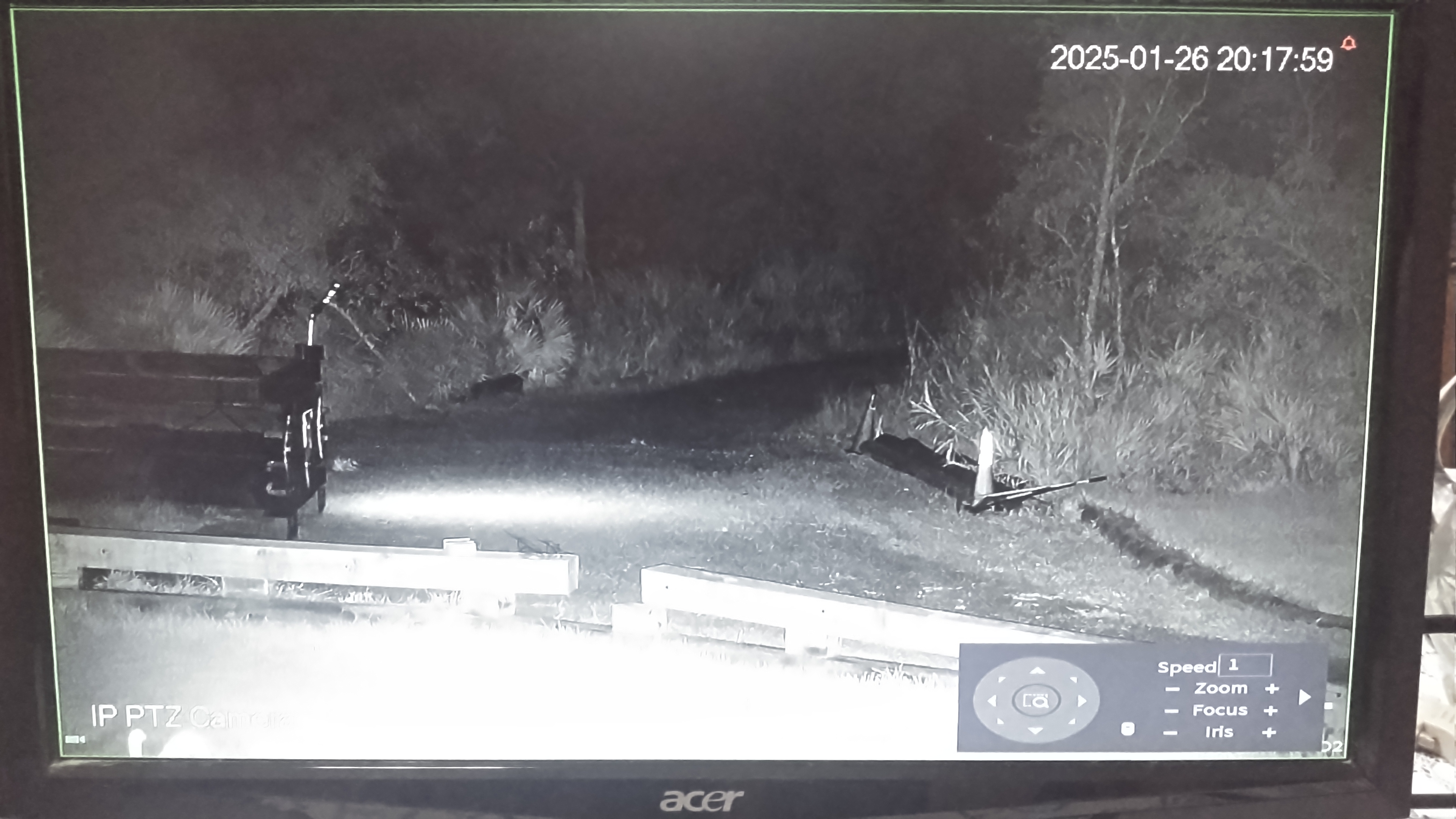

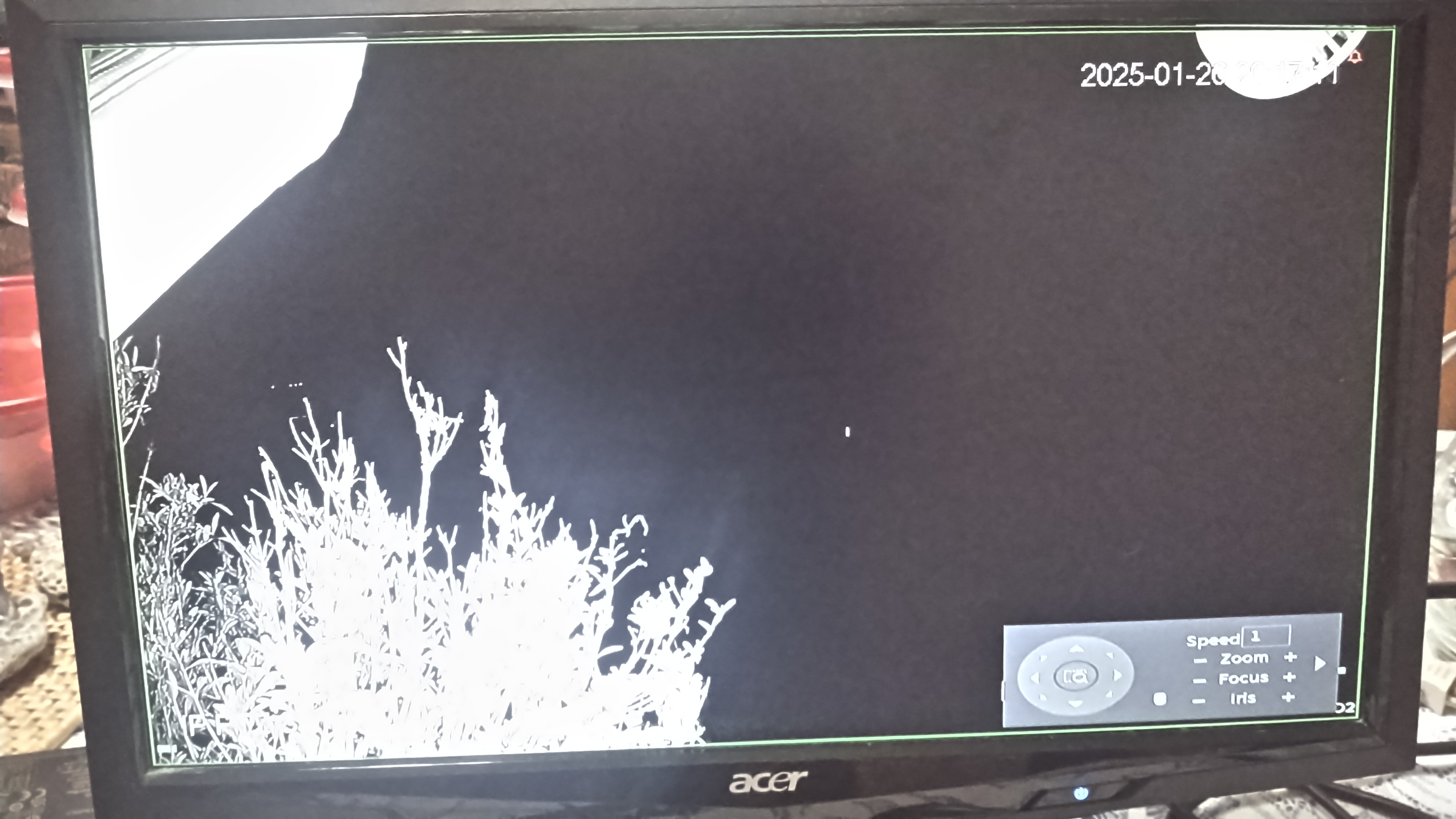

I would like a wider picture at night. The IR illuminator is AWESOME. But, on wide zoom at night, the lights and tree blow out the pic. The lens on the -843 is ~13" below the soffit, so just the bottom of the floods and downspout get in.
If this was a turret can, I would think the lens would be maybe 5-6" from the soffit, and get more interference.
See the dot to the right of the tree? thats the cone right of center in the next pic. The camera (in below pic) is 'zoomed in' JUST far enough to get the glare from the spotlights and gutter downspout out of the picture, allowing the iris to open and 'see' farther away.
If this was a turret cam, I would have to zoom in further, and lose field of view at night.
