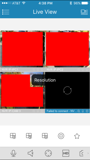

Actually that doesn't work. I have the same problem: I'm using the latest version of Amcrest View on my iPhone, and it defaults to the substream. If I don't have substream enabled on the cam, it fails to connect but does not provide the option to switch to HD (main stream). I click on the HD button and it shows a "Resolution" popup, but no option below to switch the stream.
On the other hand, if you have both streams enabled on the cam, you can switch back and forth between HD and SD but only once it has successfully connected to the substream.
Attached is a screenshot showing what I am talking about. This is a pretty significant defect in the software.

Yes, that is exactly what it does. It appears this may be a problem related to iOS 10. When I was first installing cameras I could use this app to aim the cameras. When I added more cameras I could not get the app to connect to the camera. I had to use the Android app instead. My phone updated to iOS 10 in between. Pressing HD does nothing more than bring up a message that says "Resolution".
