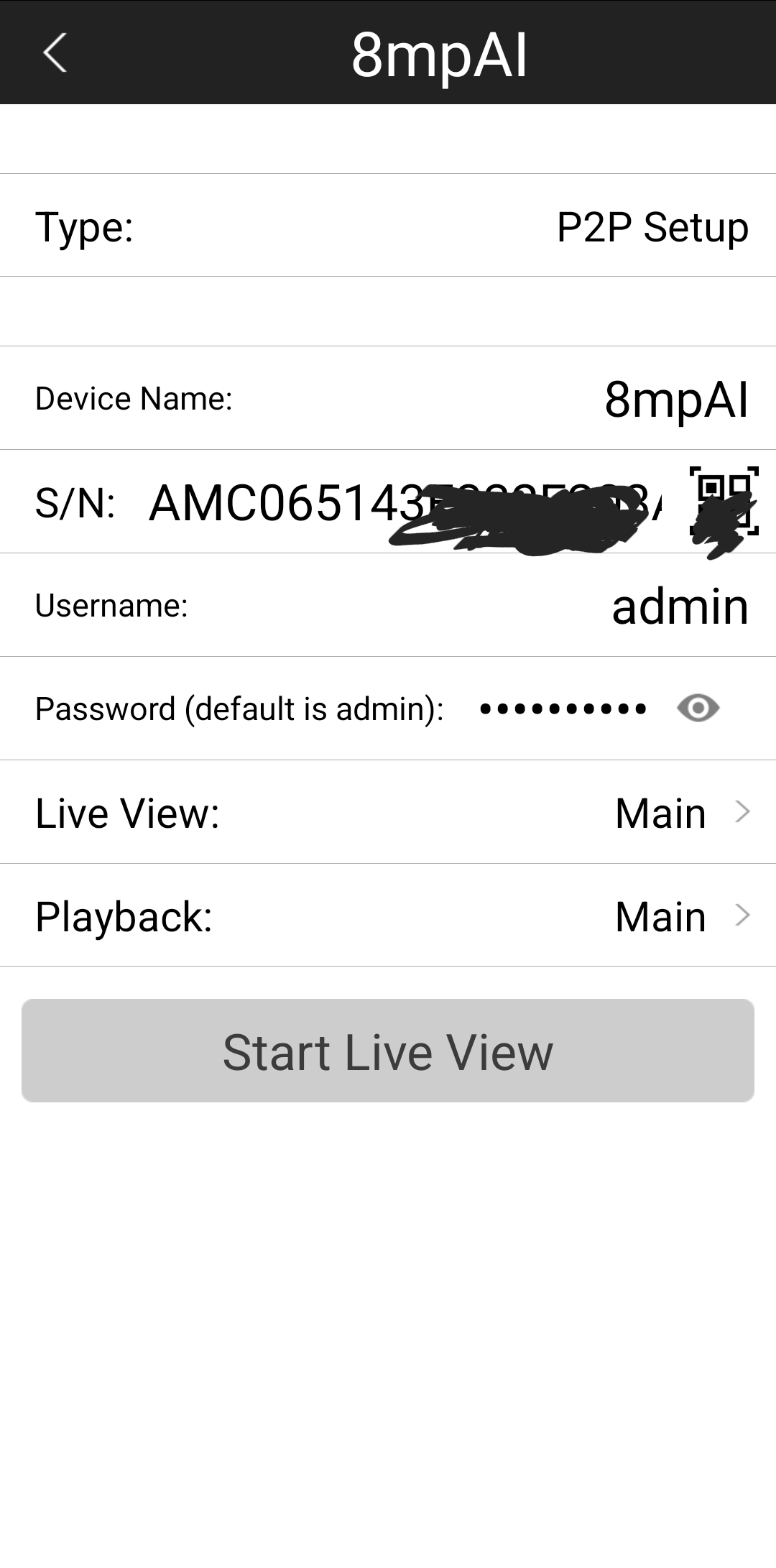

It sounds like you are watching Liveview on your phone app and then using the Recording icon to record a clip.
If so, the app default resolution is SD which is the Substream resolution and fps set up in your camera.  Use the Resolution icon on Liveview page to change from SD to HD resolution which is camera Mainstream that you say is set to 4K 20 fps.
Re: How to access 4k 20fps footage.
Yeah 2 things sorry mis understood the issue my 8mp camera is only 15fps so thought maybe trying to get more out of yours .
However what jack says works for the session you would be better off pressing the left top 3 lines w 3 dots then device manager then the camera you want then the pencil then at the bottom change from Extra for both display and playback to Main and then click Start Live view to save changes looks like picture below
Screenshot_20220725-003234_Amcrest View Pro.jpg (187.99 KiB) Viewed 7298 times
