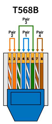

Took a few reads, but I think I understand. Using this picture as a reference:
One basically only populates the orange and blue pairs in the connector, keeping the others aside for power duties.
IE:
Pin1 - Orange/white
Pin2 - Orange
Pin3 - EMPTY
Pin4 - Blue
Pin5 - Blue/White
Pin6 -EMPTY
Pin7 - EMPTY
Pin8 -EMPTY
Then connect Green and Green/White together, and use for negative lead.
Then Connect Brown, and Brown/White together, use for positive lead.

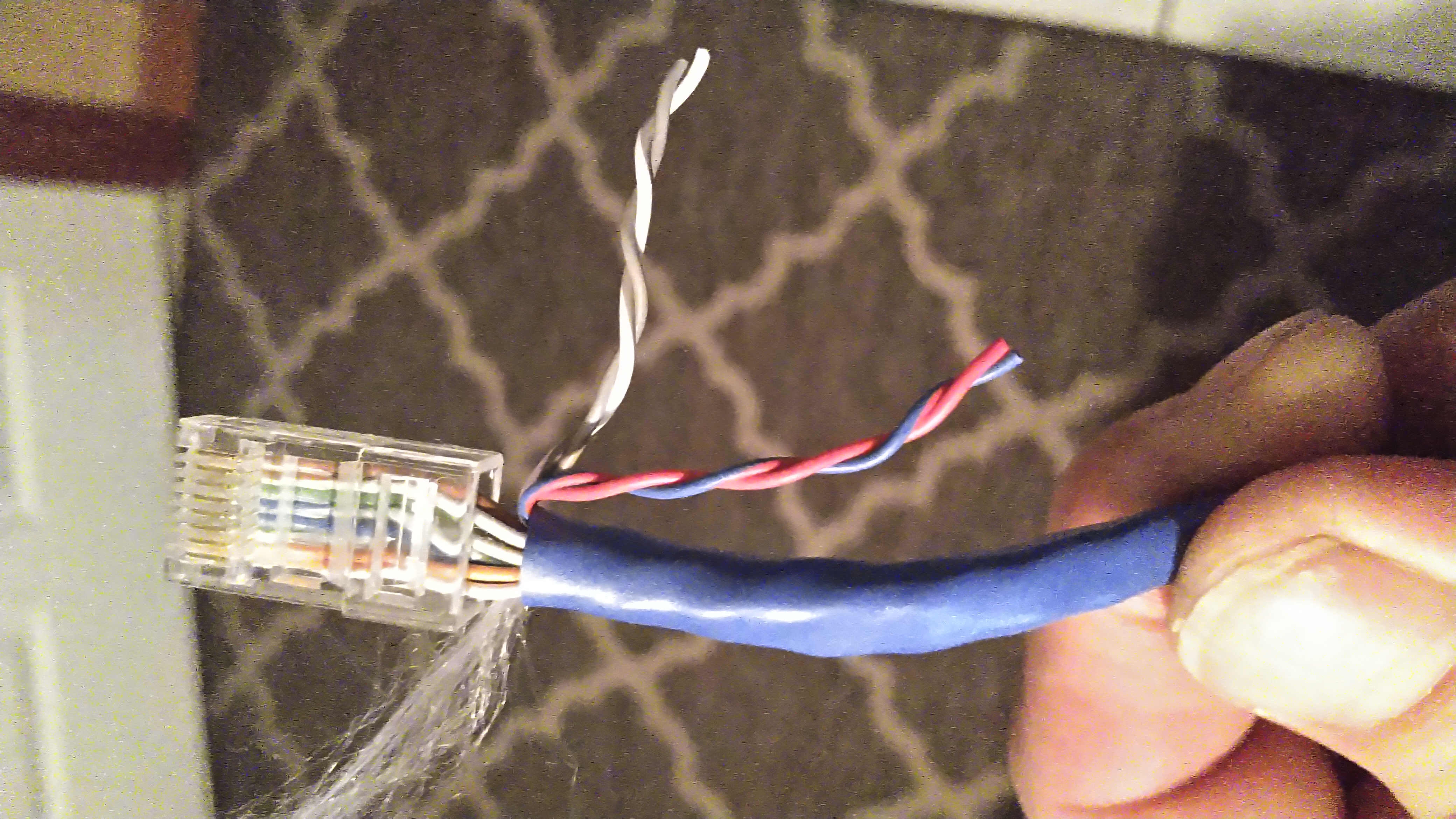

I was fortunate to be wiring an office complex some years back, and the builder spec'd 6 Pair cat5E cable. I thought it was pretty neat stuff, so I ordered a couple reels for myself. Pretty much every new run has it now, and it has made several 'Impossible' things happen.
BUT... your method of using existing 4 pair cat5..... That's one for the 'toolbox'.

Of course, that 'One More Thought'.....
Using your method, and my 6 pair wire....
Can I set it up with TWO RJ45 ends? and still have two pair for power?
IE:
Orange and blue pairs in one RJ45.
Brown and Green pairs (populating pins 1,2,4 and 5) on another.
and use my funky Red/DkBlue and Grey/White pairs for power?
Realizing the power would likely be limited, SHOULD be able to coax ~1A @ 12V with under 4% loss over the max 100M run. If I did my math right... Might be really good for adding some network sensors by an existing camera, or 2 low demand cameras. NO PTZ, spotlights, etc.
Looks good on paper... Opinion?? Not sure if there are barriers to this I am unaware of.
Thanks again.

Normally 1, 2, 3 and 6 is what you need for POE.. Then setting up 2 Eithernet RJ45 ends with same pin out on both ends you can power 2 POE cameras from 1 cable that I have shown in a video in the past. https://youtu.be/URS1q_w-nD0
Re: Had someone ask me if they could power camera without POE
GOTCHA!
Watched the video, at least 3:01 for now. Subscribed. I came to post about my new NVR, and came here first. Will complete it later on.
My diagram up there is incorrect.
I was just removing the colors, and did not follow the color,color,empty,empty...correctly in your initial post.
1,2,3 and 6.
I have 1,2,4 and 5 populated.
Looks pretty though.
And too late to edit.
Any way you can reset that so I can correct it?
Thats a really new trick to me. Thanks again. I was using 2 wires on two cams to do the static cam/ptz cam duo you describe in the video. I have some older Axis 221's , like 30 of them. I was going to use them for the spotters, and they are POE.

Just note Not all cameras will work with the 1,2,3 and 6 method. Some cameras wanted to work outside the norm and using the 4,5 and 7,8 to power the camera with the others just for data.. Because they wanted to be special lol.. Not sure if Axis is one of them or not. I have not used mine in an area where I had 2 cameras going..
Once again....I am like .... WHAT? Isn't there a standard requirement?!?Revo2Maxx wrote: ↑Thu Jan 23, 2025 3:44 am Just note Not all cameras will work with the 1,2,3 and 6 method. Some cameras wanted to work outside the norm and using the 4,5 and 7,8 to power the camera with the others just for data.. Because they wanted to be special lol.. Not sure if Axis is one of them or not. I have not used mine in an area where I had 2 cameras going..
There is.
""In 1999, both the IEEE and the Ethernet Alliance started working to standardize PoE to ensure interoperability across a broader range of connected powered devices and power sourcing equipment. The first of these standards, IEEE 802.3af, was ratified in 2003 and specified that the power must be able to be carried by either spare pairs (pins 4 and 5 or pins 7 and 8) or data pairs (pins 1 and 2 or pins 3 and 6).""
