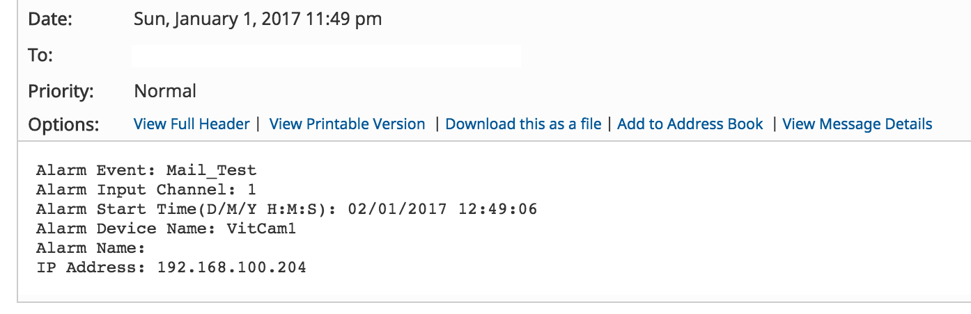

I am providing this image so you can see it as well --
The Body of the email shows the correct date and time of 1/2/2017 12:49:06 (although, not in the date format I set). However the Date on the email shows 1/1/2017 11:49pm
Screen Shot 2017-01-02 at 12.50.13 PM.png (77.52 KiB) Viewed 754 times

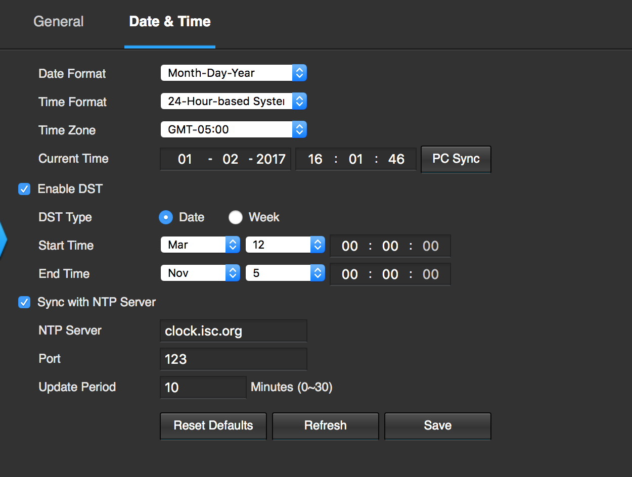

I am also attaching the settings I have on the camera to show I am set correctly:
Screen Shot 2017-01-02 at 4.01.45 PM.png (140.59 KiB) Viewed 754 times
2 Issues I see:
1. The Date / Time of the email is not correct
2. The format in the body of the email does not match the format which I selected as indicated above.
The imprint on the video image in the email does show correctly including the format
Thanks
