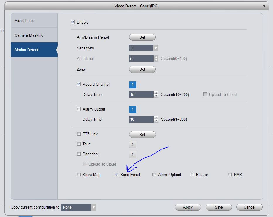

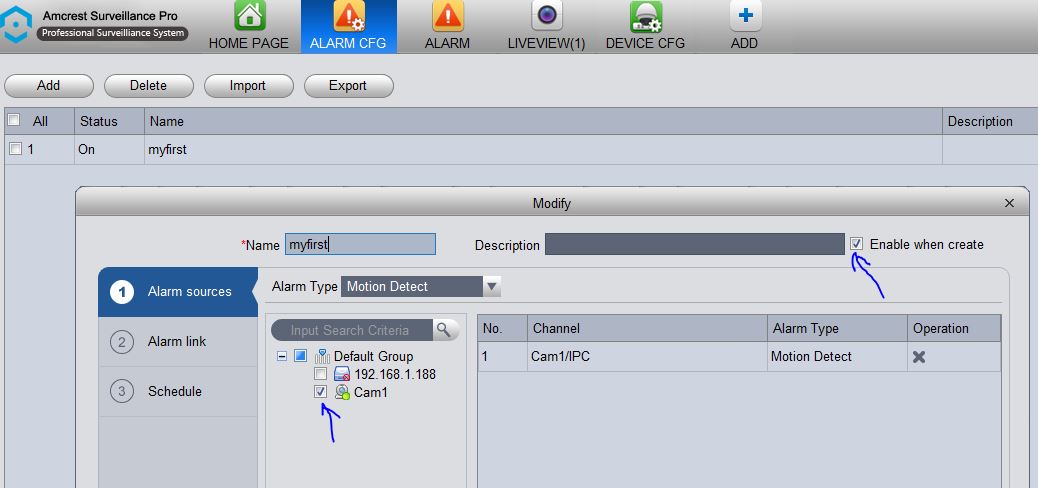

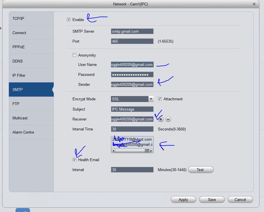

Re: Email alerts no longer sending
The software works fine, their are three different places to set to make the mail or text sms work. Both work on all the software versions I have used. I use amcrest view pro most of the time. This shit is a tangled mess to figure out. But the stuff does work fine, just a pain to figure out how.
My mail would quit and then I would find a seemingly un associated setting turn it back on and back in action.
If I change any one of these my mail and text quits.
- stepone.JPG (63.99 KiB) Viewed 2672 times
- step3.JPG (68.77 KiB) Viewed 2672 times
- step2.JPG (70.83 KiB) Viewed 2672 times
