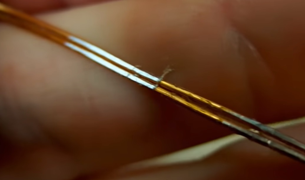

Looking into the Transformer that is in the thing and it has CCA wires and not real copper wires that normal transformers are wound with. Outside of that the Inductor also has CCA wiring WOW how can people really sell these things... Taking the Transformer apart down to the last primary winding a few things I seen on the way to that point was the Isolation was melted and the color of seeing it had been hot.. So once I unwound that winding the reason it died is because the lacquer had melted away doing so caused a really high voltage and current that killed the Diode and Transistor. Then even though the Power supply has a Mains Fuse that fuse was still good even though it shorted out to mains and popped his breaker..

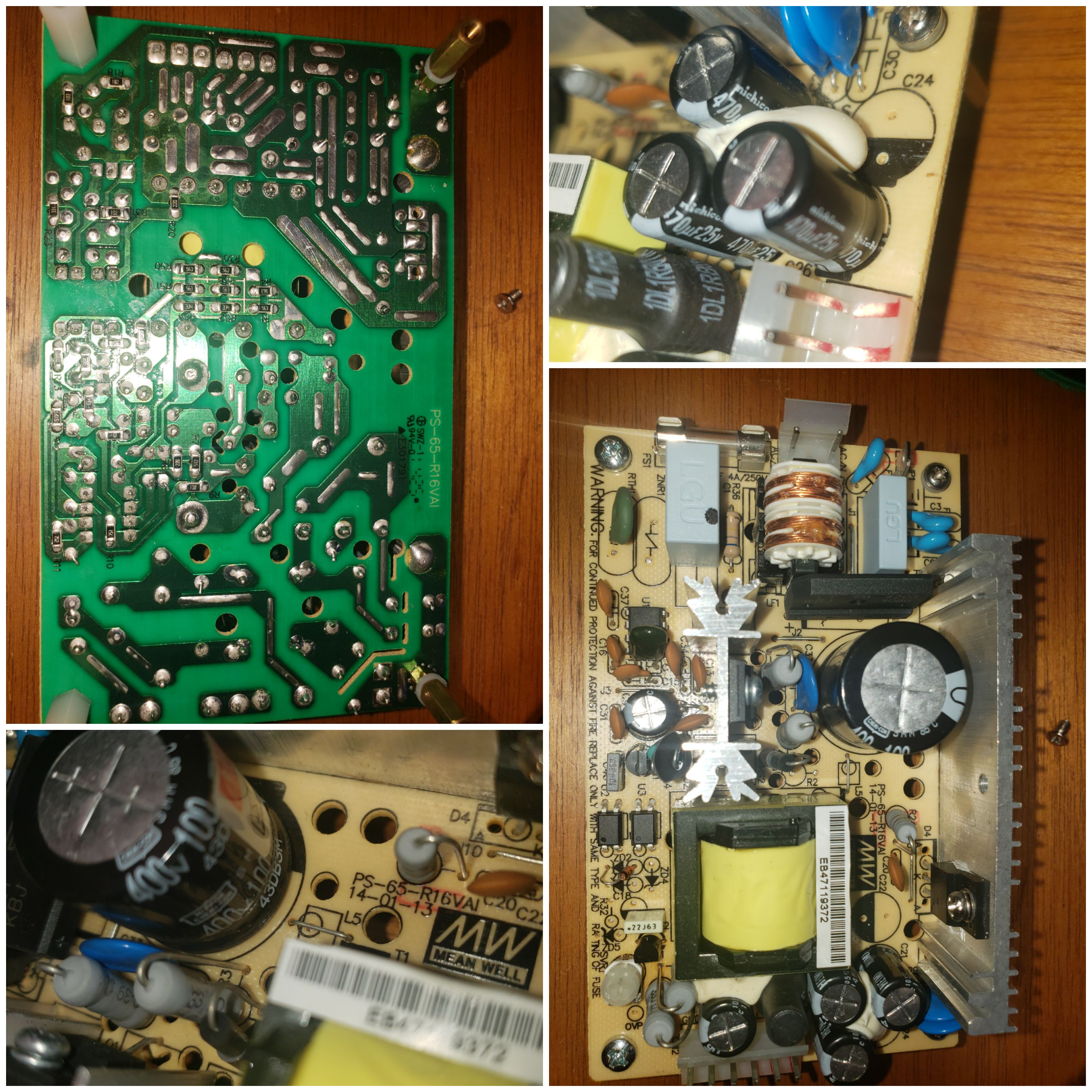

So I thought I would post a picture of what one of the Boards in one of my PDU's looks like.. Now this is one is a Mean Well unit and you can tell from this unit that even though the PCB looks to be designed for more then this unit seeing there are parts that are not in the PCB this is by design.. The Caps in the unit are very good and have been working well in this unit since 2013.. They are Nichicon Capacitor There is no cheap used parts like I have found in some other power supplies that come from questionable areas.. This is just one of a Good Few that I own.
Even though this is only a 4amp power supply it works well for the cameras I use it with.
