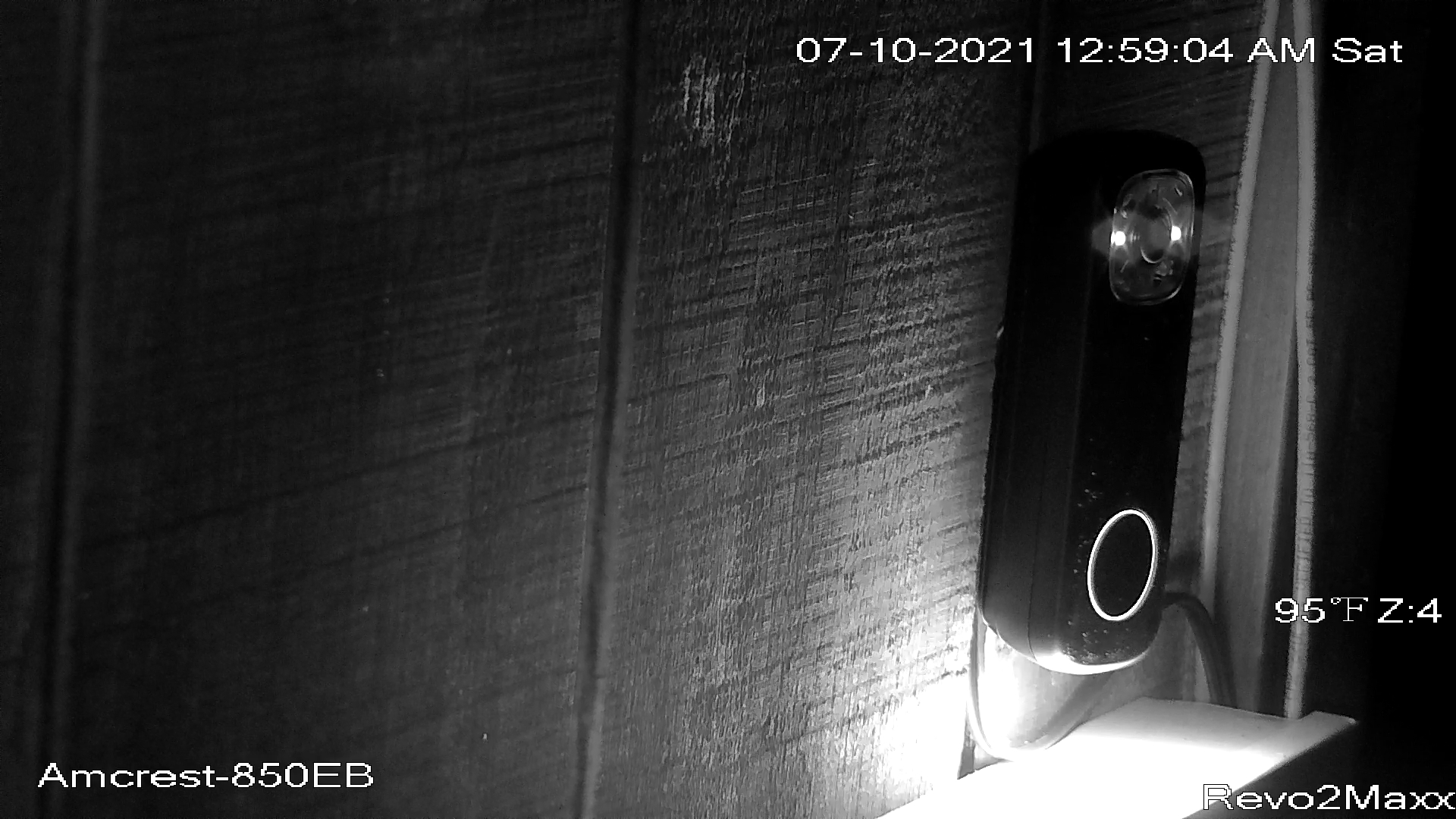

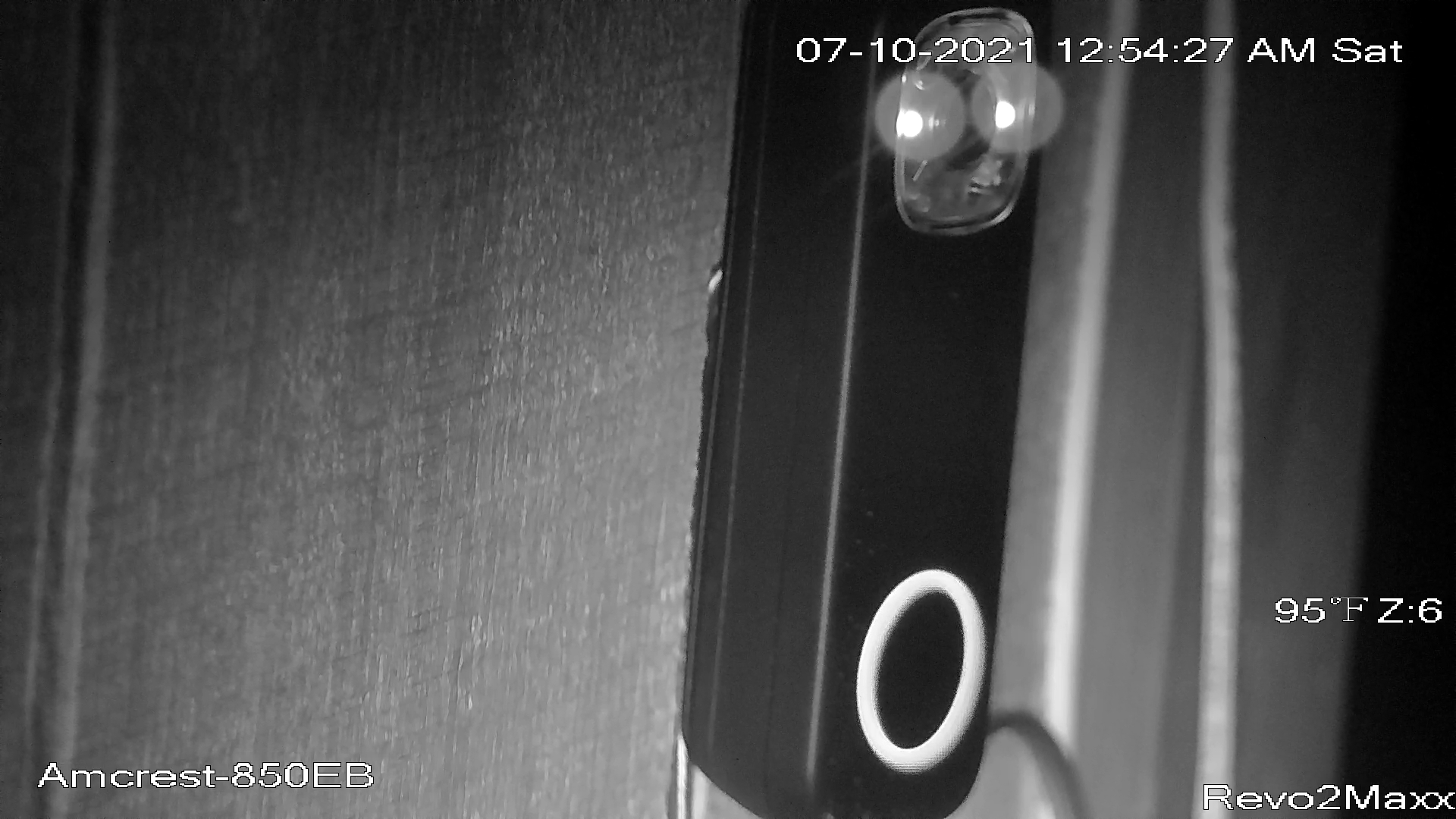

So far I have tested the camera with light coming on with motion not sure I like it. I do have it in an area that isn't well lit However there are at this time 5 cameras in that area that are working in Night IR mode and 2 cameras in the area that are Color at night mode.. One thing I wish this would do I am sure there is a CGI I could run to make it happen I have not looked up any at this time for it, But I wish it would run B/W with IR off turning off the IR will make the camera color.. I run the 1 camera facing in almost same direction as the doorbell in color however light is off. The other color camera in the area is around 40 degrees out of the field of view and I do use that LED at night seeing it is an Analog 1080p camera with 2 light options with light off not an option.
This picture is with the LED on the Doorbell

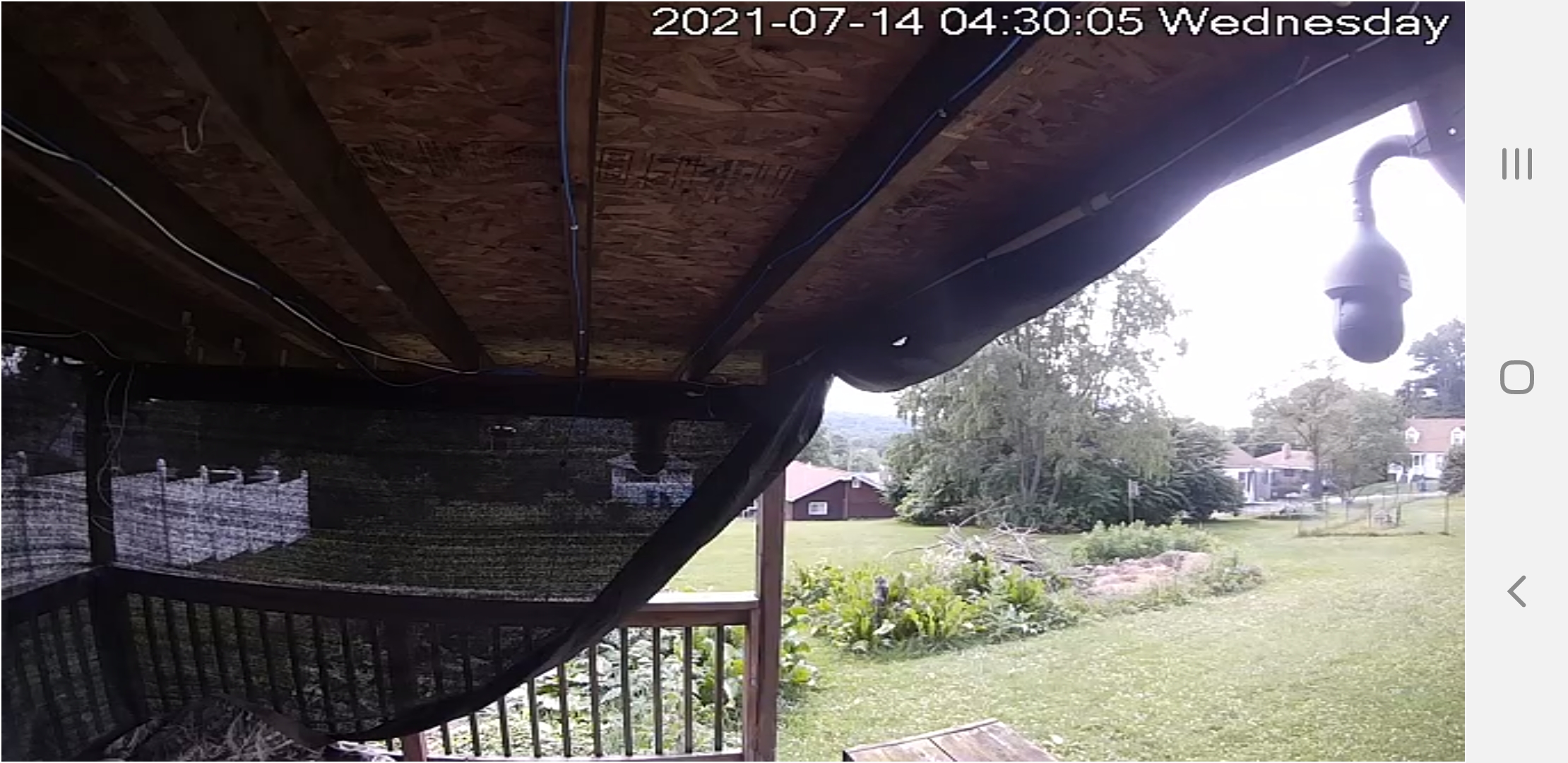

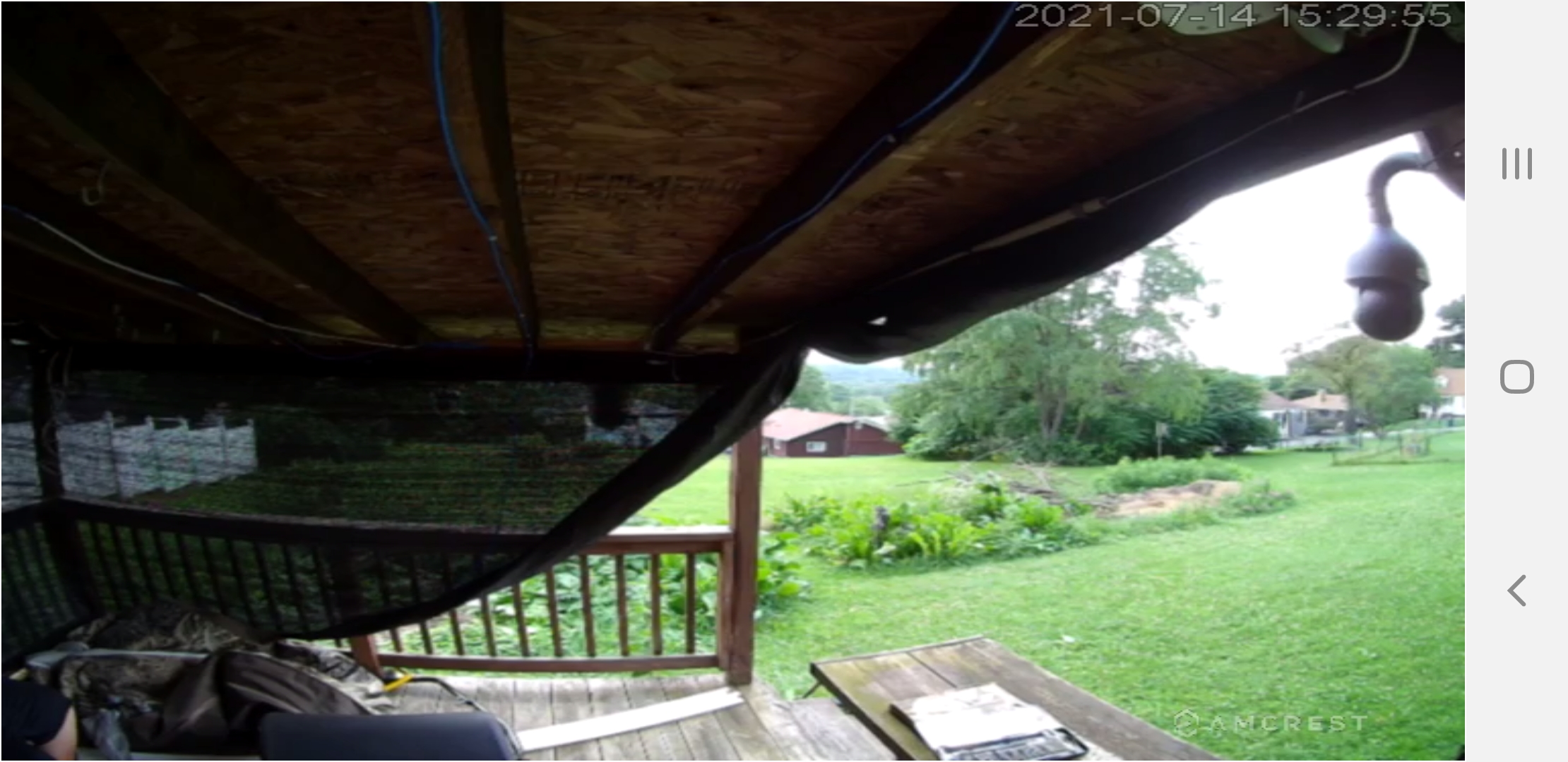

Side by side Ad110 and Ad410
Screenshot_20210714-163007_Amcrest Smart Home.jpg (967.34 KiB) Viewed 7668 times
Screenshot_20210714-162955_Amcrest Smart Home.jpg (832.71 KiB) Viewed 7668 times
Re: Breaking down buying the AD410
So I uploaded this from my phone and didn't really look at the quality of pictures but looking now it seems that the 4mp is in SD and guess I have not fixed the time another thing I didn't look at seeing it is so dim and even though it was overcast it was bright out and couldn't see well enough. Tomorrow I will make sure to change both to HD and take a the pair of Pictures again.. It is my Guess looking at the pictures now that they had to be in SD.. One of the things I am sure I already mentioned is Wish the Water Mark could be removed on the 410
