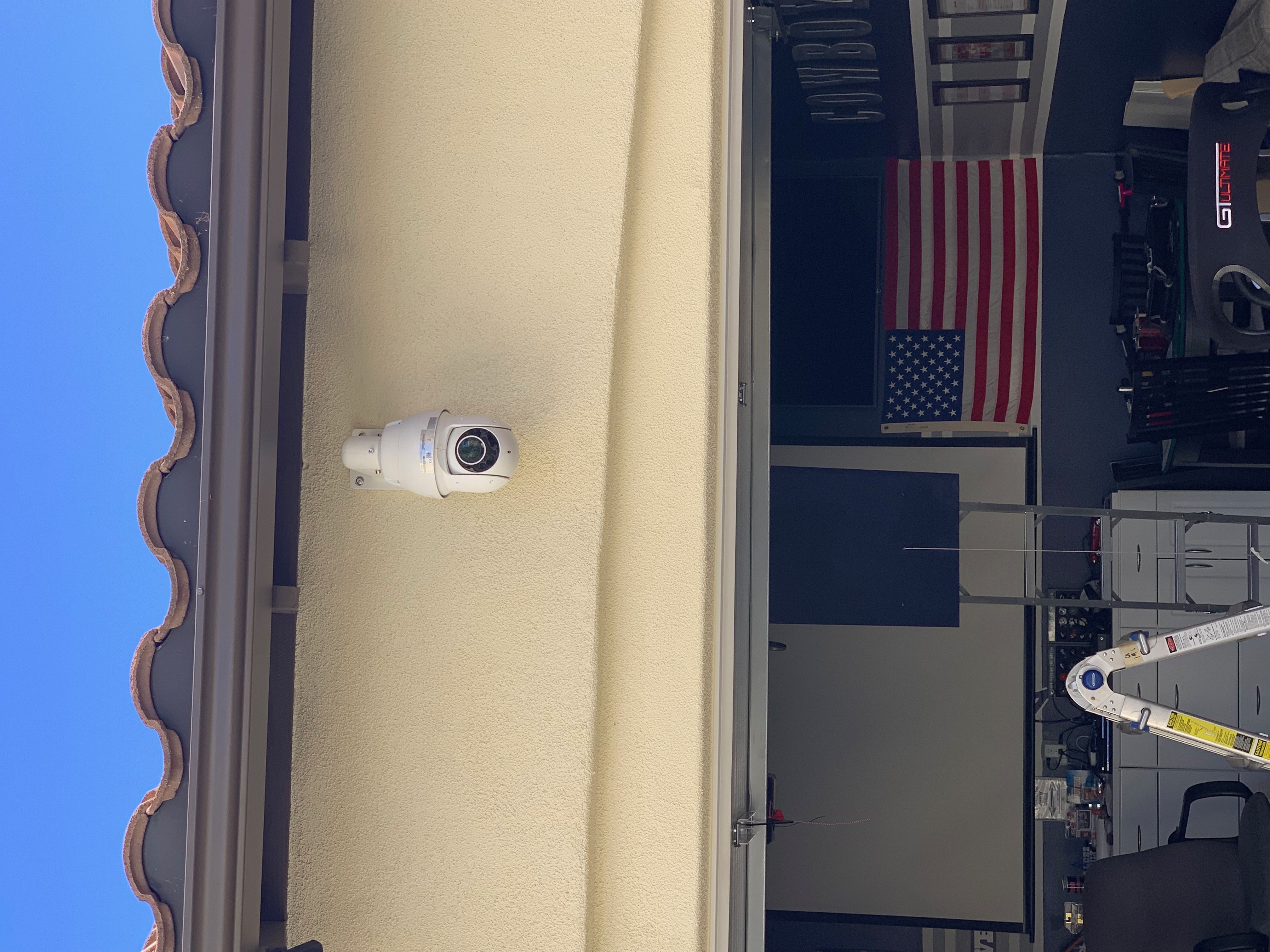

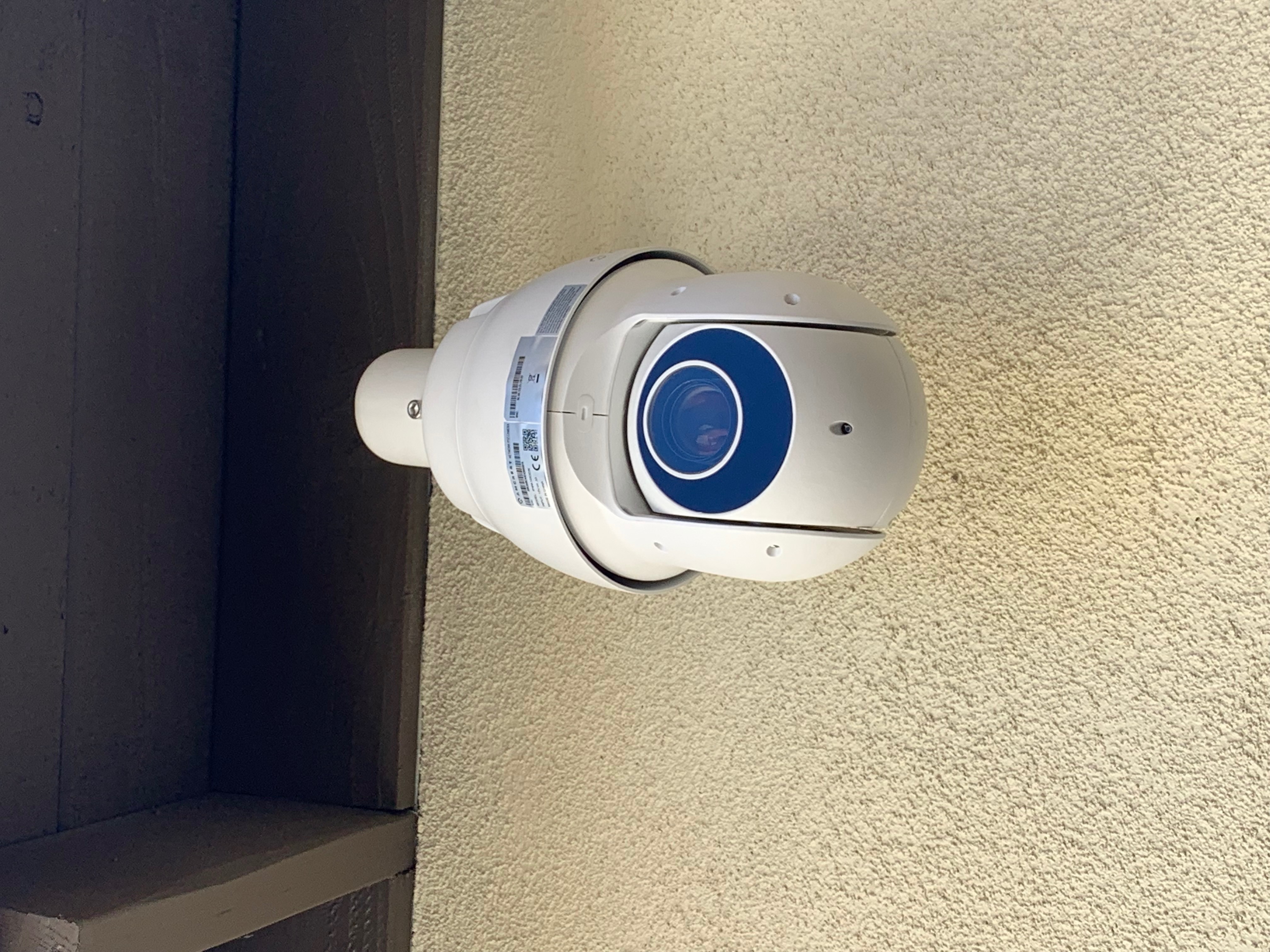

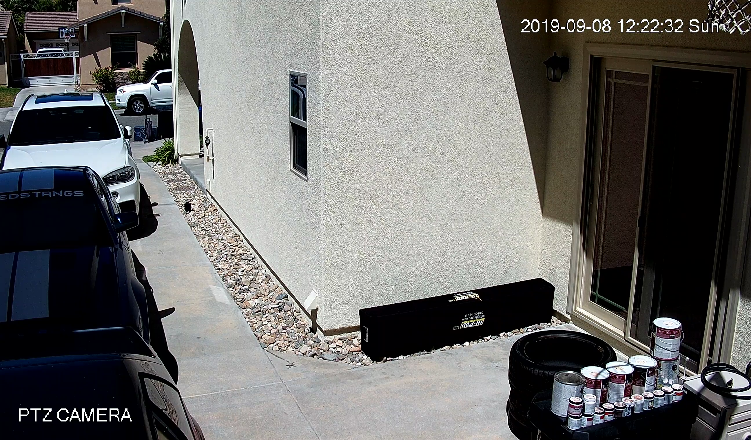

Everyone thanks for the help Camera went up fast and easy and looks pretty good.
DVR_PTZ CAMERA_main_20190908132233.jpg (2.65 MiB) Viewed 1936 times

Any recommended settings?
Re: Amcrest 4MP PTZ IP4M-1053EW ???
Congrats on your New Camera. It looks very good where you have it mounted. Important thing is that your happy with it and works for your use. I would maybe post some Night Pictures as well...
Then once you get things setup I would maybe if there is enough light set it for Color at night as well. If there isn't enough light at your location then keep it in normal night mode.
I like it Congrats again...
