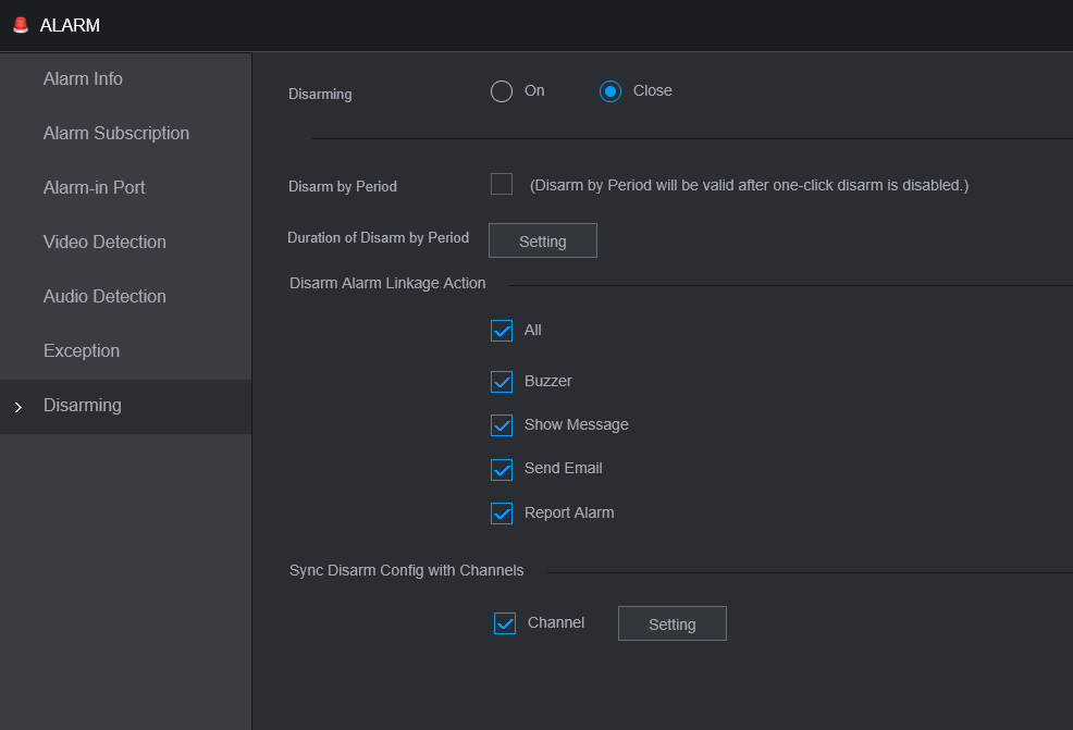

Oddly enough I have a few Dahua devices with the feature. There was also something added little while ago that might be useful seeing you said you have loads of these cameras and that was Sync Alarm config with channels. this was a great addition in the FW and seems not all my devices have the feature. The ones that do lets me access the disarming by channels and isn't system wide. Lets say you have a camera on a Vault or something you never want to have the alarm turned off for you click that button and choose the channels you want to work with Disarm.
Screenshot (822).png (30.33 KiB) Viewed 12846 times
