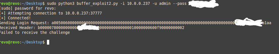

Re: 8mp HD analog camera better then loads of other IP 8MP cameras
Anyway rewrote the script to work with python3 and after running it the camera returned Failed to receive the challenge and this means that it in fact is safe from that type of trolling..
I have spent a long time messing with different scripts and tested on all devices that I own and so far everything comes back that my devices are secure from all the different pen testing I have done on them.
Trust me if there was something I would have found I would have reported it to Amcrest for review and repair.. I have pointed out a few different things that I have found as something I call a Flaw.

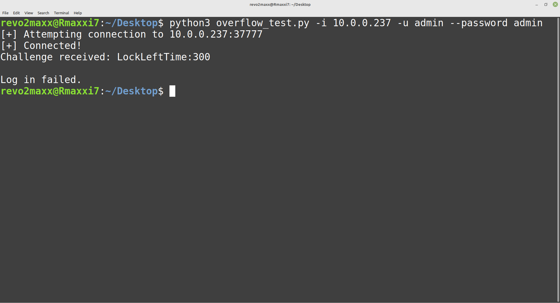

@sdDave So I rewrote the scrip again, While most of it is same code I added in a few different things that I thought might change. I have tested this on older and newer Amcrest cameras and all with mostly the same results. Because I wasn't getting any debug info back I added in different ways to data to be returned. Because I don't want someone to decode this I did cross out some of the info as before..
Also wanted to clear something up that others keep saying, that isn't true. I said it was not true before, However here is proof that it isn't true. Even trying to access the Port37777 it has been stated that you won't get locked out well here is proof that you will
first part here is from normal running with correct password.
[+] Attempting connection to 10.0.0.237:37777
[+] Connected!
Received empty challenge
Header: b'\xb0\x00\x00x\x00\x00\x00\x00\x01\x00\x01\x003\x00\x00\x00\x00\x00\x00\x00\x01\x00\x00\x00\x06\x00\xf1\x00\x00\x00\x00\x02'
picture is being locked out of the camera..

Also wrote a few other scripts that I have used on some other camera that I won't buy or use lol. When trying to run the script on my Amcrest cameras I get locked out, Running on Dahua cameras I get data back on a couple of them with errors in the scripts on the camera. Not all of them. Some are locked out even when using the right passwords others give back errors. These types are different and have some extras installed in my Linux machine for running them and even that isn't enough to gain access..

What is funny is even though that lock out was shown after running the script it did say that the lock out time was 0 and I was able to log in using my Browser. The other script I ran did lock me out for 300 seconds. AKA 5min for those following along..
