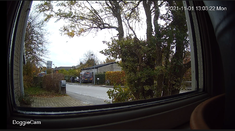

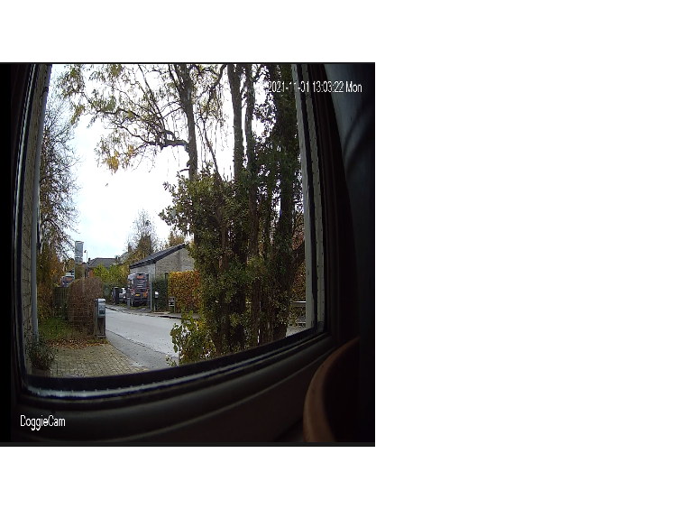

I have attached a couple of screenshots og the image problem in Amcrest View Pro to visualize what I mean.
In short, Amcrest View Pro will (in portrair/upright) mode of the Android phone force the stream into the square image viewport in the app.
When I then turn/tilt the mobile to landscape mode, it suddenly decides that display changed and will then show the correctly formatted&ratio image in what looks like 16:9 format.
The free app always shows the stream from Amcrest device in correct 16:9 format. (Yes I do realize that any app that asks us for login is a threat if we don't trust the developers - which is why I've logged a ticket with Amcrest Support who asked me to show a thread here as well ;) )

I have exactly the same issue. The image has incorrect aspect ratio in both the portrait and the landscape mode. It is narrower than normal in the first case and it is wider than normal in the second case. There is no point to change the view type as suggested above in the thread. It is the phone app who distorts the image. The same steam looks normal on my computer, and even in the Amcrest cloud app. Looks like this phone app was written for the older phones that have 16:9 aspect ratio while modern phones have 19.5:9 screens. This is kind of frustrating because otherwise I would prefer using this app when I am at home. I wonder if Amcrest has any plans on fixing it.

my understanding of this is that the app defaults to stretch regardless of orientation and the view box is set to a static size.
I wish they would have modified it to generate the proper aspect ratio as well. but the app hasn't been updated since december 2020 (1 year and 1 month ago)
