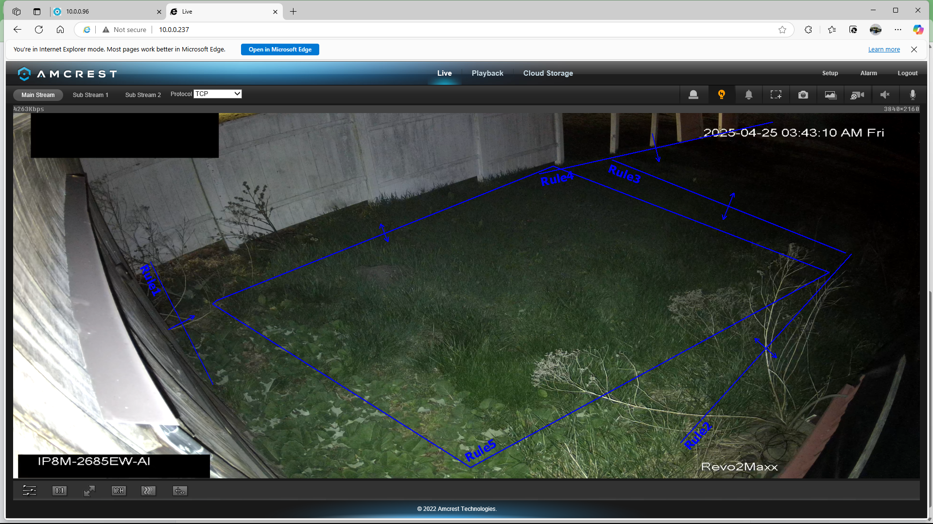

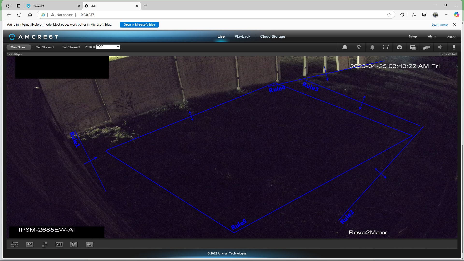

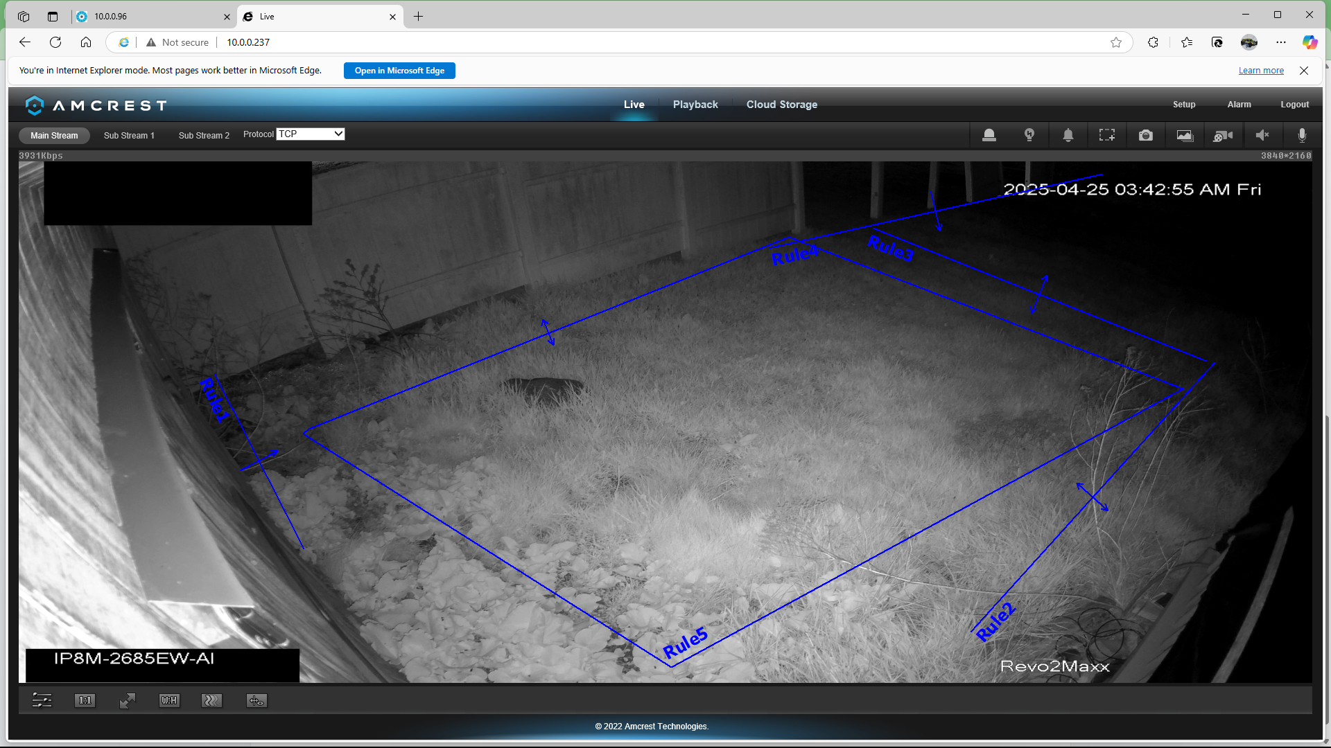

Re: IP5M-T1277EB-AI - Night vision LED visible?
So that is something I am not 100% sure about. I say this because I have cameras that work one way and some others that work another way..
So what I do know is that it has IR, This tells me that it can work like this camera in the pictures below.. However the camera below is an Active Detturent camera and this can be setup with turning on the lights full time on an event or flash them..
So what I don't know is if that camera has the ability to turn off the White Led on event. Some are setup that way period. Others you can setup like mine, others camera is you pick IR or White LEds.. So it is not clear how the 1277 works unless someone that has one can say one way or another.. added in another picture without light as this don't have the best sensor but camera works well..
