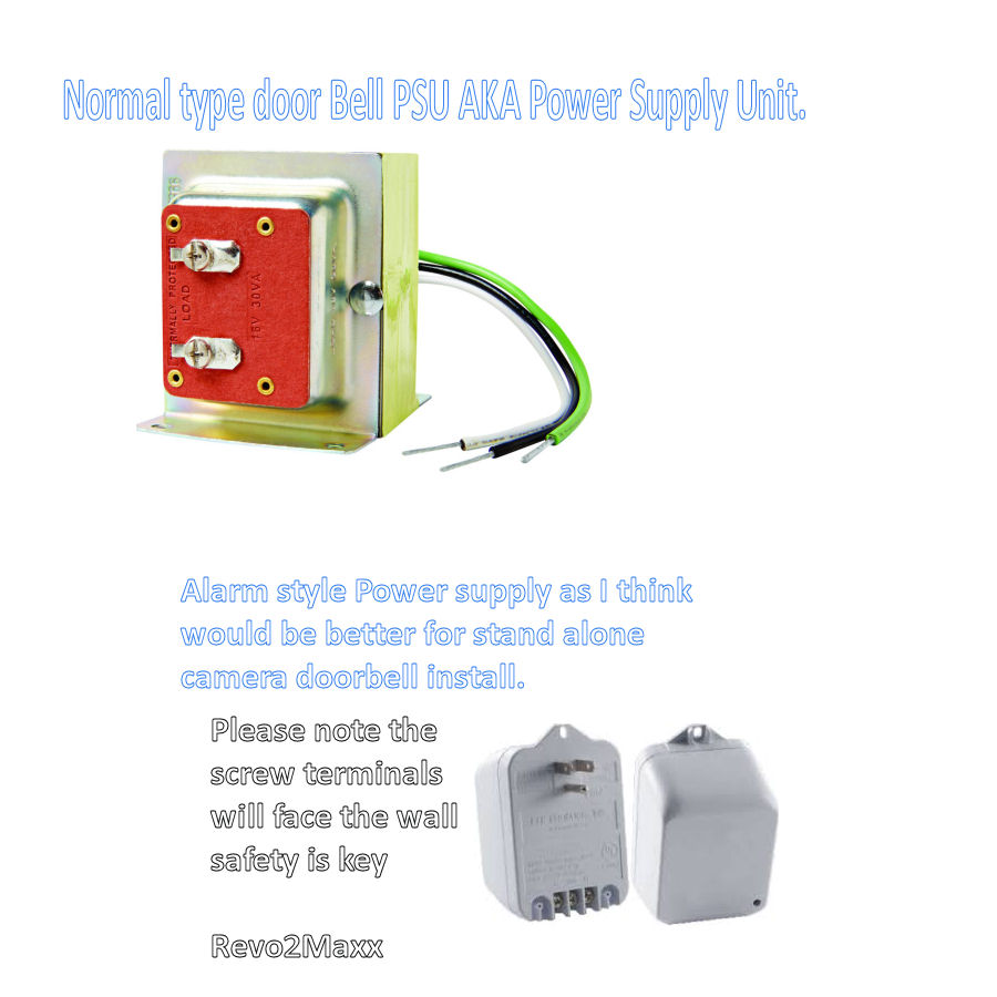

Here is what you will need...
First you will need a Power Supply. This is going to be a 16 to 24vac and might be the hardest thing to find... To be safe I would look for a Alarm Power Supply as it will be the easiest for a stand alone. You would plug this into wall after connection of 2 wires that you will drill a hole out to the outside for your Amcrest doorbell camera... It will be a big brick 24vac PSU with a Screw hole to make sure it don't fall out of the outlet you connect it too...
Some 18ga wire, Don't have to be the Special type just normal will be fine.
Drill bit large enough and long enough to go from inside your house to the outside
I would also get a Cover for the PSU that will make it so no one is tempted to play with it seeing most times they are installed in a Alarm Closet or other out of the way area out of sight out of mind.

Just for kicks I would maybe Call Amcrest and ask them if there is any flaw in the design like with others that I would assume don't have Over Voltage or Current protection built in. Make sure you tell them the Type of PSU your using because that does have some extra parts it in that would or could help protect over voltage and I am going to guess seeing it is 300ma they must have a Chip that is regulated in the PSU you have... Like in my Picture I posted first time.. That is Raw Ac to AC and at times can have an issue in the second part of the photo like yours there are things inside that keep it a constant power even if there was a surge at the socket...
