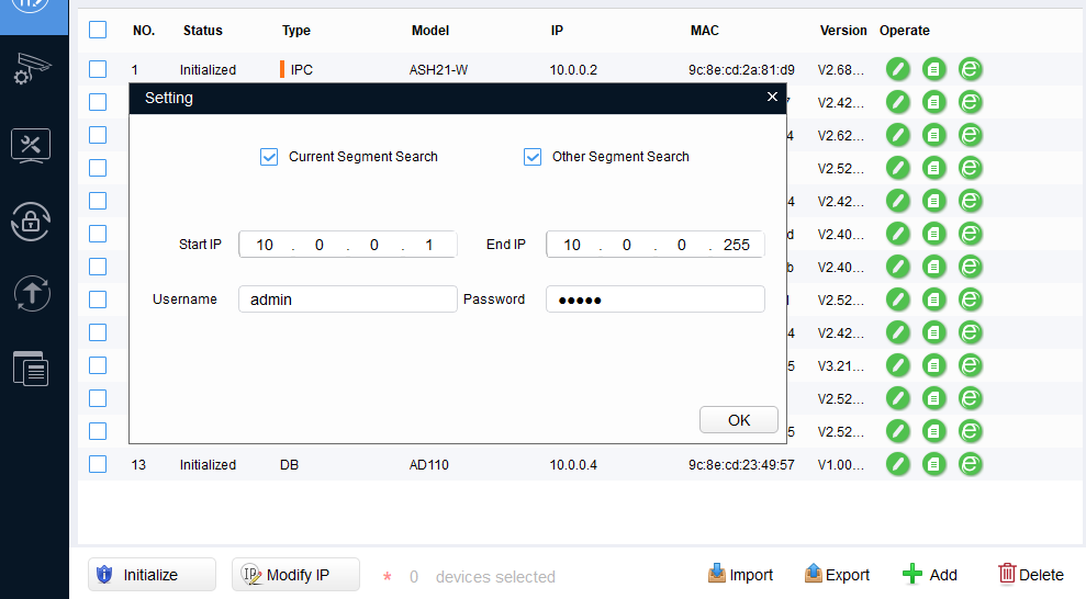

SO in other case why is all time problem for password with PC software "Amcrest ip config" this software working but if you installing "Amcrest View Pro" on cell android with same password, you return on PC Software "Amcrest ip config", password not working now, need all time camera reset (with foscma software and foscam camera , i dont have this problem)

Re: How disable audio (micro) on Amcrest camera
So I am clear, In the Audio area, IF you change from MIC to Line In that will turn off the Mic.. IF you set to mic as it normally is setup then there is sound.. Line in without a MIC plugged in no sound....
Not sure I understand what your asking about IP config...
First of all in the IP config you can plug in your Password if you didn't put one in I think it defaults to the OLD normal first setup of admin... So you go to Amcrest View Pro and setup a camera if you don't have the same Password that you installed the camera with in IP Config then it will not work...
SO you install camera on WebUI, then you went to IP config click on camera and pops up, Then you go and setup your Phones app and it tells you to Change Password if you haven't already so you put in New Password If that Password is different then the Password you setup your IP Config with then yes once you use your phone setup, then go back to Ip config it wouldn't work without changing it in your IP config (Understand??)
IF your saying that your Foscam transfers your new Password you setup on your app over to your PC software then there is a Issue and personally I wouldn't be using Foscam because that sounds like a way for someone inside your home to gain access to your cameras without then knowing your password.. Not going to happen in my home...

i am surpise because i installing inside Amcrest viewer pro with the same password inside my PC "Amcrest IP config" softwar, and now no password working in my PC , but ill checking with new reset

ok when i staring with reset, new password, said me : you need 8 character ! its my error, i writing in my file memory same passe word foscam (no need 8 character), the proble with password is resolved

OK, all problem is fixed, juste needed changing IP port inside my rooter for amcrest port setup
