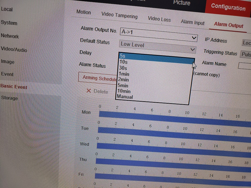

So I was thinking about some things about what I would really like to see... I know it can be done. For that matter I could really send some more cat 5 wire over to the Garage and connect to the out put of my TVI DVR. 20 Alarm outputs with the ability to manually turn it on. It also has 32 alarm inputs, Anyway the outputs can be set for N/O or N/C. There is some other things in there that I found interesting and gave me an idea of something to add as well...
So there is a Timer function built in my DVR and that made me think about some extra ideas on a Garage Door...
So to help with the False alerts on the door, You could have a Pressure switch or even a normal Alarm switch could be added to the door. Pressure switch would be as you would guess the bottom of the door and when the door closes it would put pressure on the switch turn a Open to a Close and this could tell the camera it was closed... If you used the Normal alarm switch, you would put it down in the closed part of the door. Door open Contact open and could tell the camera that has a Timer function because the last thing you want to do is have a bunch of alerts going off when you have your kids or Better half moving things in or out of the Garage like bikes car or mower.... However if the timer time expires then the alert is sent to your phone. YOu can then log in to your camera and confirm that the Door is open. If open press a button that would then make the door close...
However there are many ways I can expand this idea as well.... You are having a new System 4 large boxes from Amcrest sent to your home, Your not going to be home so you have instruction on the front door for Mail man to please deliver to the Garage. They press a Door bell button that is connected to Alarm input 2 of the Camera INput 1 is for door open switch... 2 is for Doorbell function. This then sends alert to your phone without delay and you can then view the doorbell camera at the Garage see it is them, Switch over to Garage Cam press the Door Button and open the Garage door and let the Mail man put in the Garage... Once they are out of the garage all while you watched form your phone... You press the Door button again and door closes and your NEW Amcrest system is inside secure waiting for you to come home. NO Porch PIRATE to steal it even though you will have it on your Porch cam still have to Report and deal with them maybe never catching them.... Sorry about Quality of this picture but the 10mb Snapshot was just to large for me to feel like I should upload it so this is now under 1mb
