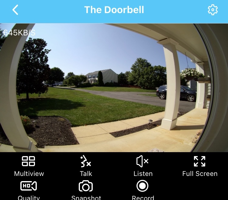

I recently bought the AD410, it's a good doorbell camera, but I am having one troublesome issue. Is there any way to decrease the edge rounding of the image on this camera? As you can see in the attachment the picture is very circular. I originally had a Nest Video Doorbell and did not have this problem, thanks.

That's called the fisheye effect, and it's due to the AD410's wider field of view (164 degrees) coupled with its 4:3 aspect ratio. This is by design to provide wider horizontal coverage. The SmartHome app has no means of fisheye digital correction but your enhancement request is a good one. BTW - the app also does not maintain a 4:3 aspect when displaying on your phone, but will stretch the image further to fit the screen's width, which is not desirable.
The Nest is designed with a narrower 145 degree field of view but with a flipped 3:4 aspect ratio which is nice to see a more top to bottom person/package view.
