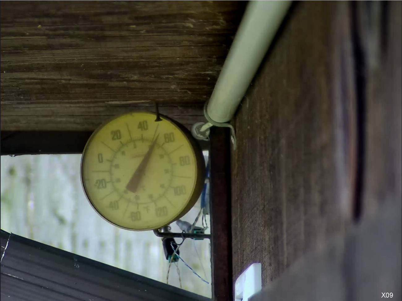

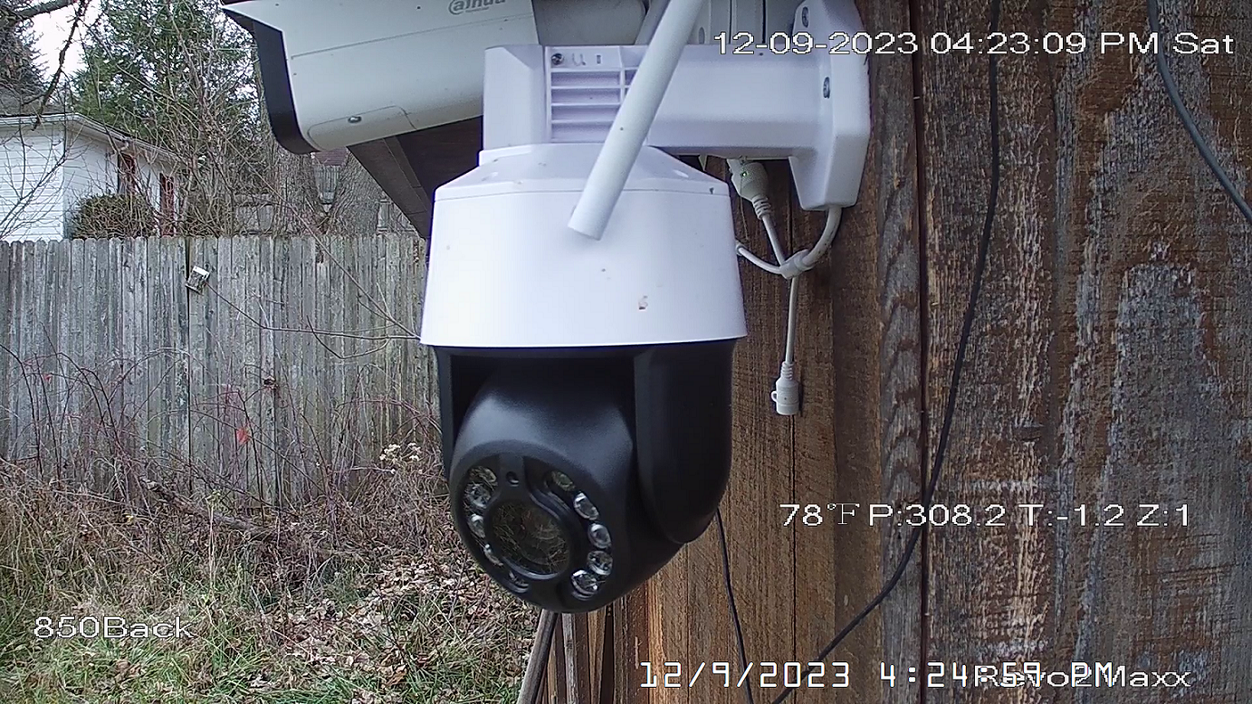

I also have Annke cameras. None of them were POE so can't say about the power port caps. If I had any I would just ship them to you as I personally wouldn't have a need for them. One of my POE cameras you can see. In the first picture you can see one of my Annke PTZ camears and a Dahua Bullet the Annke camera only has cap on the Reset button and power and ethernet is used. In second picture you can't see the cameras but in the picture top right is a Ethernet cable coming from PVC that connects to camera without water boot even. I have some just didn't put it on. Next behind the cable you can see little bit of the white power cable it isn't used but is pointing down. The IP camera is Dahua POE AI. The wires you see there with Power and RG59 screw on connecters are going to a 5mp Annke Camera that has been exposed for a long time and is working without an issue. IN the first picture sure they are under a sofit however on the other side with the dahua and Annke camera is open to driving rain and wind but the Ethernet connection is under the eve so water is less likely to get there.
