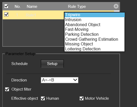

Ok so again sorry don't have that Camera.. I wonder if you can do what mine does.. I will admit before making the adjustment mine would pick up a Cat as a Human..
So for my Camera I have 2 things. I have what is called ROI (Might be for Face Detect only) and I have Max and Min sized Pixel.. That works for sure on the IVS Rules, If yours offers that I would maybe try that option and make the Small one that was normally Set to 0 x 0 on my camera to a size that is little larger and test with Child to make sure it can still alert. Lucky for me my Grand kids where visiting when I setup mine..
So I don't know how your camera is setup or what it is pointing at.. You did mention that it has IVS. Personally I would be working with Line Crossing or Intrusion... The only thing with that is for mine anyway is after setting it up. I still had to tell the camera I wanted it active, then the Link can get a little crazy but once it is understood that when setting up and saved, then saved the screen don't go away right click and then save or apply can't remember but if the last step isn't done it won't keep the changes..
Screenshot (1007).png (20.18 KiB) Viewed 10464 times

Post by kathyoverman »
Thanks for the info.
When I set up IVS Tripwire and/or Intrusion, it detects humans and vehicles flawlessly. Unfortunately, Notification doesn't work with IVS. The only thing the IVS can do is send an email. So I set a filter in the email to forward a text to the mobile phone when it arrived. That worked until last night when there must have been a problem with the carrier and the texts did not arrive until some six hours later.
